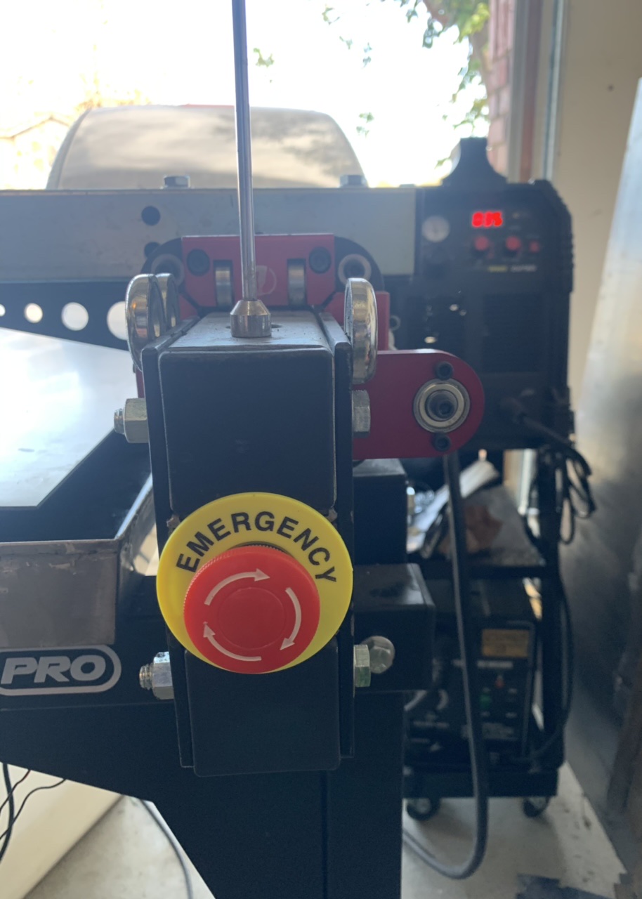

I added a ā€œkill switchā€ button mine that turns off the torch when pressed… I have a magnetic breakaway and it has detached a couple of times with the torch still on… hit the button and it’s off. I’m sure you can Incorporate the wiring into the breakaway instead of using the button to cut the torch off instantly.
The torch on/off wiring inside the control box uses spade connectors so I just ran a loop on one end.
Also works great for changing consumables on the fly and you want to make sure your torch won’t fire.

Now that’s got me thinking, wonder if it would make sense to tie the magnetic breakaway switch wiring into the torch fire wires. That way when the breakaway trips, it will kill the arc-on signal to the plasma, which will obviously show no arc voltage and stop the program, while still allowing the program to start over at the beginning of the last loop.
I more-so want the mag breakaway so if the torch bumps something, it won’t mess up the machine’s coordinates in the cut program.

Thank you very much for sharing Sam. We are new to all of this and I am a failsafe kind of person. Much appreciated !!!
