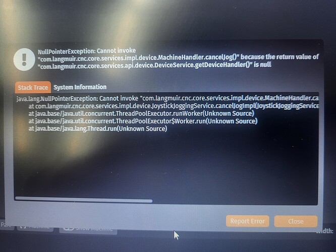

New table. Just got running 2 days ago. I did 3 cuts, and, other than the usual tweeking needed to cut speed, things went well. Today, it is doing weird things. I did one cut, after that it wouldn’t go to work zero, and the just seemed to movie randomly around the table. I’ve attached a pic of an error.
I recommend first trying a fresh FireControl installation. When FireControl is installed, it creates a separate directory for log and user preference files; this directory stays on your device between installations, so any issues that stem from that folder would not be resolved via a conventional reinstall. Try reinstalling FireControl, following this process:
  1. Uninstall FireControl from your computer via the Control Panel.
  2. Delete the .FireControl folder, which is typically located at C:\Users[YOUR USERNAME].FireControl.
  3. Restart your computer.
  4. Reinstall FireControl.
For what it’s worth, I have been getting the same type of air occasionally on mine. Usually happens right after I click on stop if I have to stop a cut mid program then I get that error screen and zero response from the table controller.
