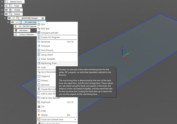

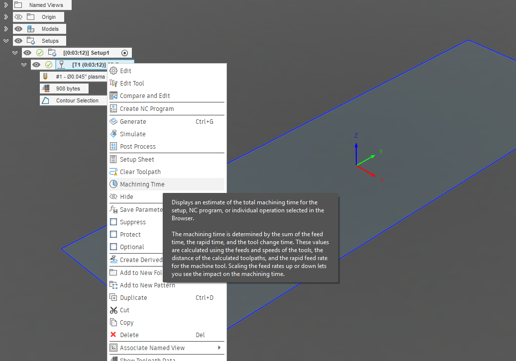

I don’t know about FireControl but in Fusion, if you right click on the tool path, then pick “Machining Time”

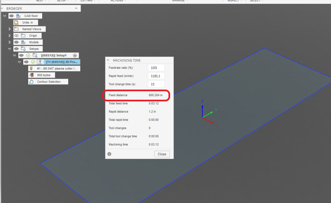

You will get this read out that has feed distance:
I am sure there is something like that in SheetCAM. (The outside of this rectangle is exactly 800 inches.)
