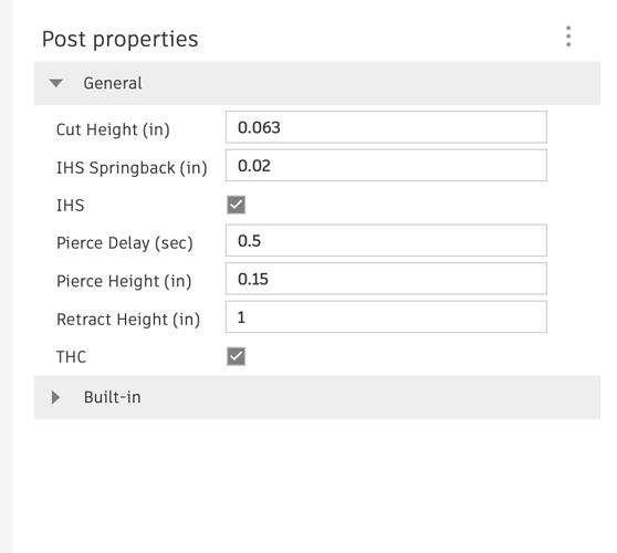

I am having this same error pop up, which has not been an issue before now. I am running a crossfire pro, programming with fusion 360. I just downloaded and am using the latest post available -
Screenshot 2024-06-24 at 1.52.36 PM
I have tried to post with both select and de-selecting IHS and THC
I do see the (PS) line at the end of my code. any ideas? thank you!
(v1.6-af)

H0
(2D Profile3)
G0 X-3.3122 Y0.375
M3
G4 P0.5
G1 X2.4256 F40.
M5
G0 Z1.
(2D Profile4)
G0 X-1.336 Y-4.419
M3
G4 P0.5
G1 X-1.2233 Y-4.46 F40.
G3 Y-0.54 I0. J1.96
G3 Y-4.46 I0. J-1.96
G1 X-1.1105 Y-4.419
M5
G0 Z1.
G0 X-1.336 Y-5.044
M3
G4 P0.5
G1 X-1.2233 Y-5.085 F40.
G1 X0.6293
G3 X2.553 Y-3.5004 I0. J1.96
G1 X2.9034 Y-1.7043
G1 X4.1794 Y4.8348
G3 X3.9733 Y5.085 I-0.2061 J0.0402
G1 X-3.9733
G3 X-4.1833 Y4.875 I0. J-0.21
G1 Y-4.125
G3 X-3.2233 Y-5.085 I0.96 J0.
G1 X-1.2233
G1 X-1.1105 Y-5.044
M5
G0 Z1.
M30
(PS40)
