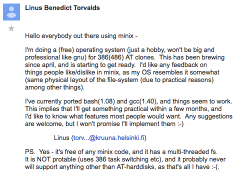

Linux was open-sourced 35 years ago, and the result speaks for itself: billions of deployments, powering much of the internet and all Android devices, supported by a massive developer community. I’m not claiming FireControl/BendControl is Linux — but the open development model clearly works when managed well.
August 25 1991
