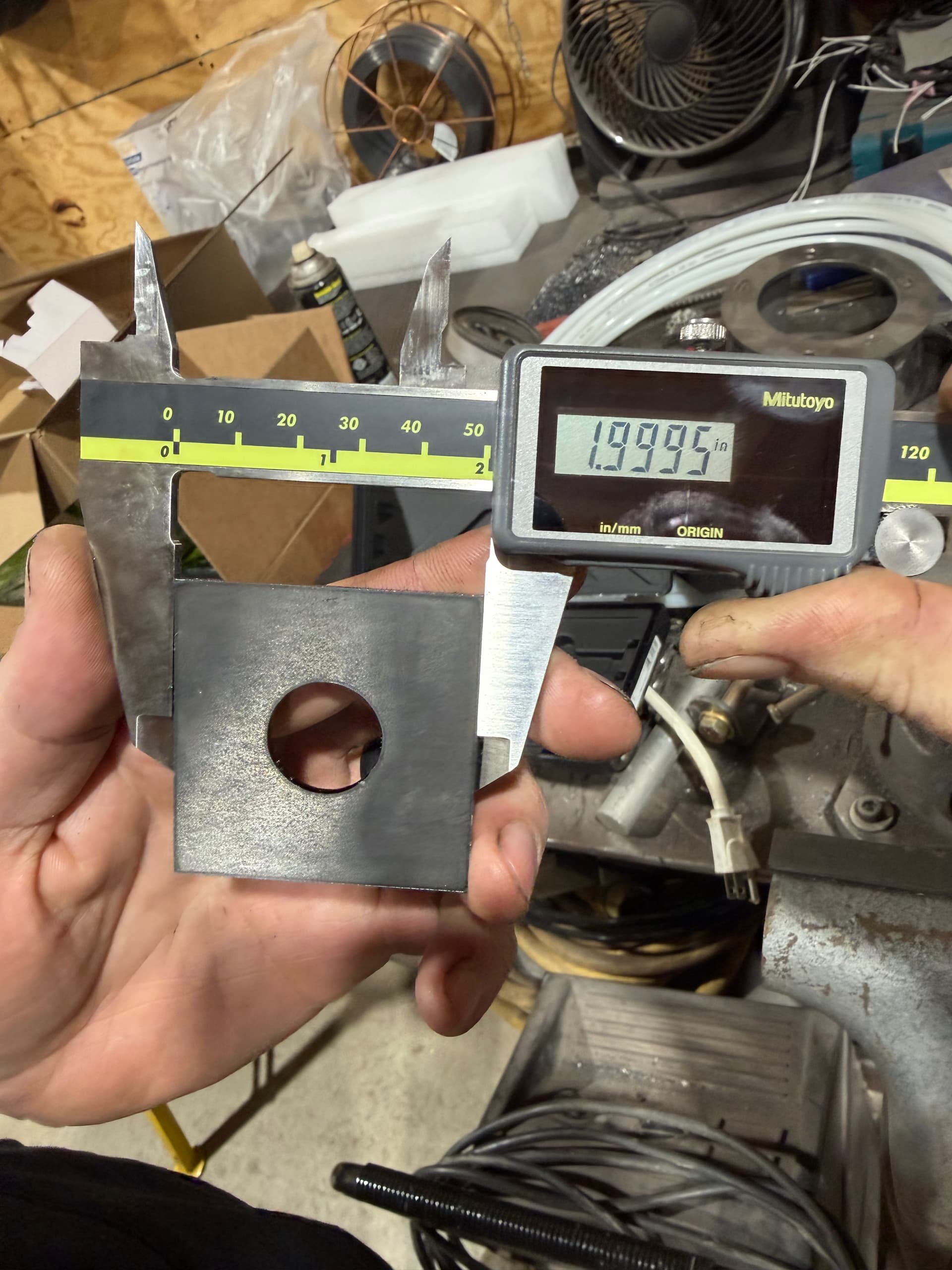

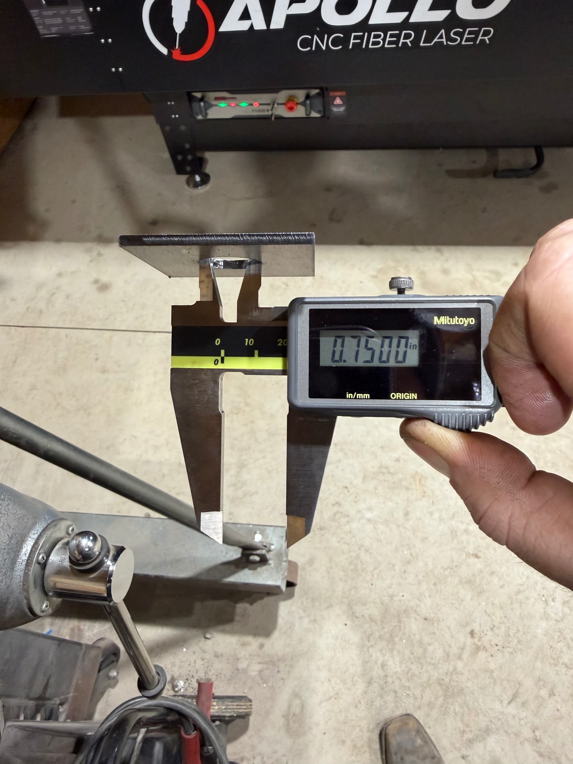

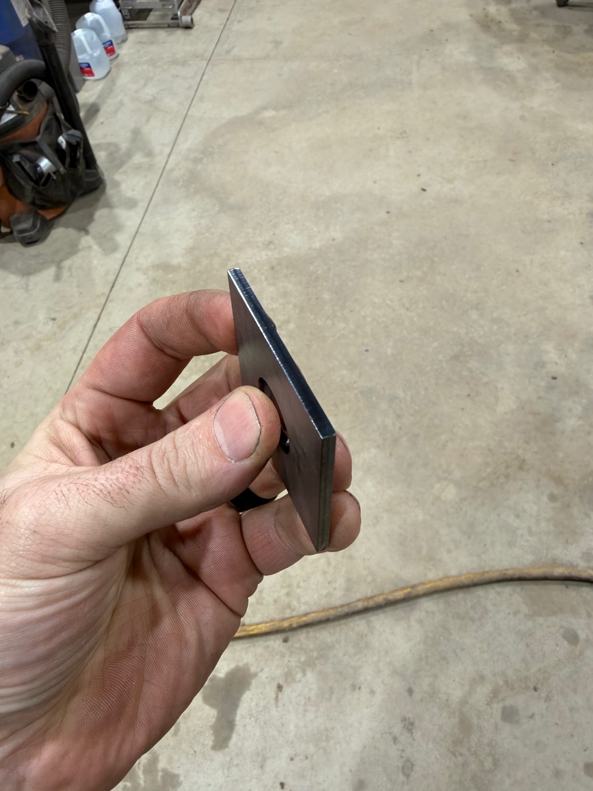

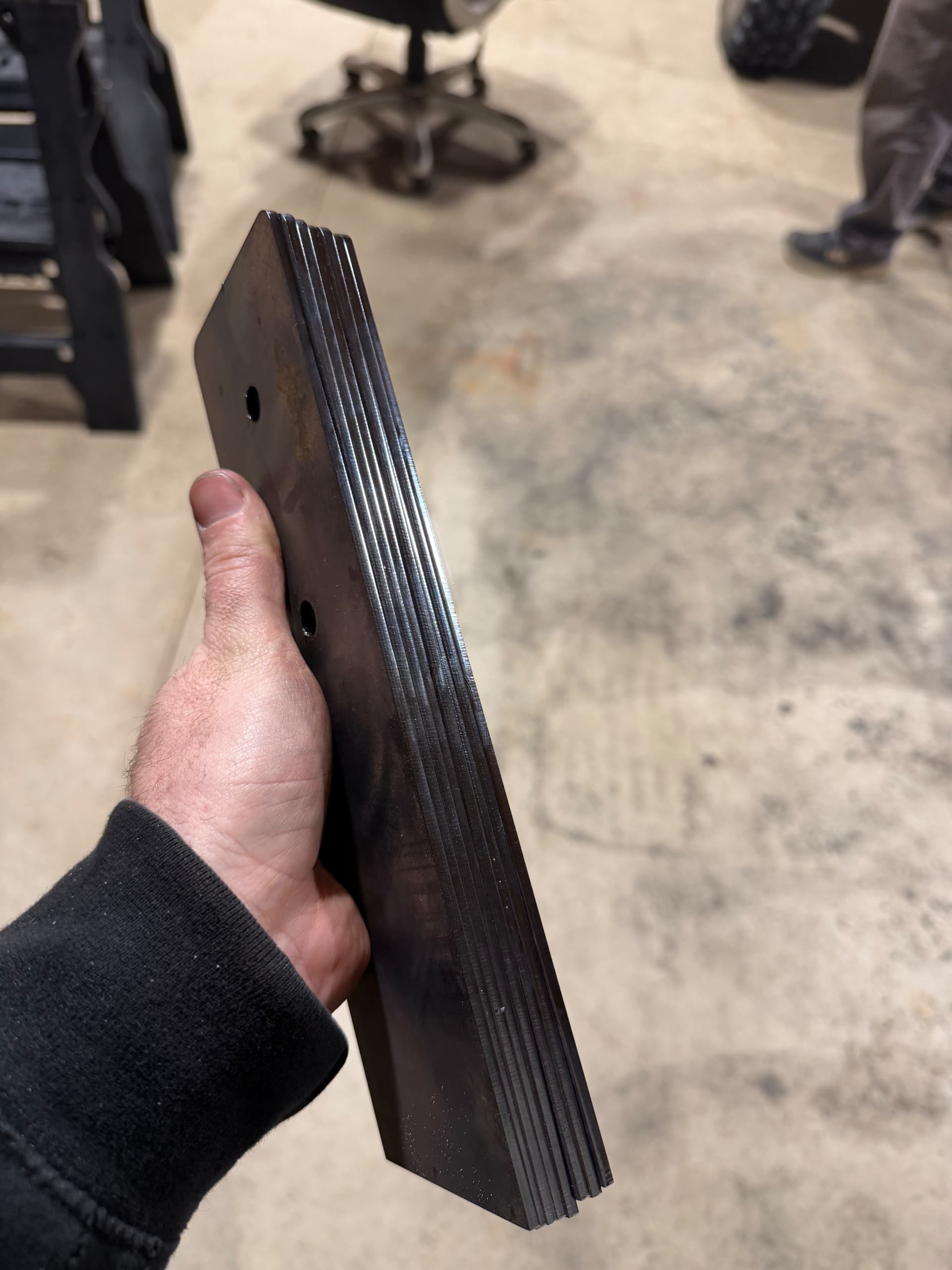

Apollo has landed and am getting some seat time on it! So far everything seems awesome and can withstand heavy use! Super pumped with the accuracy of this thing as well. I drew up a small 2”x2” square with a 3/4” center hole….. I’ll let the pictures do the talking from here :smiling_face_with_sunglasses:
Explain your air supply setup, or are you using Nitrogen? The unit looks great and appears very accurate in cutting.
Currently im running UHP oxygen. I plan on running this because I plan on cutting 1/4” plate with this for a product that I make. Eventually I will get a screw compressor to run for aluminum/stainless air cutting.

That is true to an extent. With O2 on mild steel you get a blue flamed shiney edge with no dross when your machine is dialed in. With compressed air, you’ll get more of a “frosted” flame edge with a slight burr on the bottom side of your cut.

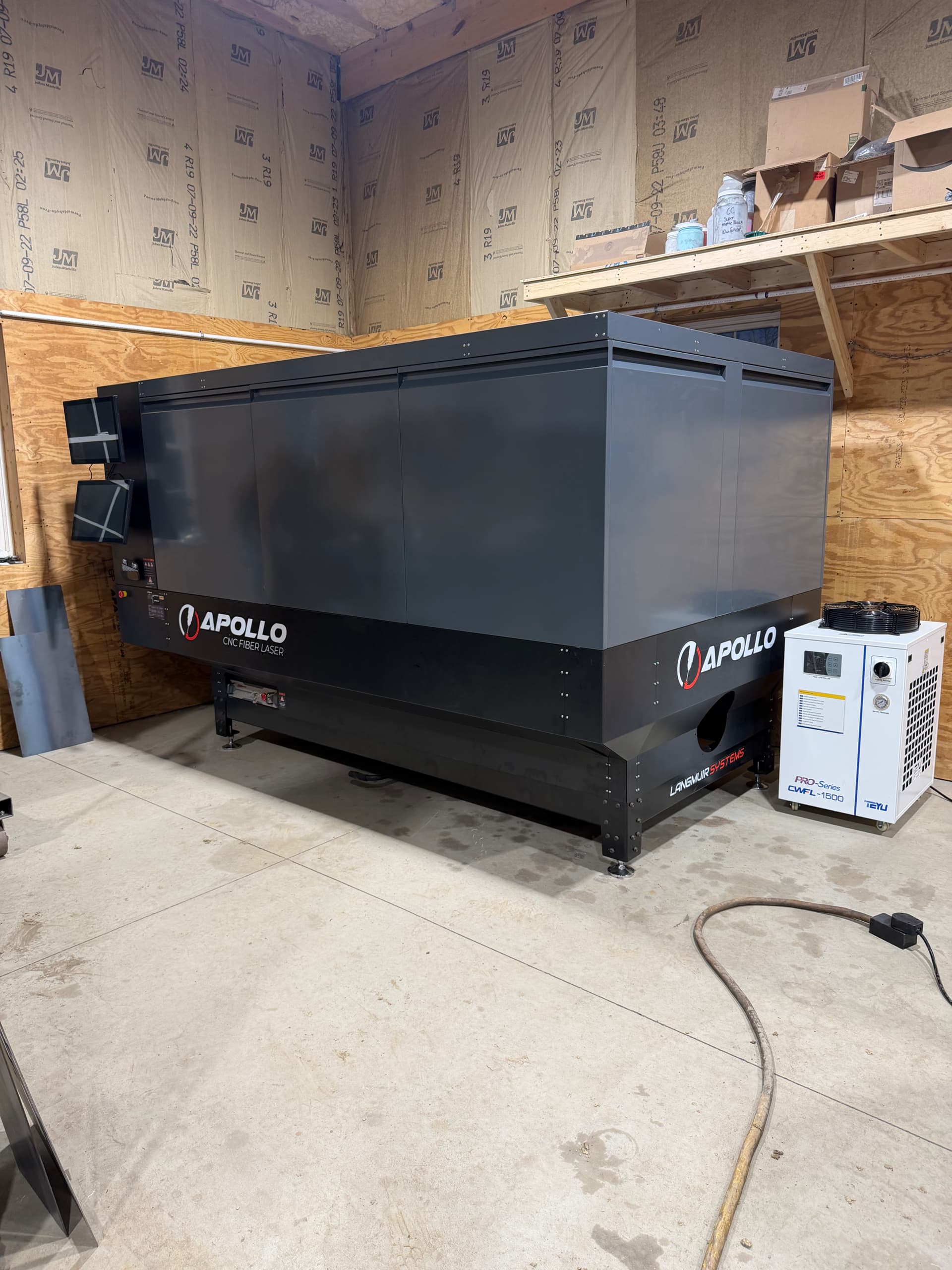

What are your thoughts on the enclosure?
Removing / Storing / Replacing the side panels seemed cumbersome to me… Maybe it is not a big deal….

It’s not bad honestly. Especially when you get it dialed in and have a whole sheet nested, its nice to be able to put the doors on and let it run
