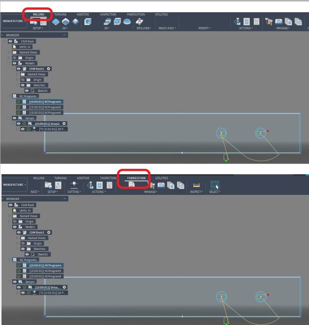

I create a new part in Fusion for the first time in about 6 months. When I tried to cut it I got a no feed defined error. Comparing to older NC the initial feeds were set to 0. I can not figure out what I did different. Does anyone know why that happened. I changed back to what they normally are. I am guessing that will work. I have not tried yet.
It is easier to answer if you share your f3d file.
One reason for that error is when using “feed optimization” there may not be any areas where your cut speed ever gets up to the full speed specified in your “tool.”
Here is the file
Extension.f3d (125.5 KB)
You are in “Milling”. Switch to Fabrication and then create a new set up and tool path.
