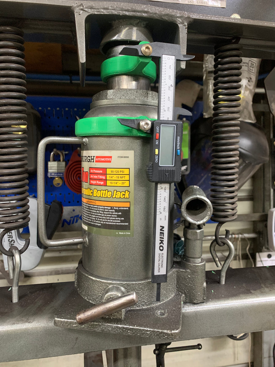

If you have a SWAG brake with an 20t jack and want to make repeatable bend angles, I came up with an easy and accurate fix for that.
