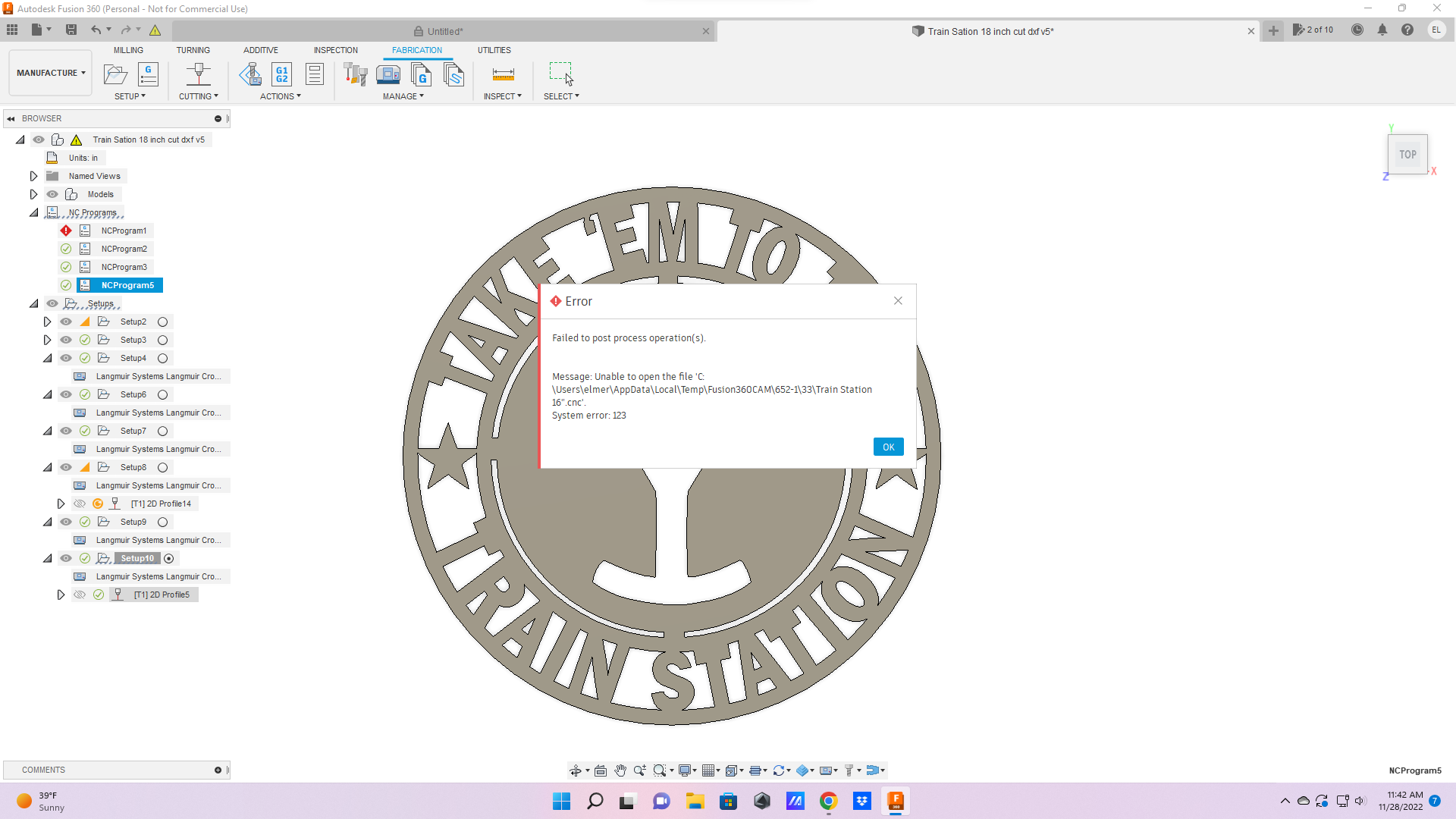

New guy, only been fighting confusion 360 for a year. Anyway, failure to post process, unable to open file C. Anyone have any ideas?
More info. Got malware, had to delete and reload windows 10 plus all programs including Fusion 360 and Post V1.6. That is when all the problems started.

can you copy and paste the error you are getting?

Here is the error message with the new computer and new programs
There is sure a lot of setups and tool paths on the right.
It looks like just the one setup is throwing that error. ( You can see the Red alert symbol on the right highlighting it)
Can you post your f3D?
Can you take a screenshot to where you have your post processor installed. It’s the last menu in Fusion before you produce your g code
I think I have found the problem. In the post page under program name I entered Train Station 16".
I think it does not like the " symbal. Post processor works right now. Oh, well, I ended up with a new
