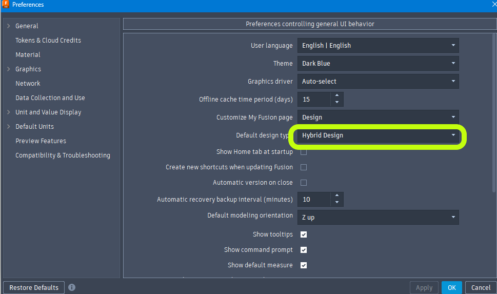

After a little digging, you need to select the “hybrid” or “assembly” designs on the initial startup screen OR go to the browser tree / select “part” and at the right end pops up an edit symbol that when selected allows you to convert the design format to an assembly or hybrid, both of which have the component capabilities previously mentioned.

Yeah, this got me the first time. I don’t know why they don’t default to Hybrid since that was the previous behavior. In any case, you can change your default in Preferences (right click on your account ‘picture’).
