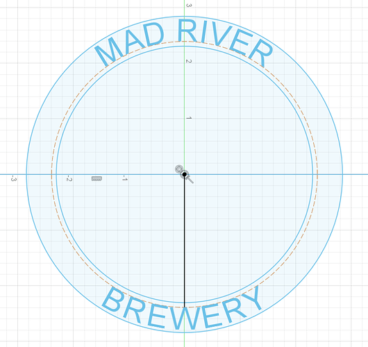

How do I insert text on the lower portion of this sign that will follow the inside of the border? Dont want it to be upside down.
Basically, you need to split the circle into two arc. One arc above, one below. It can still be a circle, but made up of two arcs.
If you don’t want the letters to actually touch the line, turn them into construction lines. The text won’t mind whether it is construction or real lines. Make a real line inside that is not used for the letters.
Ah ok, splitting the circle was the missing part that I was looking for!
