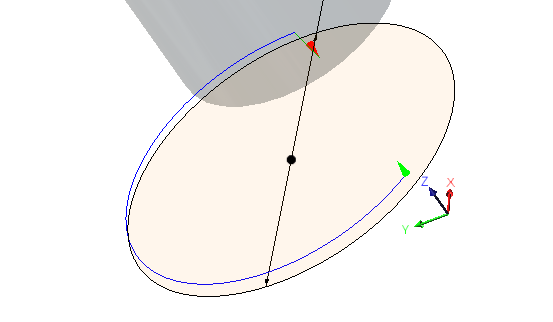

Have any of you run into this issue?
My hole in my bracket (bolt hole) only gets a tool path for 2/3 of it then it moves on to the rest of the part and cut that fine.
I’ve tried 2 parts and even designed two circles to see if it’s a design issue or a software issue. Sure enough, CAM only generates 2/3 of the inner circle path, yet gives me 100% for the outter circle
47%20PM
I’ve also deleted the outer circle from sketch and tried to cut just the inner circle and it does the same thing again
08%20PM
Solution:
After talking it over with the F360 guys, the problem is “Smoothing”. If turned on it creates problems and they are working on a new release for this week.
They also suggested to extrude the part (sheet metal or reg extrusion) as they believe sometime the CAM software has a hard time going off a sketch.
There is something seriously wrong with F360 latest update…
It wants a 0.1" lead in to generate the tool path on a 1" circle (wow). Anything more and it generates 1/2 to 2/3 of the path
Once I get both circles to generate tool path, the torch will not fire on the inner circle (based on the “preview/play mode”) and only fires on the outer circle (tested this on another model and same thing)
One more thing: smoothing will create 2/3 of a tool path as well and ALSO if you select keep nozzle down then it will generate 2/3 of a tool path on the same circle…

After experimenting what I’m finding is that you have to turn off Soothing (absolute) and sometime, regardless of the size, lead-in has to be at 0.1 and anything larger may not generate the path correctly.
Secondly, even with a fully generated path, when you use the play function to check the path, the torch will not fire for the very first cut line, then when it move to the next cut line, it will fire.
Interestingly enough, the M3 comment is in the gcode for that very first cut line that doesn’t fire on the software (haven’t tested on the table).
