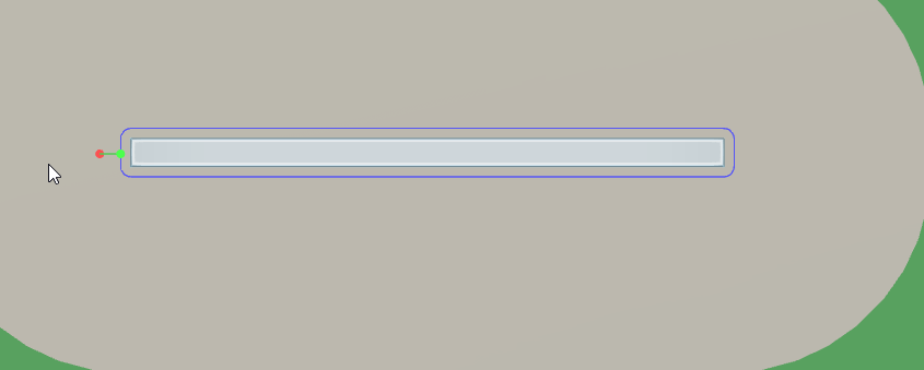

F360 Help Needed: Cutting a small slit in 16ga. How to start cut INSIDE slit vs outside?
Hello, as title said… looking for some guidance please in fusion 360.
So, this is 16ga mild steel. Looking to cut a small 6"x2" plate out. in center of this place i have a small 1.5" x .07" slot. (Should work right? Kerf width is .055.)

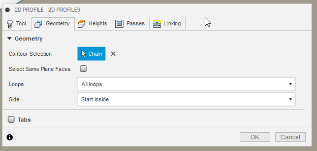

When i go through my cutting profile, i’ve tried many setting variations within the lead-in and lead-out settings trying to get it to START the cut from within the slot. It keeps wanting to start the cut outside the slot which messes up the platet. Any ideas? Thanks in advance!
Ive tried selecting entry positions within ‘linking’ tab. Also tried different loop and side options in ‘geometry’ tab.

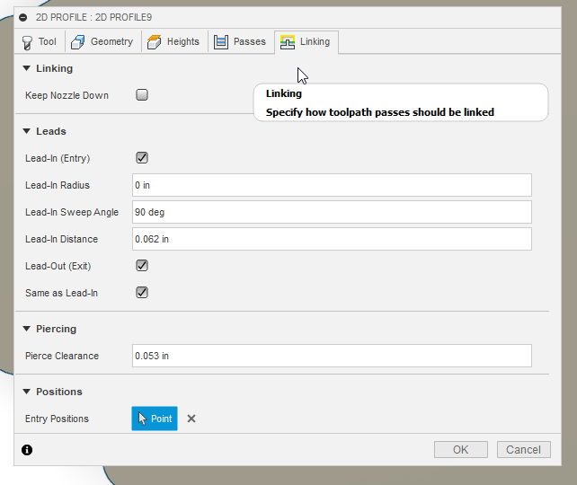

@TinWhisperer – Huge thank you for your in-depth explanation and demonstration! I gave it a go and I wasn’t able to recreate exactly what you were able to do. I tried cutting the part and it cut way more out of the slot than I was hoping. As a result, I resized to 1.5"x .068". Hadn’t cut yet after resize because I was testing out your settings first.
A couple questions.
  1. How did you configure to show your tool path INSIDE the slot? In all my views, I have an outline outside of the slot. Not seeing where this is configurable.
  2. Part of this is likely dependent on question 1. I tried to mimic the settings you had for lead-in, angle and distance, but could not get my start inside the slot; it kept wanting to start outside, similar to my initial example screenshot.

I learned quite a bit from your videos. My file may have been a bit of a tangled web because I had a number of other models/sketches that I deleted before I sent over to you. Looks like there were some remnants left hanging out in the browser bar.
My typical process is sketch → extrude → manufacture → setup → cutter profile
I had selected chain of paths in this case because if I have a small or narrow spot to cut, F360 will skip those tiny holes when I try to select entire body for generating cut path.
Looks like the sketch was lingering which affecting the ability to create the desired cut path on the actual body/model. I did just as you demonstrated with the file I sent to you and like magic, my cut path hit center of the slot just like you described…
I was able to cut the model and forgot i had dropped size to .068 and had to resize to .072 and recut and it was perfect.
