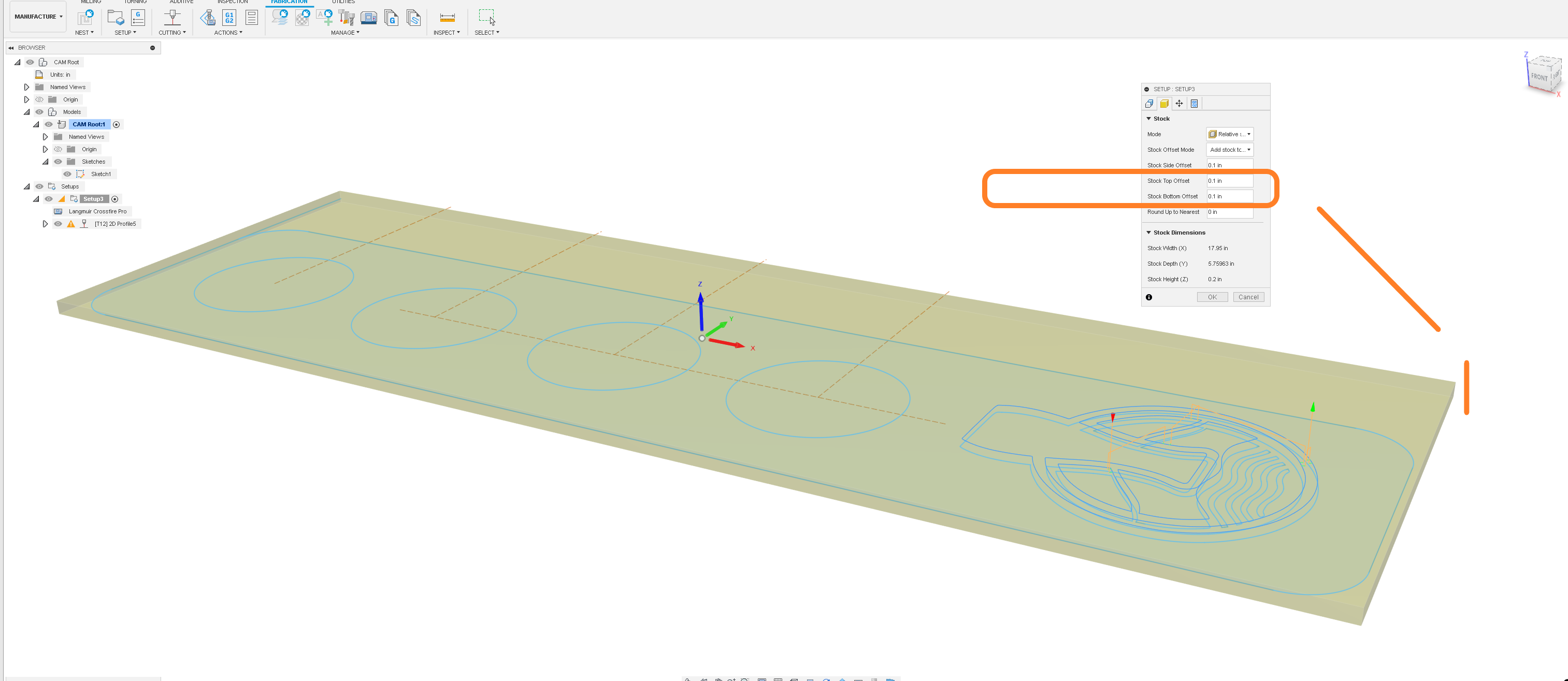

F360 CAM, cut path looks off axis in "manufacture."
Not really a big deal, it just bugs me. It looks like I have a tilted plane or something of the sort. I only draw in 2d, but when looking at my toolpath, it looks like the part has depth to it or its tilted. Without posting the file…any ideas?

But it looks like to me it’s extruded potentially very thickly and your navigation view is set to perspective instead of orthographic. Or pitched at a slight angle.
Try to make sure your orientated to top view in an orthographic view. And double check the thickness of your extrusion.
But this is only a guess from that one picture.
It also looks like several close contours were discarded… Due to Linking constraints…

The “thickness” was create in the setup menu because a .1 offset was applied to the top and bottom of the sketch. you could apply a top offset to a sketch model in the menu to better visualized a cutting simulated but ultimately this “thickness” doesn’t matter for us plasma guys. it only makes it look odd.
instead of centering your stock box point, moving it to a corner makes it easy to set up your material on the table. (work zero)
the odd angle of view is because you are set to perspective. change it to orthographic. (You will need to right click on the navigation cube to access this option)
Perfect! Thank you so much for your help…once again.

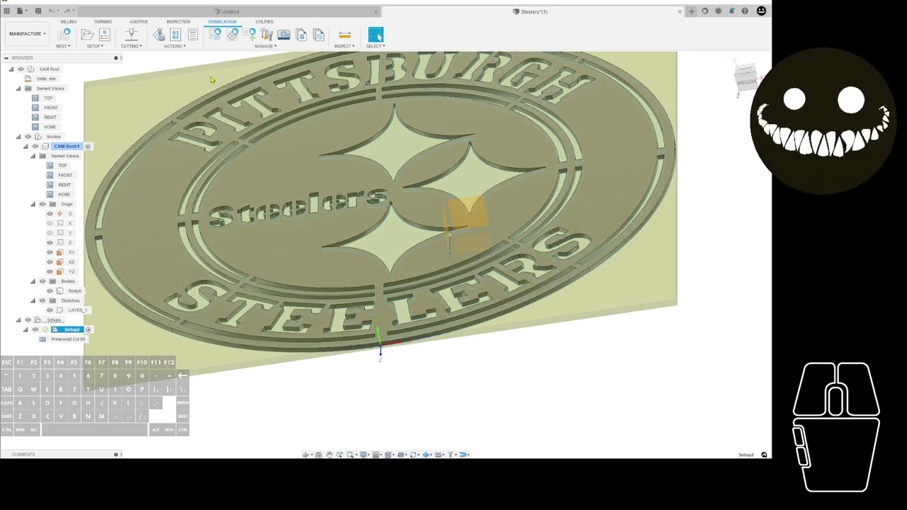

About what? moving your model in the design workspace ? We have only been talking about moving the Stock Point in the Manufacturing workspace.
Using your f3d and working in the design workspace when I edit your sketch I can selected and move it to any position . I am not sure way this is a issues to move for you ? did you selected “edit Sketch” before trying to move it ?
Also there need to be a understanding that Origin of your model in the design workspace and Work Zero (Stock Point ) in Fusion (or Work Zero in FireControl )
ARE TWO DIFFERENT THINGS
watch this video
@TinWhisperer
Thanks again for the help in that video. The sign cut great even though there were some narrow areas in the smaller of the text. Fireshare loves it!
Watched it again here. I had forgotten about the segmenting of the orientation arrows. Haven’t needed to re-align any more sketches, but good info to remember.
Thank you Tin. Never knew how to do that and I don’t even know how I would search for that. Excellent video.
