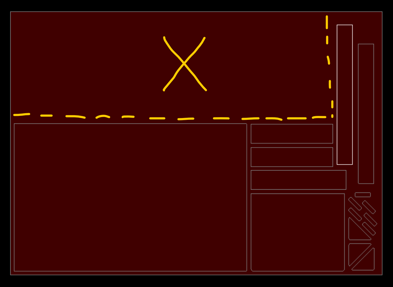

So, I have a 34x48 sheet of 10 gauge I’m cutting, and as you see in the picture below, the yellow
area with the X is excess material.
My question is; Is there a way to mark a line on the project (the yellow dashes) for the plasma cutter to cut so it will cut the excess off from the skeleton so I don’t have to go back and do it manually?
Preferrably, I’d like for it to do it as a final cut when the project finishes so I can take the excess and put it back in to my stock instead of going in and manually cutting it afterwards.

You can do a straight line cut in fire control or make the line in your cad program then do it as a separate layer to cut it last.
I’m guessing there’s no “draw” feature (or whatever it might be called) in SheetCam that would allow me to draw a line on the job/project layout?
I put my torch at the intersection of the 2 cuts, zero the location, then program straight line cuts to each edge. All can be done in Firecontrol.
Sheetcam has a “remnant cutoff” feature, but I don’t think you can specify where it cuts.
I’ve never used it, but I’ve seen other people enable it by mistake and complain about extra cuts that weren’t in their drawing.

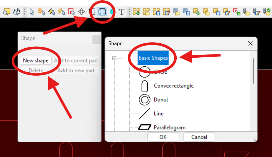

I came across a feature I’ve never seen before and decided to explore it on some spare time.
Looks like I can build a “cut off” in SheetCam by adding a few shapes/lines.
That’s cool to see!

I’ve never used it for that, but the shape library is a quick way to make tabs, base plates, brackets, etc. Just put in the dimensions to create your part. No CAD program needed.
Do you know if you can add parts to the Shape Library?
Kind of like a saved catalog of parts?
I don’t think so. You can save any part you create as a job file, but it won’t be able to be adjusted by changing the parameters.

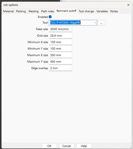

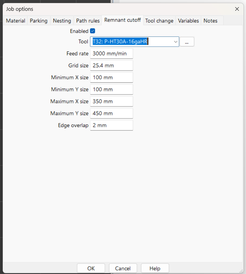

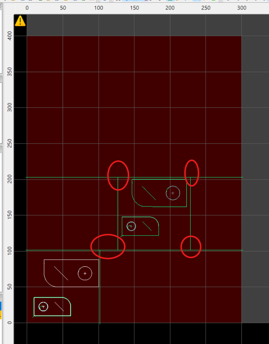

re. Sheetcam menu Options / 'Job options / ‘Remnant cuttoff’, here are the lines it drew for the given following parameters…
This is essentially what I was looking for!
I may have to refine it and see how it goes.
You’ve been a huge help! Thank you!
