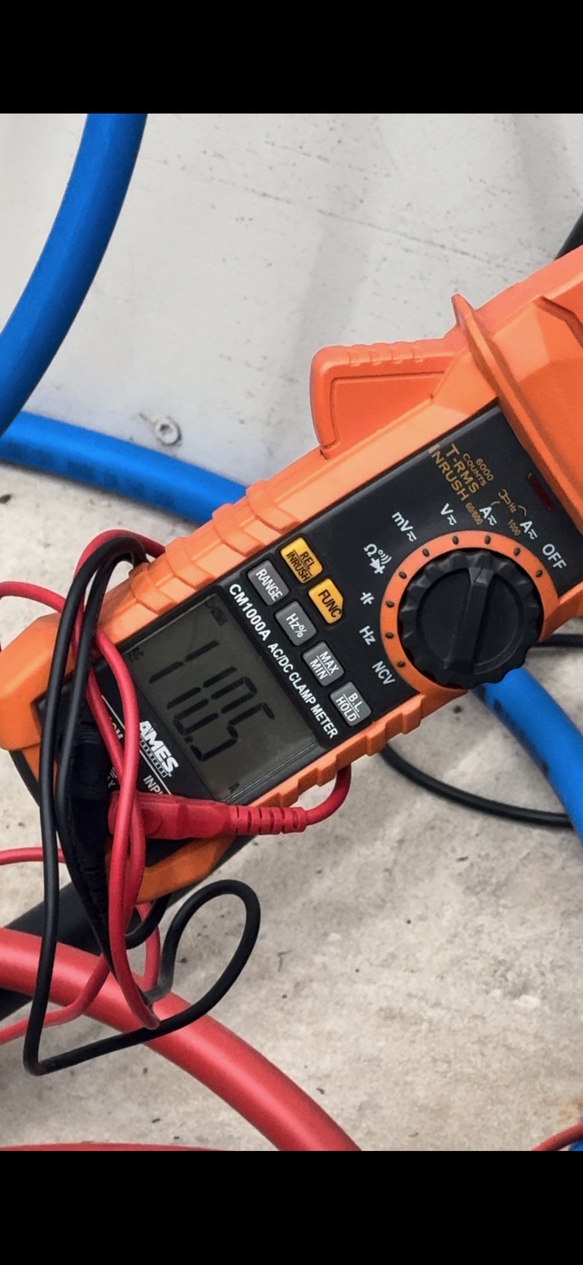

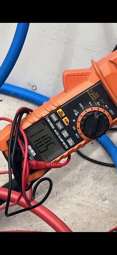

I forget how I got to this thread, but with the conversation about service amperage and such has me chiming in.
Today I was running the 102i with a clamp on amp meter on the input power. The 102i spec sheet says 82 amps max inrush; my meter recorded as high as 112 amps going in the machine. Accuracy spec for the meter is 2.0% + 8D so it seems probable it was pulling 30%+ better than the specs say it can.
What is the voltage? Lower voltage will increase amp draw. You may have a long run from the panel and get a voltage drop under a load. Do the same test again, but measure the voltage and see if it is the same as when the cutter is off.
My 102i pulls 79 amps at 240 volts.
Unless I’m mistaken, Being nominally 36% over on amperage attributable to voltage drop would imply a running voltage of ~154v on the normal 240v circuit… I’m pretty sure the smoke from the wiring’s insulation would be a dead giveaway.
Still, I’m curious and will test it.
You got this. My 102i pulls 79 amps inrush like I said, and it drops to about 55 amps at 100amps DC output. My shop is wired with almost no voltage drop on any of my machines. It could be a plasma problem.
7.4% voltage drop at most when pulling 110 amps from today’s test. There’s over 200’ of wire between the measuring point on the plasma and the service meter.
Peak numbers:
243V resting
224V at 110 amps
That is a lot of voltage drop. How often do you actually use 100 amps?
You could increase the size of the conductors.
Underground or aerial?
200’ you should run 4/0 aluminum for a 100 amp sub panel.
The bare minimum is 2/0 aluminum. I love over kill.
That would give you about a 3% voltage drop
The 2/0 would be around 230 volts @ 100amps
The 4/0 would be. around 236 volts @,100 amps
My point is the plasma shouldn’t be pulling 110 amps from the wall when its max inrush is listed at 82 amps and max rated is 64 amps.
7.5% voltage drop on a 50 amp circuit/60 amp breaker supplying 120% of its design capacity isn’t remarkable. That implies a 3.4% voltage drop at 50 amps.
Obviously I don’t know your situation. Having the utility get you a transformer and give you a service drop.
You may have a plasma cutter problem. If you temp wire it in at the service panel, see what you get.
Dropping 19v will make the amps go up.
It would let you know if it’s the plasma cutter.
I checked mine this morning. 78.5 amps at 100 amps DC output. During the cut if fell to a out 55 amps.
Give Everlast a call tomorrow. Their tech support is on eastern time.
