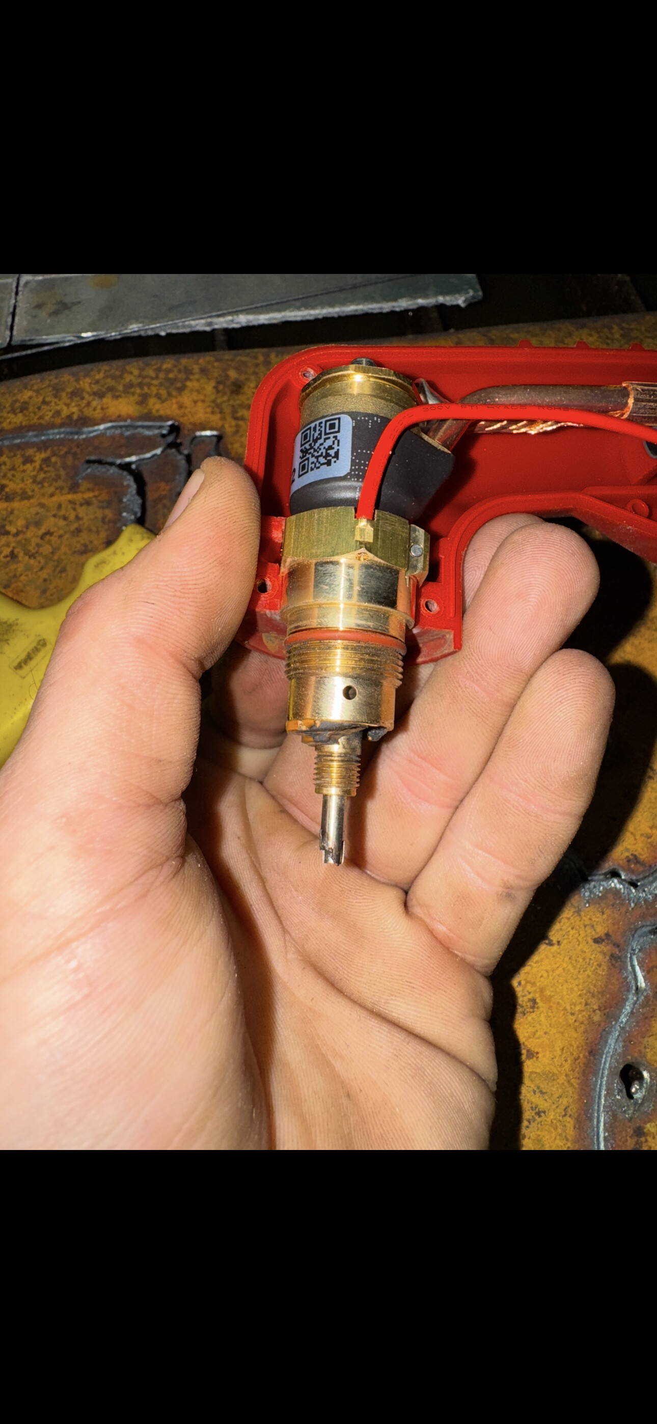

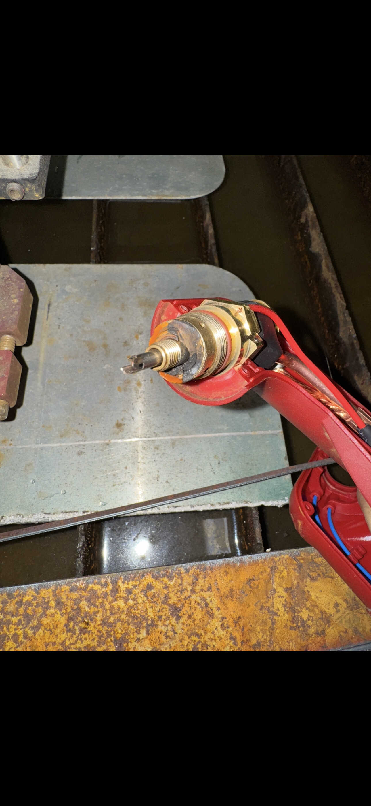

Already sent an email to Everlast but seeing as it’s a weekend, figured I’d drop some pics and questions here and see what you pro’s think. (See photos in replies)
Been running the cutter a lot and did not change the consumables when I should have. Had a bit of a meltdown at the torch head. A few obvious parts need replacing and I was able to reference those in the user manual. However, there’s another plastic or ceramic component that holds the air tube in place that is destroyed and not listed in the manual. Not sure exactly how to remove either without causing more damage.
Is my torch just trash and needs to be replaced or do think this is easily repaired?
The air tube itself is partially melted at the tip and I can not seem to get the remaining portion of melted
piece surrounding it out. It can spin freely about the tube, but I can not seem to get it to come off.
Edit: the melted piece is not simply just the diffuser either, but rather the part that the diffuser rests upon when fastened down with the outside nozzle

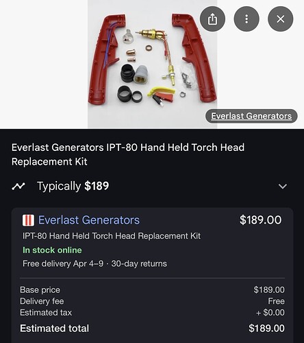

You burnt out a electrode. The torch head it toast and can not be repaired. You will need to replace the torch head, air tube, electrode, swirl ring and cutting tip at best.
Thanks. Looks like I’ll be getting this kit then
I only hit about 30 minutes of torch time for that but I did finish it up with a little freehand because it wasn’t cutting all the way through.
I tend to cut out a lot of very thin ~ 20 gauge mild steel at about 25 amps according to some charts I saw in here. Everlast smallest tip is a 0.9mm for 30-40. Is a meltdown like this seem typical for the task that I have it performing? Would I be better off tweaking my settings to have amps more in line with electrode specs and cut faster or could something else be the root of my problem?
I was only using a 10.5 second post flow which I now see most other folks do a 30 second minimum. Just trying to see how I could learn from this and prevent it in the future

Consider a machine torch for $189. You would be halfway there.
