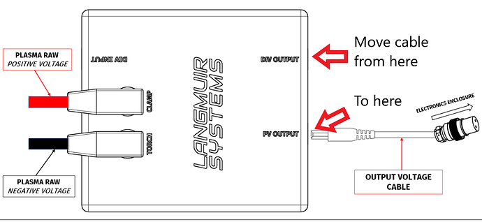

I have seen many debates and opinions on this topic and am about to assemble my new 82i to my new Crossfire table.

If so, then the debate is where to hook up to raw voltage… exterior lugs at bottom of face of unit, or inside the machine. Seems here that “inside the machine” is the popular vote from the very experienced forum users.

If so, would someone be so kind as to send me detailed info. on where to connect and how?
Lastly, I understand that the only thing I should wire to the Everlast CNC port is the two Torch On/Off wires.

Raw voltage from inside the plasma cutter. Torch trigger wires to pins 1 and 2 of the CNC port.
Photos thanks to @toolboy
The red lead to the work clamp lug.
The black lead to the torch lug.
Also special thanks to our power point illustrator
Jimmy. @ChelanJim
Not even a question; raw from the lugs.

Crystal clear! Thank you and thanks for all the pics! Big help… I see so much confusion on this w/Everlast cutter used with Langmuir table.
