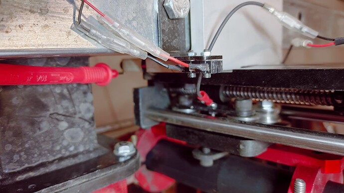

It happens so fast it’s hard to catch. I have been checking things and have a curious thing. On my Z axis the black wire (see pic) connects to a plate between the 2 bolts. I am assuming it’s a ground. The curious thing it appears that the plate is plastic and there is no continuity between the screw and the plate. I have looked on the forums and found a few pictures that show a brass like plate. Why would it be plastic and non conductive? Also when I test the screw back to the plug on the other end ( plug at controller box ) 2 of the pins have have continuity. Not sure if that’s right or not. Have sent this to support to see what they think.
That IHS circuit is a simple open or closed loop. It is normally open until the torch is lifted and closes the contacts to complete the circuit.
If it is working correctly, you can watch the IHS light turn green when you lift up on the torch and then turn off when you let the torch drop.

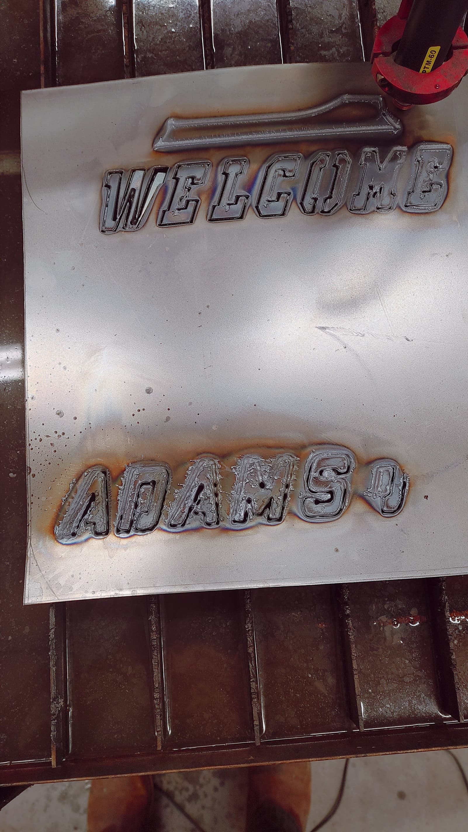

Your right about it being a simple open and closed circuit. The problem is it does not work most of the time. I have found wire problems from the factory. It has ruined a few hundred dollars worth of materials. Every other project I try to cut it will burn up the tips. It will cut fine then rise up about 2" and score the metal and warp it. then go back to cutting and when it gets to the warped part it drags the metal in the direction its going. Last project it went halfway through then plunged the tip to the steel stopped and the new electrode was melted and tip plugged. All the lights showed a okay till it melted down. Put and new tip in new consumables started to run a new project, went along for a while then did the same thing.

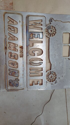

It seems like everyone on here is way smarter than me. Maybe someone can explain why this keeps happening. halfway through this cut the torch goes down and melts the electrode and tip to the metal. This was new tempco consumables at start. I have spent a lot of money because it takes 2 of these most every cut. I have been told that you have to replace them every cut. Seems crazy as my other hand plasma cutting the tips last a long time. This keeps happening over and over. Not every time but most of the time. I have run this by support a couple of times and they just give me some excuse that does not really work. So if one of you has a solution that works I would be glad to hear it. I have been trough all the trouble shooting checked every thing that can be checked. No one seems to want to say that there is something wrong with the machine.
First question. Have you tried to cut without the THC on? If so how did it act?
Seems to be a THC issue. How have you pulled voltage from the plasma?
It seems to cut fine with THC off. I have raw voltage. I keep saying its a THC issue.

What cut and pierce height are you running ? too high = too hot
What are you doing to separate the water from the compressed air?
Re-mount your torch so you are not clamping on the lower plastic. (most people have to flip the red part of the mount) Maybe the blow back is not opening to a wide enough gap because of the clamp.
During these tests keep your air at 85psi also have a gauge that you can verify the 85 psi at the back of the plasma during cutting.

looking at your last picture a few possibilities.
what is your cut settings? material amps ipm.
another possibility if the torch holder is holding in the wrong place and or is too tight. it will restrict the blow back feature from working. looks like you are running on pilot arc only.
another option is shot consumables.
