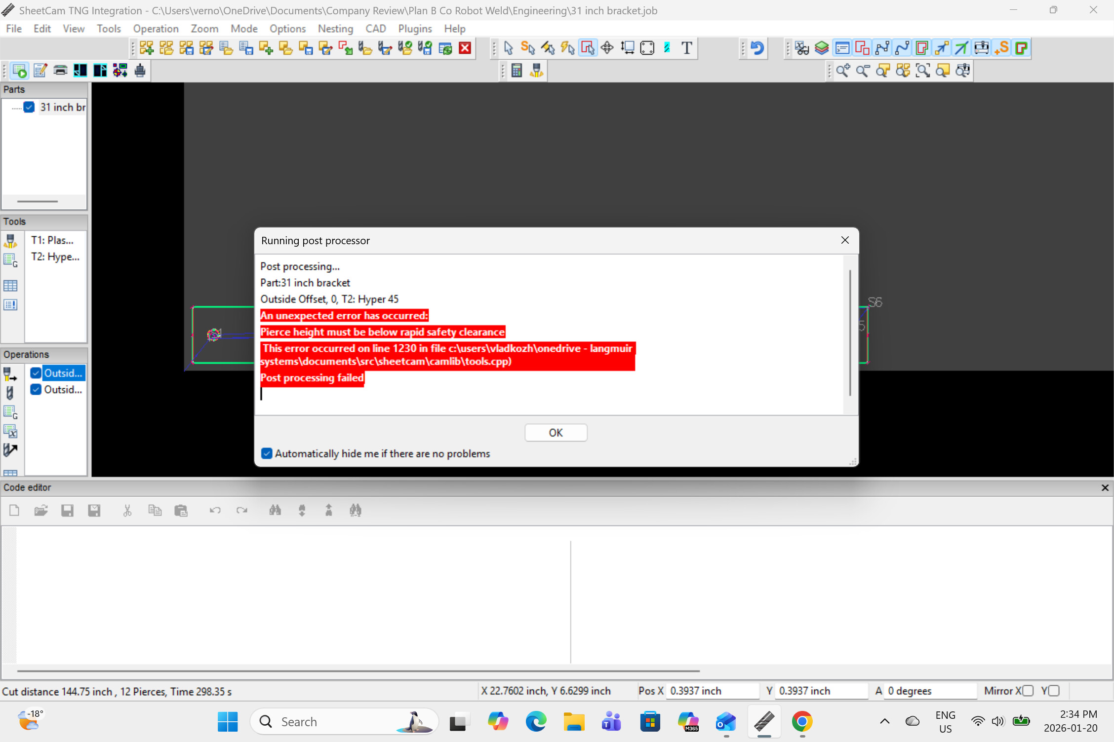

I have received and error is sheetcam that has a pierce height conflict with rapid safety clearance. I cannot seem to find a correction within sheetcam. The part is simple made in fusion exported as dxf from a sketch. The error occurs at line 1280 then fails to product the gcode. Need direction. Thanks Vernon
Post a pic of your tool set settings.
Hi everyone, Zach at LS helped me out. Under Job Options you should see a Rapid clearance, this should be set to ~1.5". Then in your tool, the pierce height will need to be lower than that 1.5", which it should be set at about 0.15".
