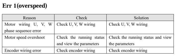

Err 1 on servo controller
I got an error during manual jogging and machine stopped itself. I reset the error and tried homing the ram but realized Left hydraulic ram seems stopped working and only right side was going up.
Decided to open the machine and left servo controller LED display shows “Err 1” on screen. Decided to shutdown the whole machine and turned on again. It seems it resolved the issue and homed successfully.
However anyone knows what is error code “Err 1”?

Huh?
I was actually doing manual jogging in very slow speed.
There were no visible leaks I can see. I did bleeding just in case.
For now, everything seems normal.
Does too much heat might locked the driver somehow? When I opened the cover electronics bay was pretty hot.
