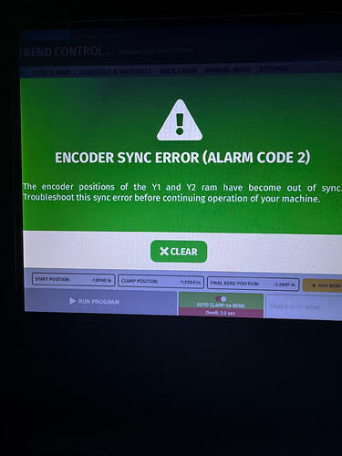

Brand new machine , can’t do the initial home sequence . Receiving the Y1 and Y2 rams sync encoder alarm . Seems the rams don’t move together and the left one is very slow . Also seem the left has air in the hydraulic fluid every time I bleed it but don’t see any leaks . Already rethinking this purchase . Don’t realize for the amount of money it was going to be a dyi machine and not ready to put to work

Just a picture of the error code is not as helpful as a picture of the LIVE REPORT section of the screen. Here is the general list of tests needed to figure out what is going on:

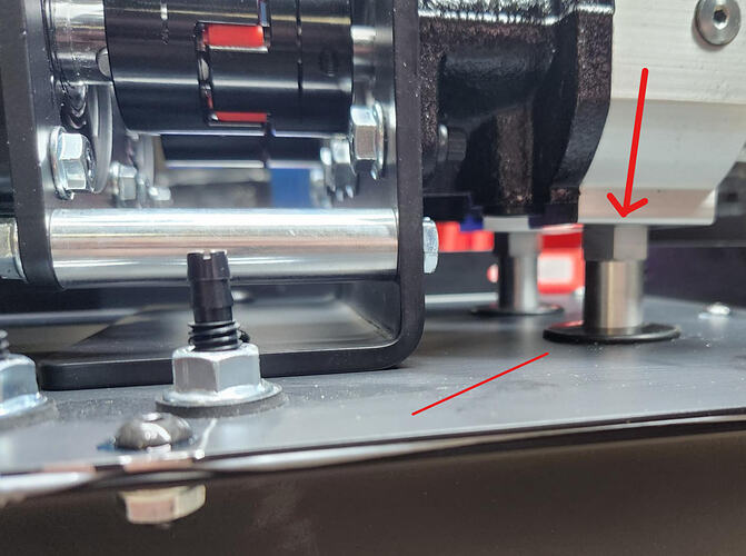

My best initial guess - if you are seeing significant amounts of air every time you bleed, but no obvious leak, then that is likely either:
  1. Your springs on your Pressure Relief Valves are bad and your PRVs need to be replaced.
  2. The pipe underneath your pump needs to be tightened.
Either way - message me at support@langmuir systems if replacement parts are needed and I can get them to you quickly. Or just message me with your findings and I can help figure out the solution if something else is going on.

Thays great news , just hard to believe considering the first thing I tired was the home process and received the same error which then lead to me trying to bleed the cylinders . No matter how much you bleed the left cylinder and watch the oil circulate till no more bubbles once it moves and stops again with the error you can bleed it again and it’s full of air once more ( plenty air ) over and over again. Only thing I can think of is the suction piping on the bottom of the pump needs to be tightened . Seems everytine it runs it sucks in air .
Yes that does seem like a loose connection on the inlet. Maybe it vibrated loose during shipping? Hopefully tightening that down will fix that. Otherwise, let me know what else you find with those tests. If you can find where the air is getting sucked in, if tightening it down does not fix it, I can send you a replacement part.
