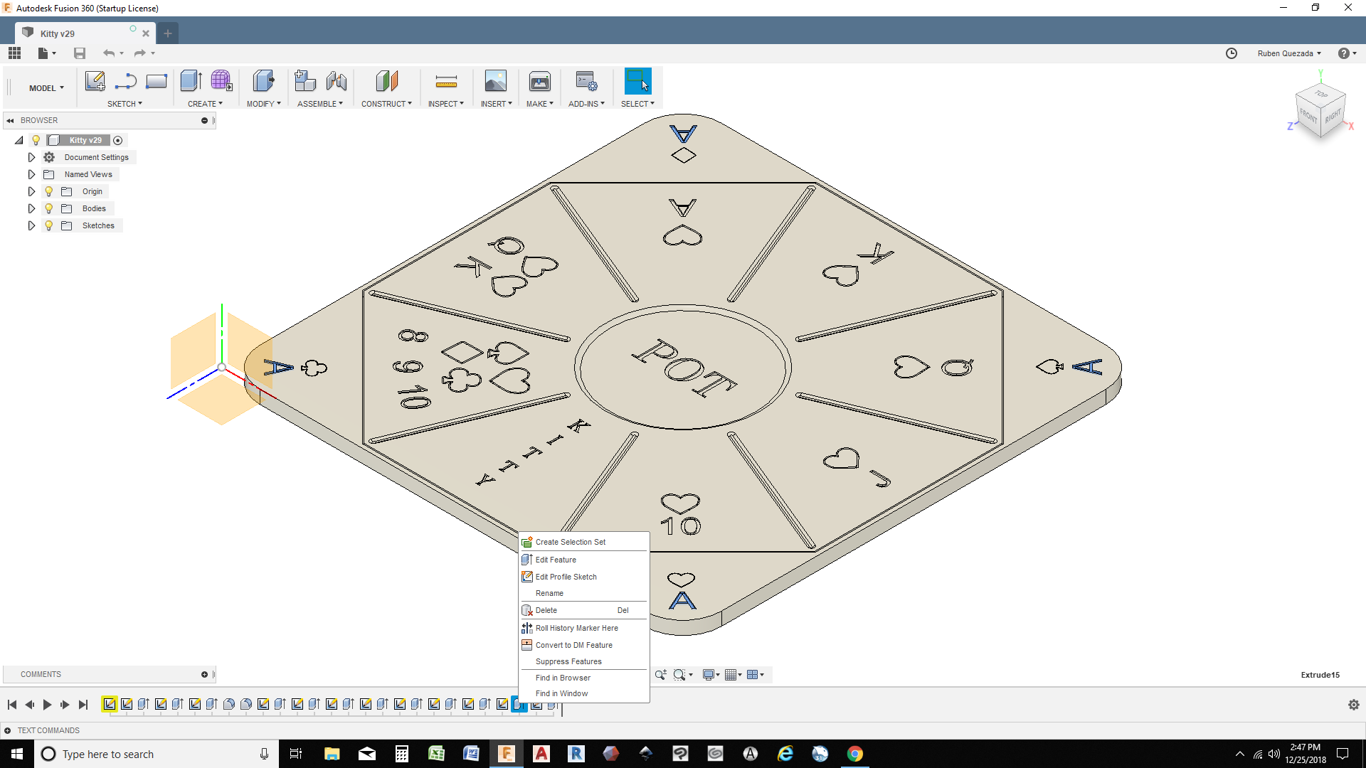

I do it from the history bar on the bottom left of the screen. You can edit any action previously made to the model. On the picture below I’m highlighting the extrude I made on the four A’s that are on the corners.
