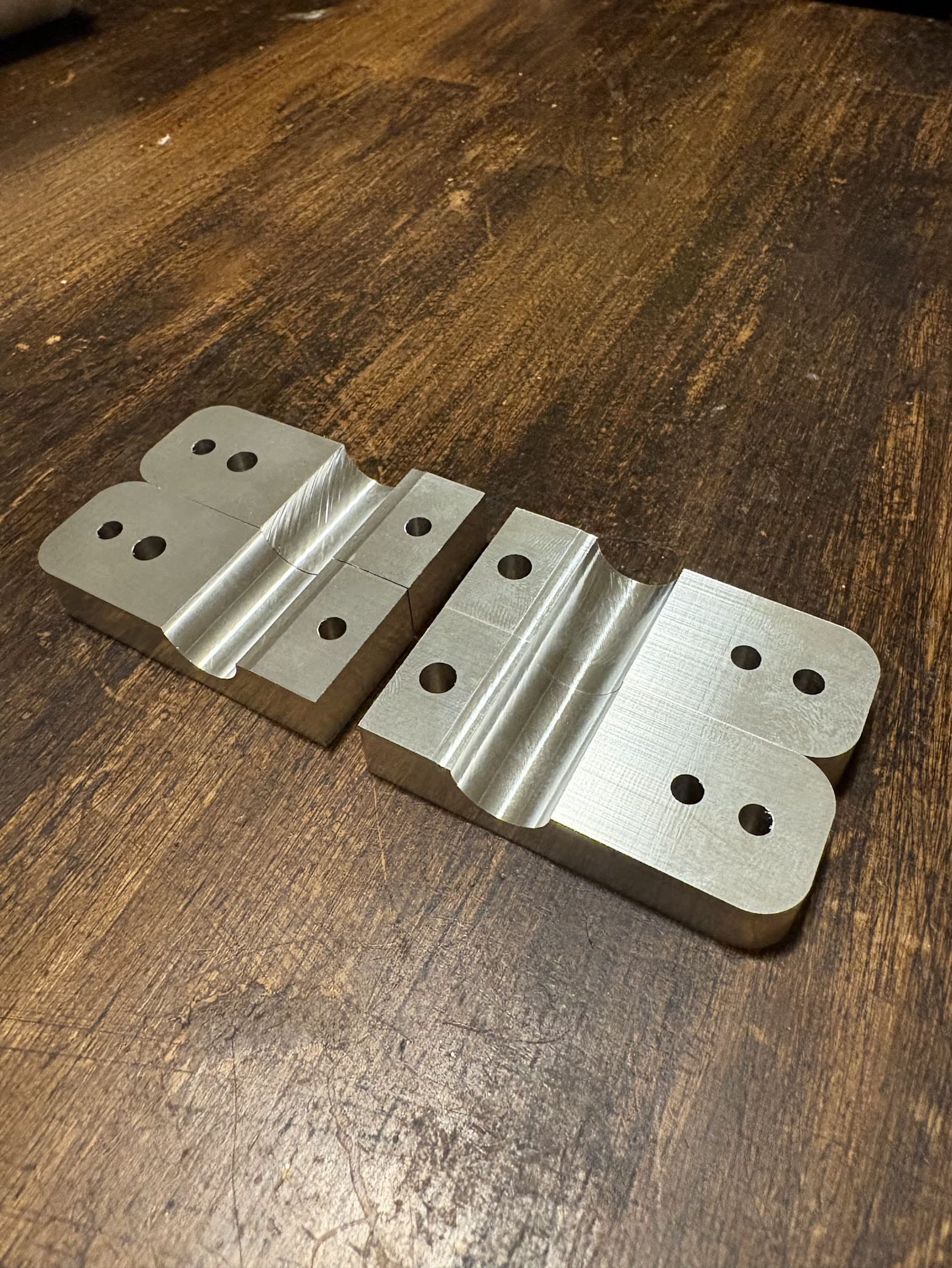

Ignore the chatter on the top left part, I was going WAY to fast. Top surface is actually angled ~5 deg and was stood up on its side so is technically an edge. 1/2” 4 flute 35 IPM 0.003” clean up. I’ve found surface quality seems to be pretty good up to 35-40 IPM with a <0.005” clean up pass.
