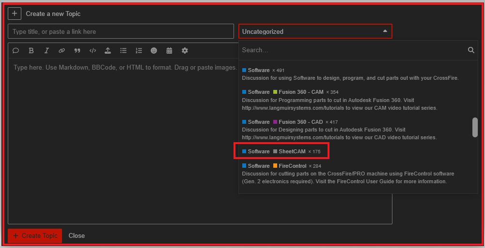

BrownFox has other duties he is attending at this time. I am not so sure he plans to stop by anymore. If you would like to restart this conversation, you might start a new topic and possibly pick the category “SheetCAM” under “Software”.
@Knick I wonder if BrownFox removed that content when he stopped using the logo/icon.
Thank you. I am just very perplexed. I can’t get anything in to sheet cam and then into fire control.
If you create a topic in the SheetCAM category, you will get attention. The company monitors that category and there are other members that have really good insight into using SheetCAM.
