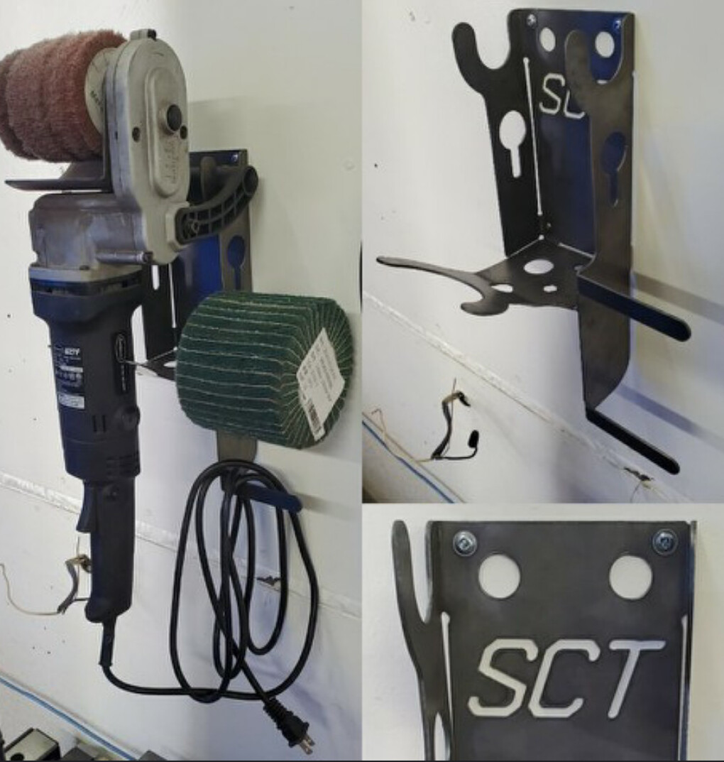

I did draw up and bend a hanger for my SCT earlier this year.
Since I have made this one I did alter the drawing a little bit I haven’t cut a version two yet.
