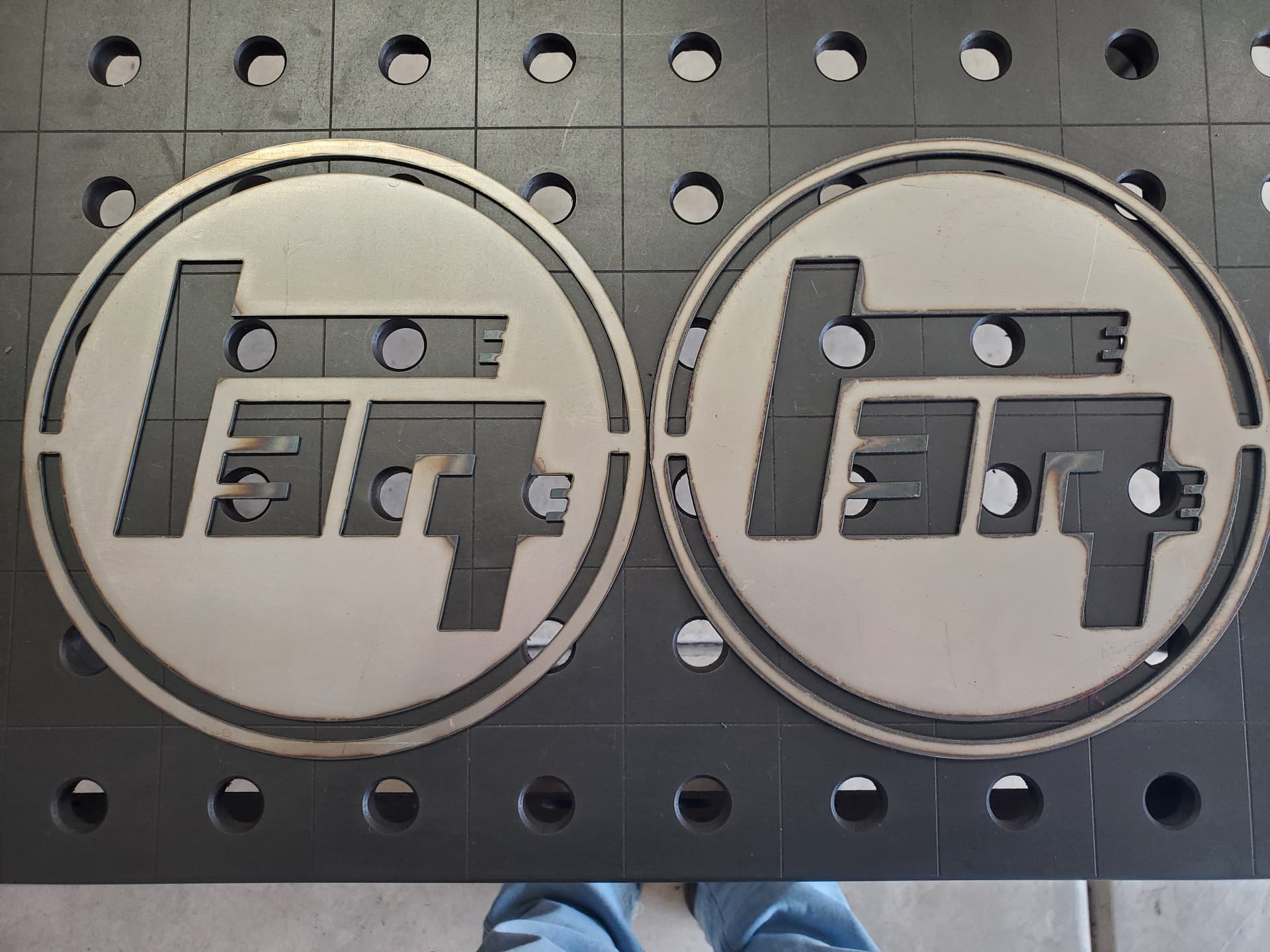

Here is an example of cutting the same exact sign, using book settings, with different consumable types.
You can see the difference in heat input, which if I flipped them over, would show you a difference in dross.
Unless there’s quite a lot of details being cut close together, I can get away with practically no dross at all on 16 gauge.

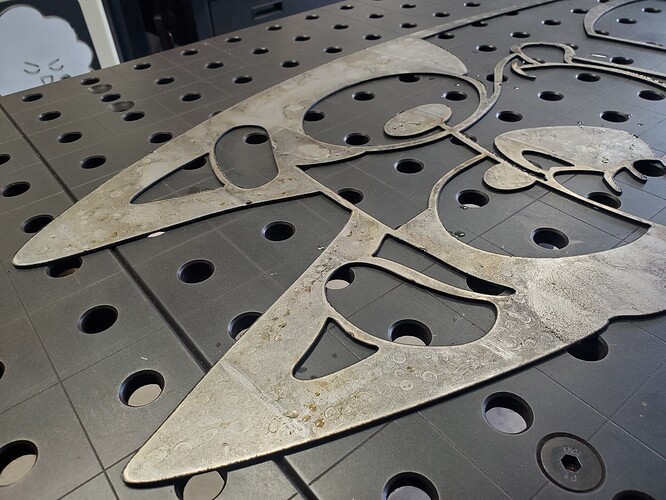

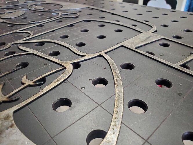

Here’s the “worst” dross I got on 16 gauge when I cut this for our son’s room.
