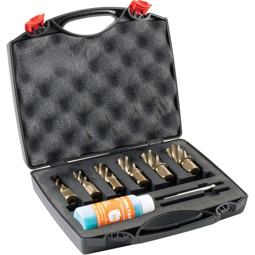

If you have a mag drill a annular cutter is a great option for plate too.
https://www.tenaquip.com/product/walter-surface-technologies-sst-core-cut-annular-cutter-kit-05a991-uau602?gclid=Cj0KCQiA5aWOBhDMARIsAIXLlkdomtlbAilAe9dU0oeIwLrwIXwgtJuYsRivAnobIErWUM02hFSYzrwaAk3JEALw_wcB

I have looked at the annular cutters And in my research I did conclude that my drill press was in adequate, has the wrong chuck, and I would need a mag drill.
Is the mag drill worth my money?

The ones I linked you are good up to 1/2" steel. They are for cutting through vehicle frames.
I’d vote for a mag drill with annular cutters. I’ve been watching the used market around Colorado Springs, but they don’t show up often.

I have used annular cutters in a drillpress, just need an adapter

I think I have made up my mind on the mag drill and annular cutters. Doing some more research on the inter webs and it seems like that is a preferred setup for a lot of people especially when you have a large project that is difficult or impossible to put on the drill press.
the best thing about a mag drill is its portable.
