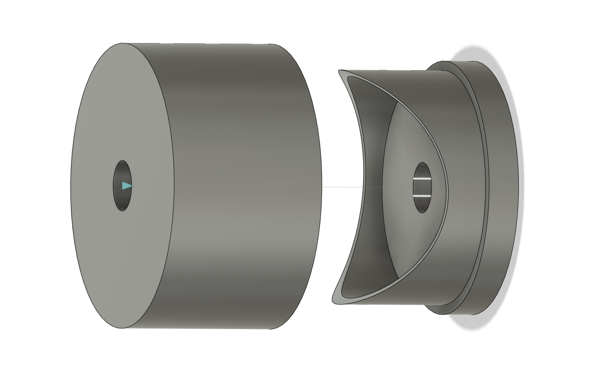

So, you need a punch and die for a 74 mm hole in 2 mm thick galvanized steel. I have used smaller punch and die’s but never anything that big. Do you have a lathe and a mill?
Mun, I’m thinking something like this. Is this what you have in mind?
74 mm Punch and Die v1.f3d (93.6 KB)

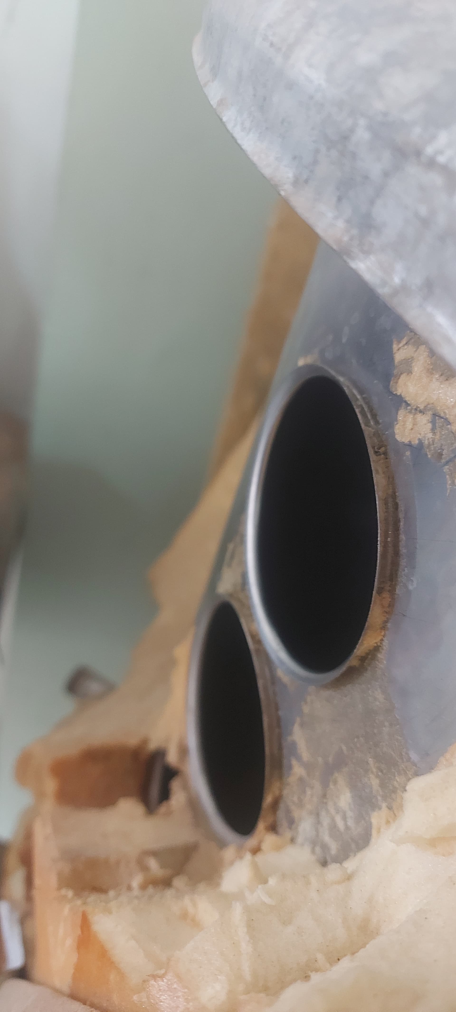

I want a cutting template to be installed on a mechanical press of approximately 16 tons to produce the initial and final hole in one stroke with a diameter of 63 mm and a metal thickness of 2 mm so that the glass tubes for the solar heater can then be assembled using silicone seal ring d 58 and D 74
I’m not following you on the dimensions, where does the 74 mm come into play?
The dimension 74 mm is outer for standard silicone seal ring
I need Diameter 63 mm put i dont know pre hole extension to become like this picture
