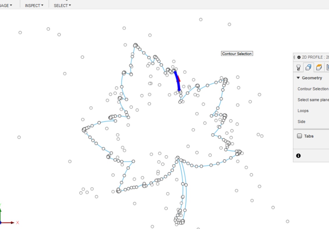

Attached is a pic of the problem… I realize this drawing is troublesome, but a lot of the free art out there comes in like this… not one continuous line.
i know Im not the only one… how are other people dealing with this issue?!
Your screen capture doesn’t show up in the posting and, for me, isn’t very useful. The original source file would be most useful in diagnosing the problem.
Here you are. What do you make of it?

(fixed the pic)

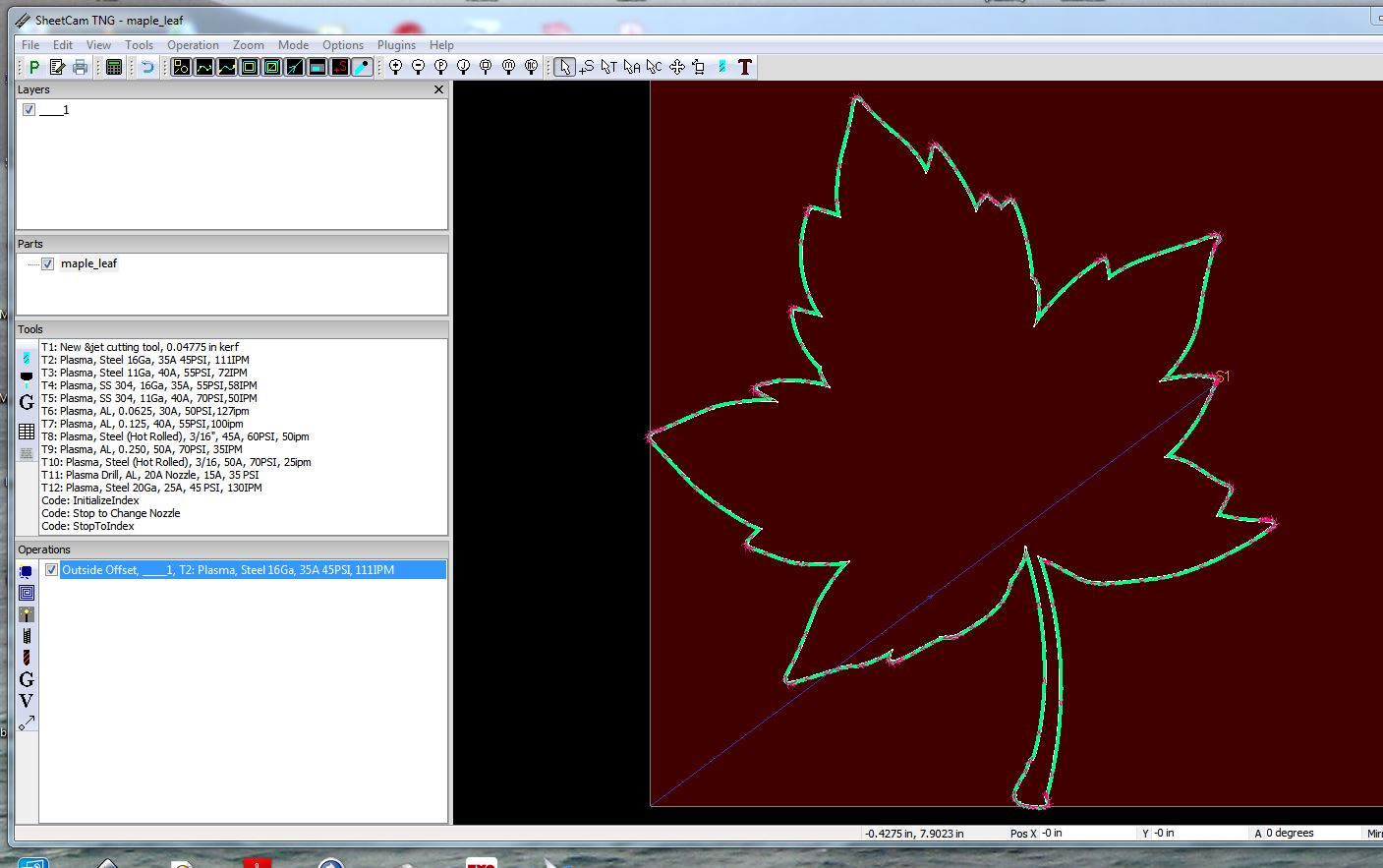

It’s ready to cut according to Sheetcam…
I didn’t do anything but import it into Sheetcam with Metric scaling. SheetCam was perfectly happy with it.

Yes, I downloaded your file, opened sheetcam, imported the drawing, made a cut operation and could have produced a G-Code file with the push of a button. It took less than three minutes… maybe less than two. It would have been faster but I mistakenly imported in Inch scale first and that made for a mighty big Maple Leaf!

inkscape is better at handling the artsy stuff you download from the internet than fusion. and its free. Alot of the stuff you download is full of nodes and broken lines that makes fusion bog down because it can’t handle it.
fusion is better for creating your own drawings/files.
Too many nodes. If you’re using Inkscape, CTRL-L will simplify that
