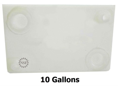

It looks like you’re using a similar tank. Where did you get it?
What pressure do you use to refill the table?
Just look on ebay for RV fresh water tanks.
What do you mean that its self cleaning, are you talking about the sediment just settling to the bottom?

I got it off Amazon it a 10 gallon RV water tank, it’s not classified as a pressure vessel so I don’t run more than 1-2 lbs air in it, I watch the sides flex as I fill it to stay safe, I’ve got a ball valve on the top left and right one with an air line fitting, I close the left one and slowly open the right one and watch the table fill, then shut it off, when I drain it I just open the left and or right valve(s) and let drain by it’s self.

Here you go, 1st one is the tank view.

If I did it again, I wouldn’t use the left ball valve I’d just plug it knowing now it drains fast enough with just the right one and the ball valve under the drain pan you wouldn’t need that either, just closing off the drain ball valves in the tank work good enough for preventing the fluid from returning to the tank.
