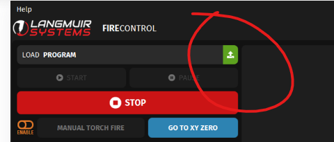

This is button to go find file on your computer in firecontrol
Hopefully this helps. Welcome to forum and good luck cutting!
