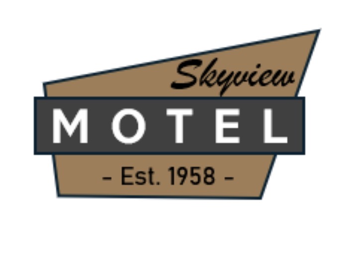

I’m relatively new to CNC cutting and have been approached to replicate a vintage motel sign on a smaller scale. The task isn’t what I’d envisioned, you know, simple cuts through metal with lettering changed to keep all the part intact. The job looks like a combination of cutting, welding, powder coating and who knows what.

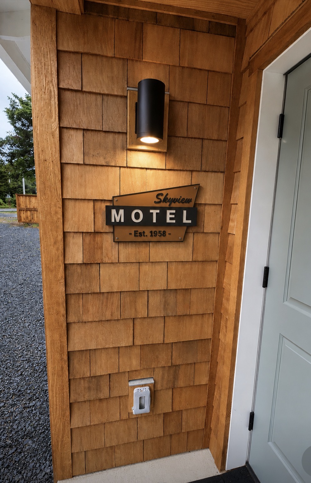

Best to look at the images attached. Image 1 is the client’s artwork.

How big is it? Is it the one in the last pic?

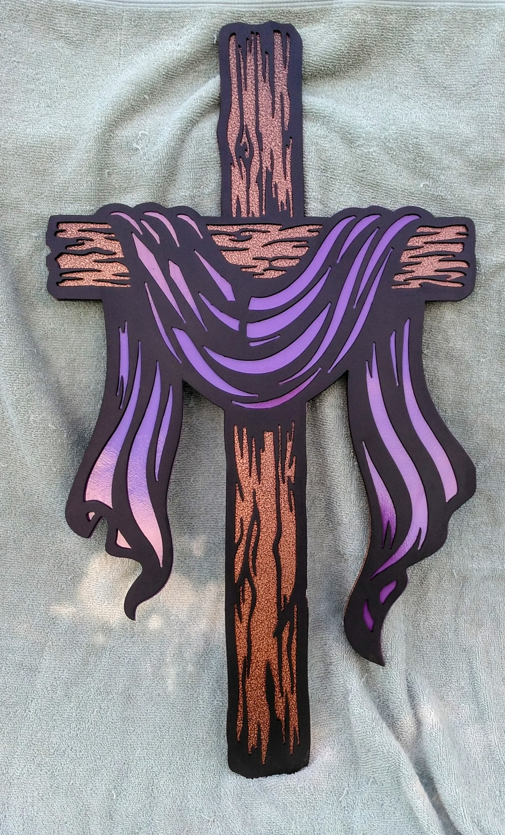

@gotsowell we would love to see you attempt this project. Layered pieces can be intimidating at first. Just take it one layer at a time​:grin:.
Here is a 3 layer I recently finished.
