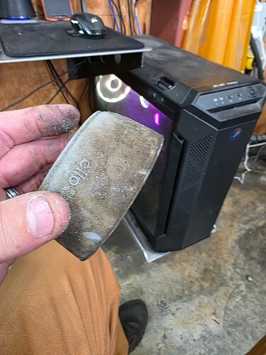

I use one every day. It’s great not to have the sparks and arc that blind me. It pulls right off to change the consumables. Just my two cents.
It has never affected my cuts or IHS.
How do you have this set up? I have a few in my toolbox that I was contemplating adding (not till i get my other issues sorted out). What did you use to cut out the torch provision? I’ve been using some angle iron around the table edges, but the crash likelihood worries me about continuing to do so.
Fits over the torch barrel. This one is years old.
It was the silicone bottom to one of the mrs coffee mugs. She is still hunting it.:grin:
