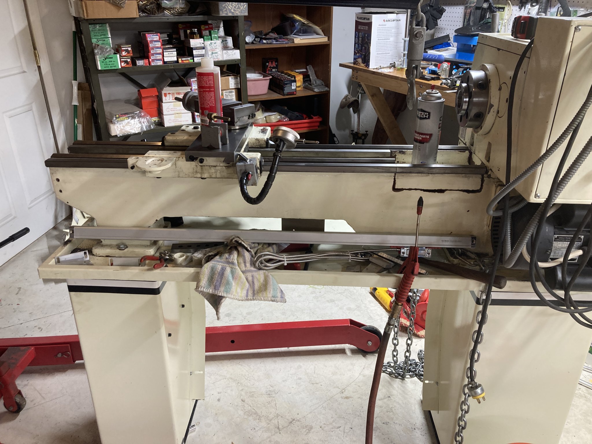

Here is the backside of the “new to me” lathe that is currently blocking the damn door.
(I have about 396,712 projects going on right now, all at the same time, and the shop/s are a friggin disaster area…and this is probably the least important job/project, but sometimes you just gotta “scratch that itch”)
So after “mocking it up” with clamps, and mounting a dial indicator on the carriage to check for “level’ness”
I drill it for 8-32 cap screws to attach it with.
After drilling, and upon further review…
Its a little too close to the end for my liking, but I figure its a pretty “light duty” job to hold that encoder(?) in place, and my only other option is to try and get ahold of Xi Wang Phuy in China, then ship it back, then wait…blah blah blah…

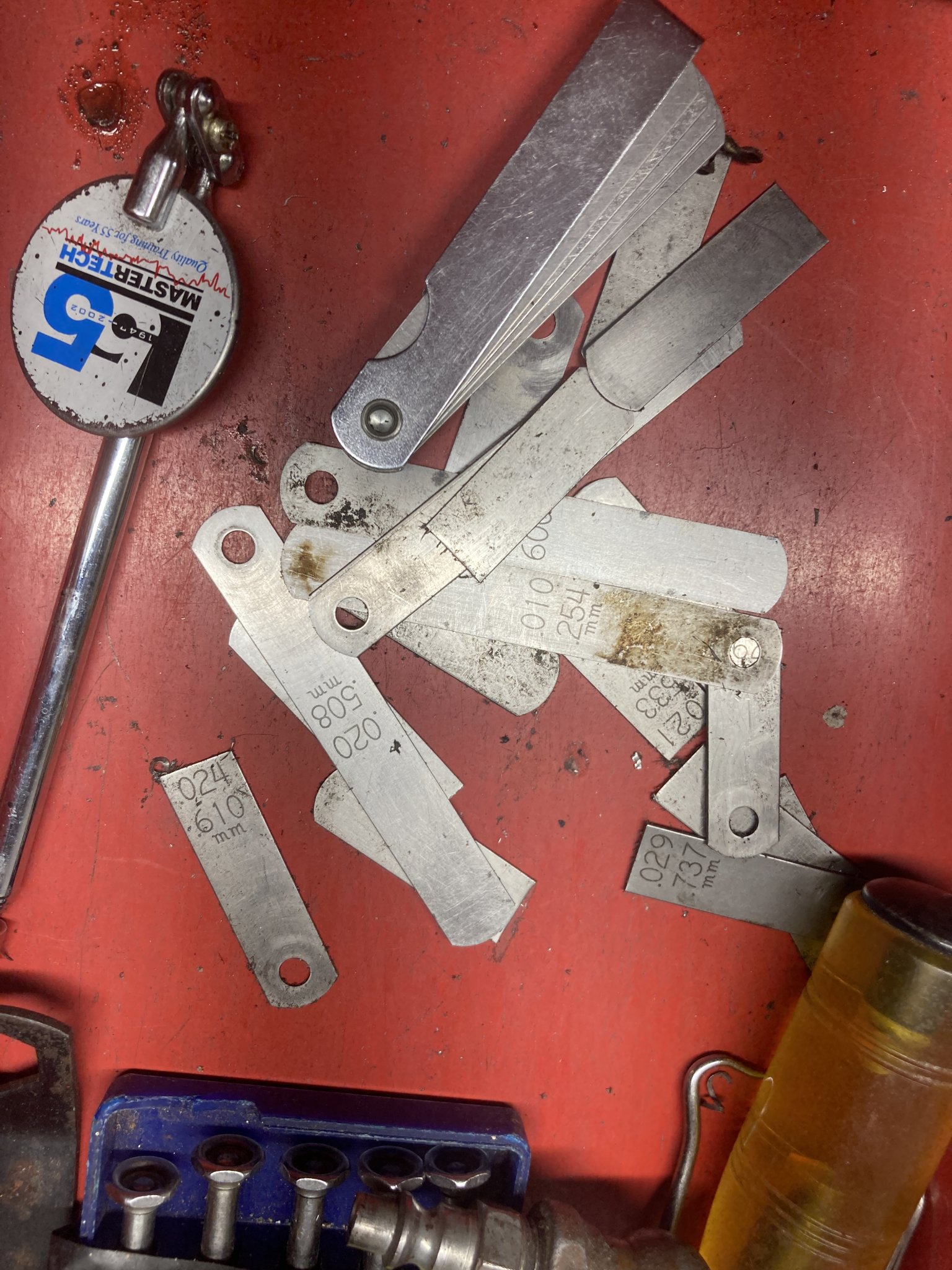

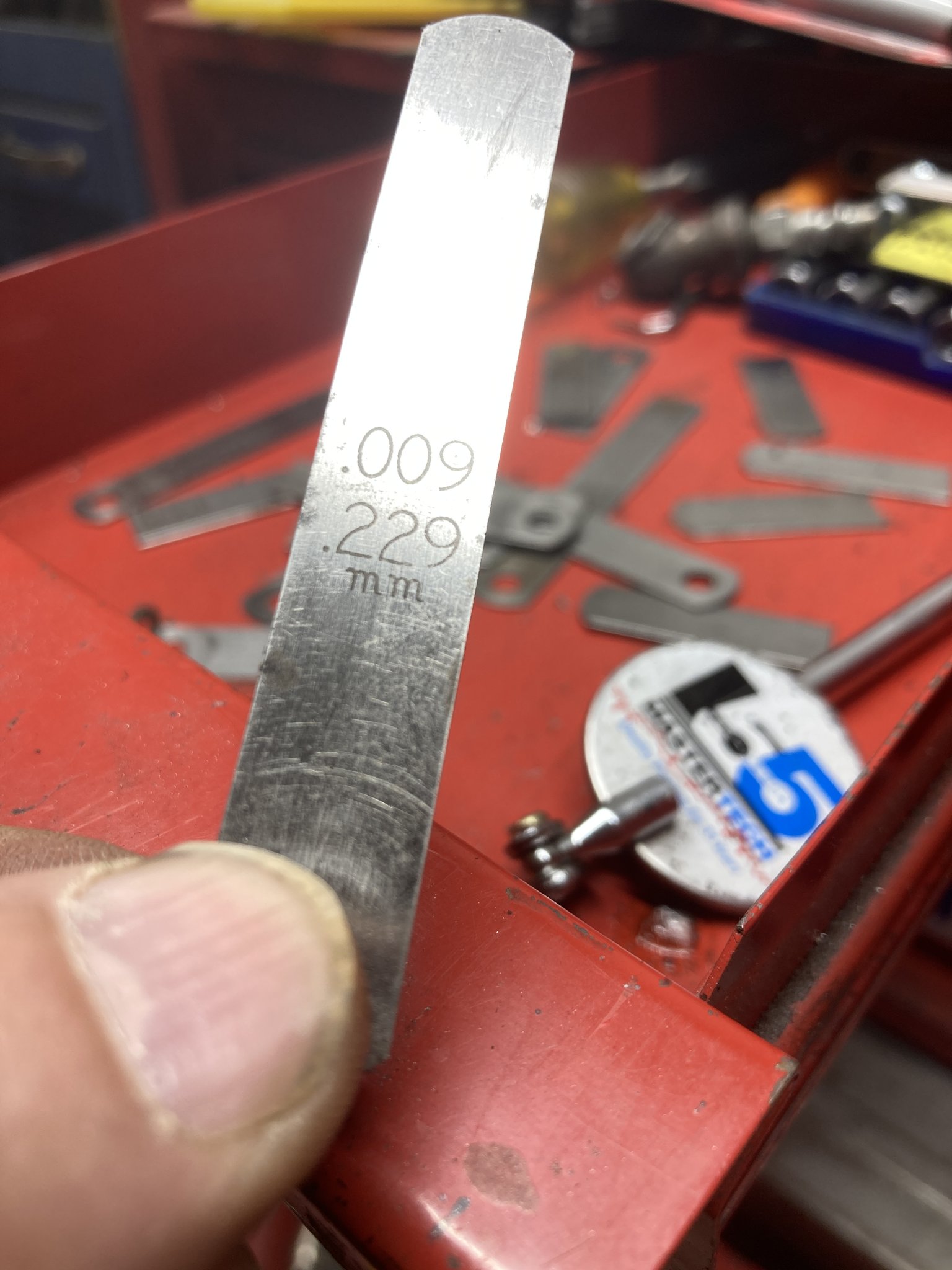

I am not sure if that is good enough or not, so I decide to try and “shim it up” to a more acceptable amount. (not knowing what that is of course, because for 185 bucks you do not get install instructions, even the ones written in "Ching’lish.

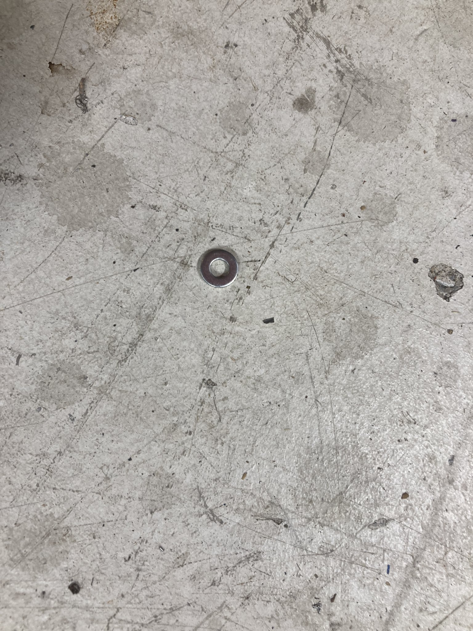

I originally decide to shim it, by grinding/sanding down the washers that I have behind the encoder.
Well that went over like a “fart in church”…The damn thing kept slipping and ending up on the floor.
So then it hit me, my wife complains about me saving every damn little screw, nut, bolt and such.
Last year I “sacrificed” a set of feeler gauges for some project, and yes…I saved the remains, so its off to the “junk drawer”
I couldn’t find the “exact” shim I needed, but I got it to within about 4 thou.
I am hoping that is “good nuff”
So being the “hoarder” that I am, I have to cut it down and save the other half… [image]
Then drill it to fit the cap screw.
For whatever reason, adding the shim got the same results as before adding the shim???
I have no idea why, but I had to take it off and on and switch it around about 5 times…But I finally got it.
~3.5 thou will have to work.

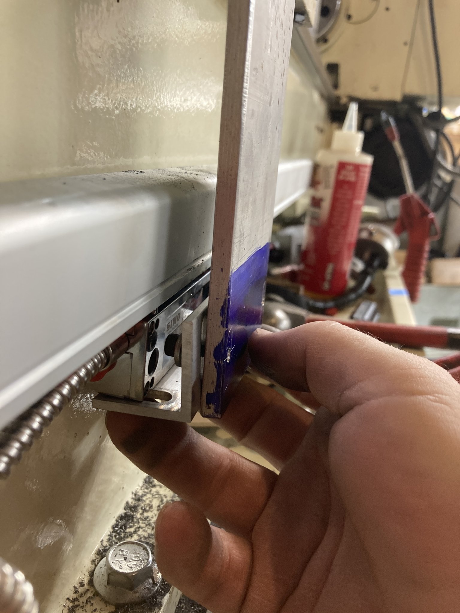

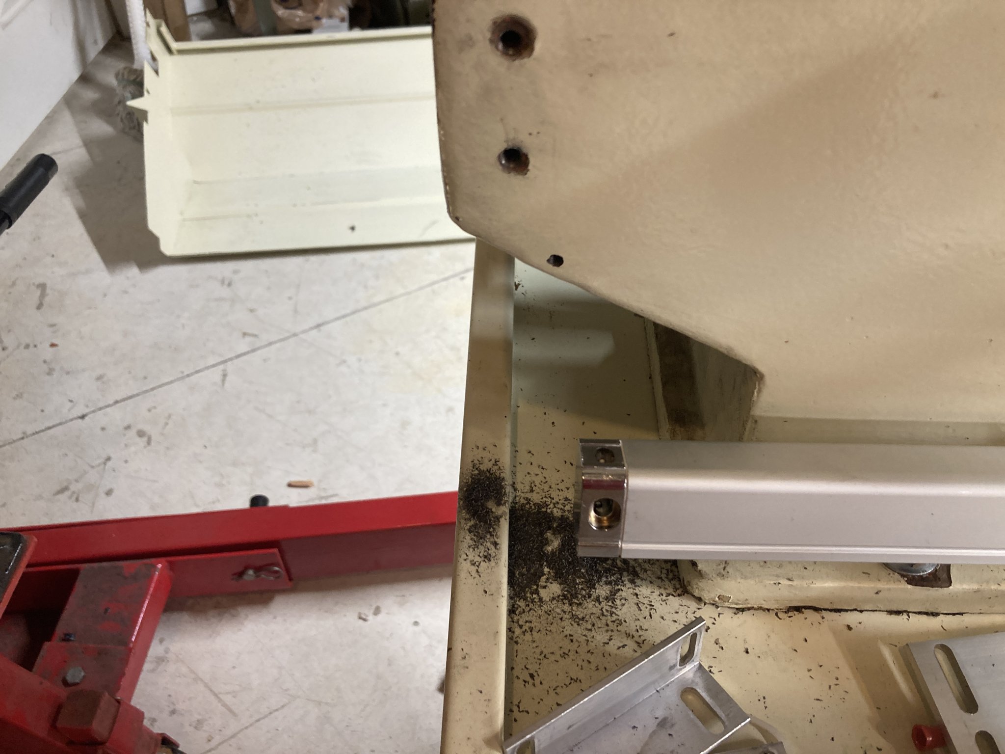

Ok, now I need to make a bracket that goes from the “encoder” to the “encoder reader thingy”
So its off to the scrap pile.
Just by happenstance, I had a piece of “mystery aluminum” that fits nearly perfectly…a little narrow, but it should work.
A dab of Dykem and it’s “hole lay out” time.
Now its time to drill the carriage, to accept the bracket, but I do not want to go all the way through and hit the ways, so I carefully measure and then wrap the drill bit with painters tape as a sort of "drill depth guide/marker.
(Off topic) for some reason this is one of my favorite tools…It’s nothing special, but for some unknown/stupid reason this stupid thing brings a smile to my face each time I use it.
Well doing things “on the fly” has some “pitfalls” of course.
So when I go to “bolt her up”, I can’t get to the damn bolt heads cause it’s too close to the “encoder reader thingy”
M$^$#@#$%^^&&**(
[image]
Well after some searching though the nearly useless hardware they send with it, I find that “diamond in the rough” and I have to do some 'hole relocating"

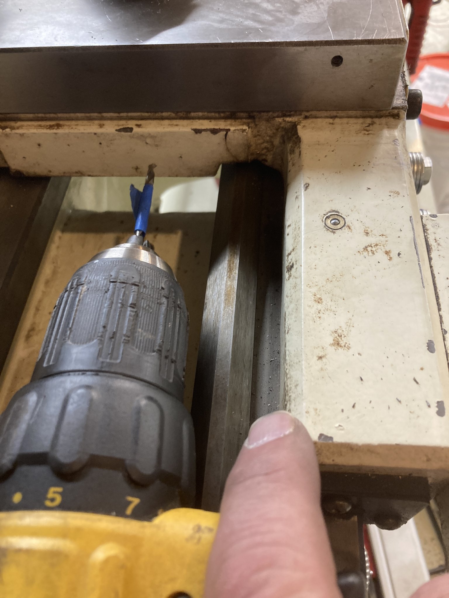

Now for the cross slide.
Things are pretty tight and it sticks up a little more than I would like, but this seems to be a common problem/occurrence on these small lathes.
But the run out is minimal right off the bat, so it’s drill time.
So here we are…the Dewalt is simply not going to fit.
I figure that an ‘extra long drill bit" would solve my problem, but I reasoned that if “Bottom taps” confused and amazed “Stevie from Ace Hardware” then a "long drill bit’ was like asking for a copy of the Magna Carta…
So what to do???

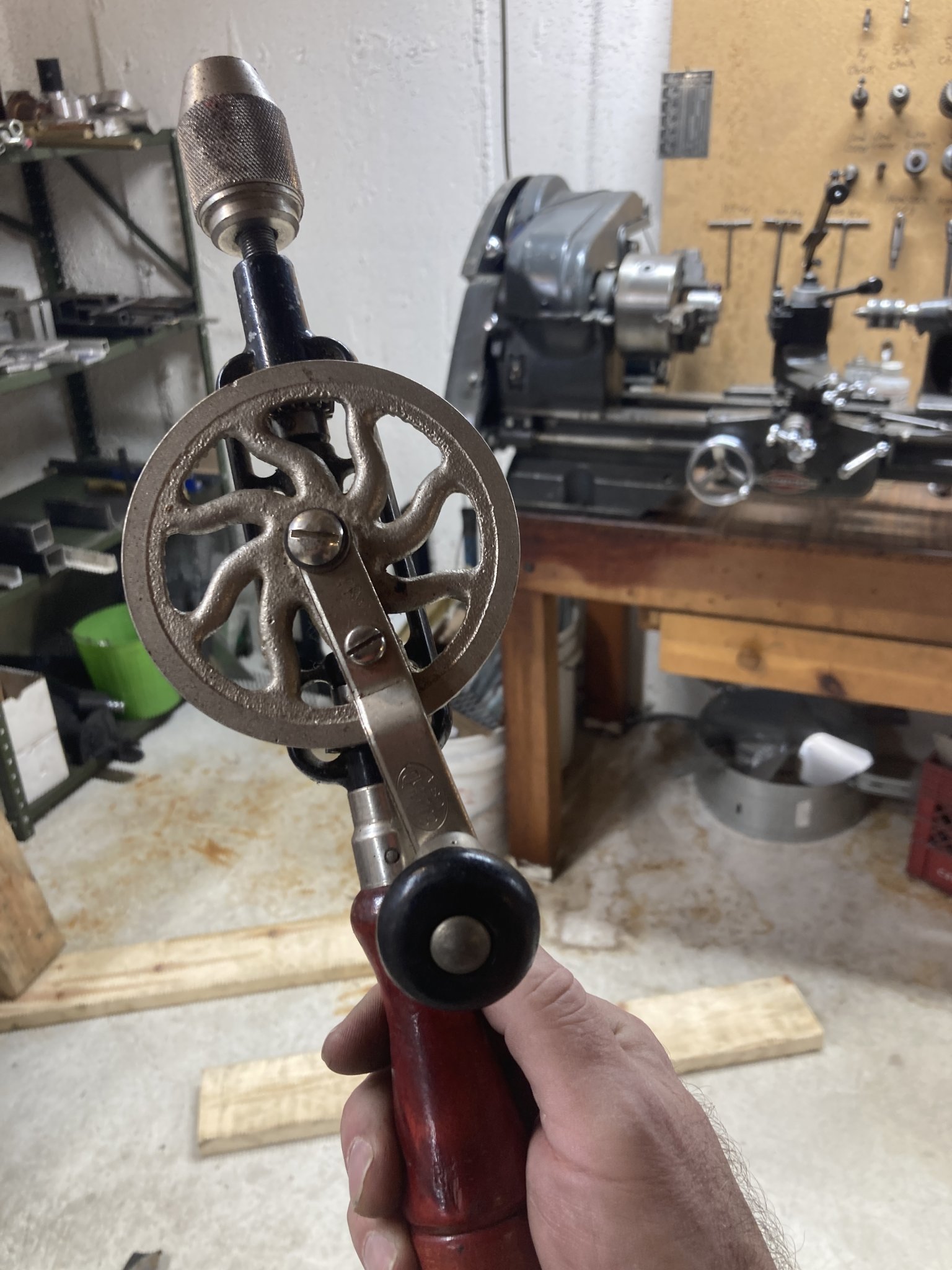

I know I have 90 degree drill somewhere, and searching for it reveals a “long lost friend”
Enter “The Hurdy Gurdy”
Haahahah…I haven’t used one of these since I was in the Marine’s working on EA-6B’s. I am shocked that I even kept it. Now for those of you who have never used one, you have not had the "entire experience’ yet.
What a totally archaic tool, that I used to be quite skilled at using. I have drilled out “literally thousands” of rivets with one of these, and logged thousands of rainy/sunny/freezing/fuel/hydraulic fluid soaked hours on EA-6B’s using one of these…
Thank God for the advent of the cordless drill.
So for “old times sake” and since it fits, I “give her a whirl” (literally)
Well my “memory lane love affair” lasted about 15 seconds before my 'flash-backs" of using this POS tool jogged my memory…
Ahhhhhh…much better now…

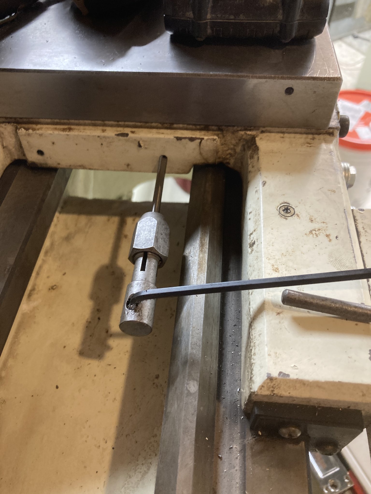

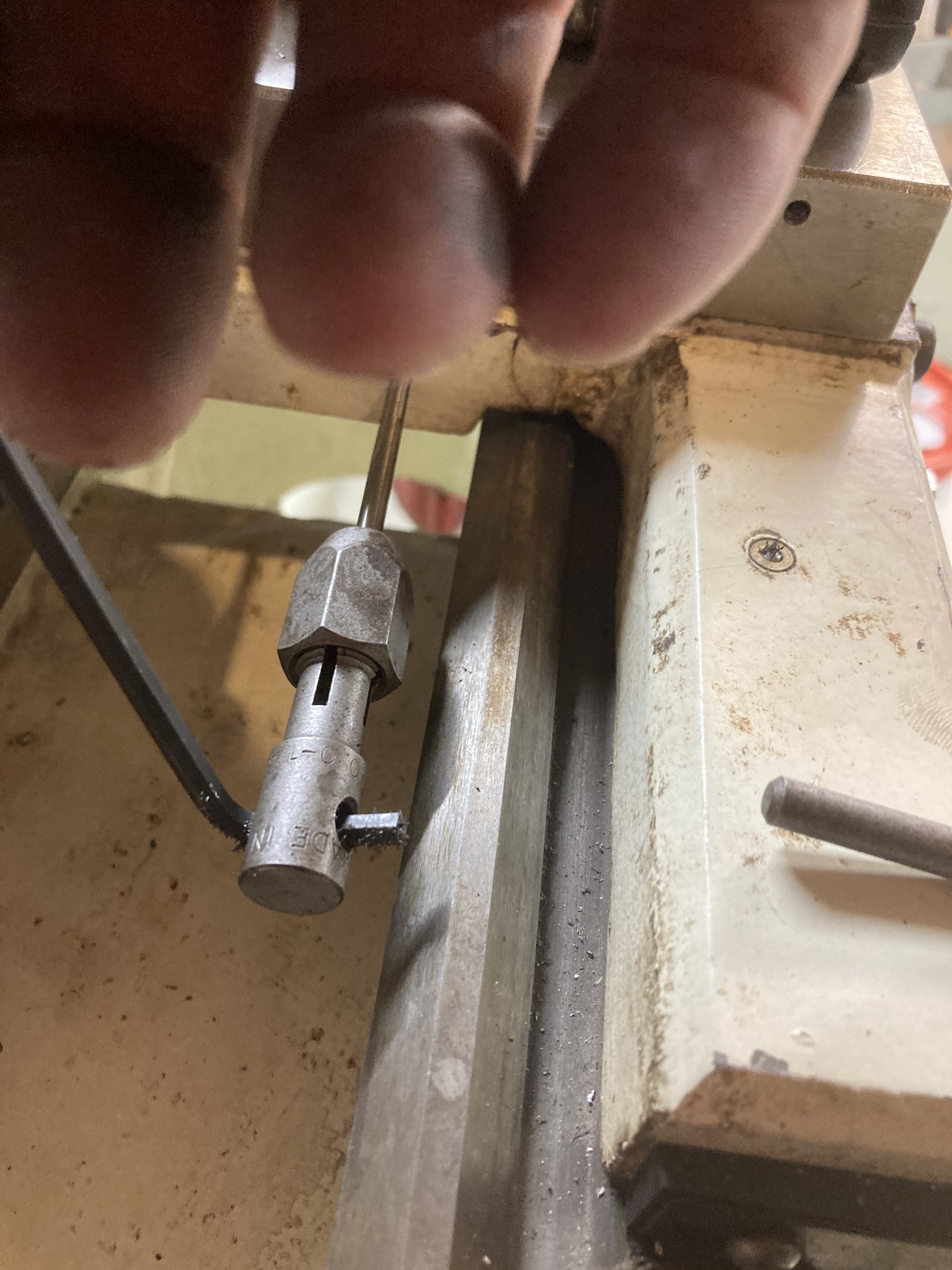

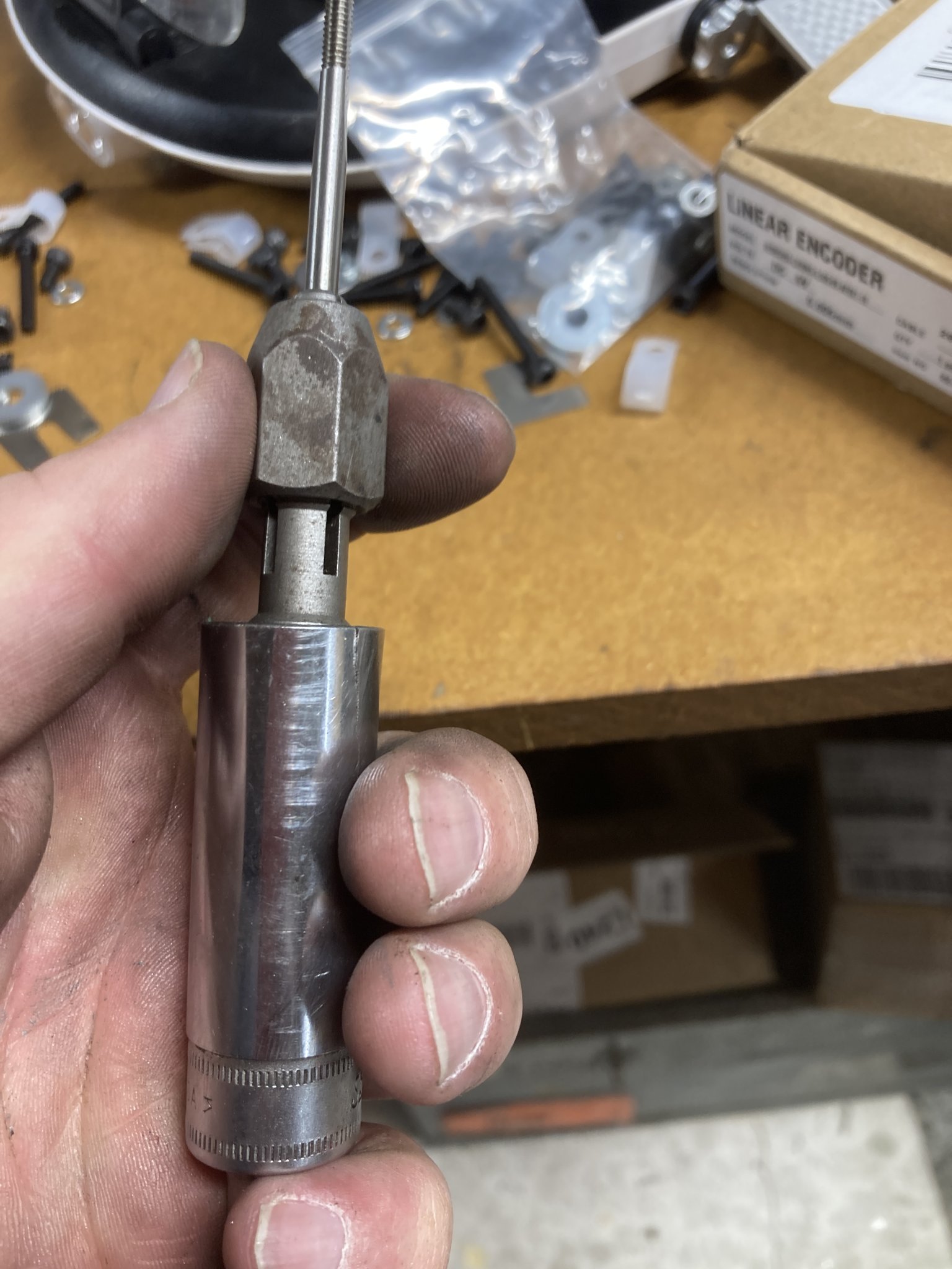

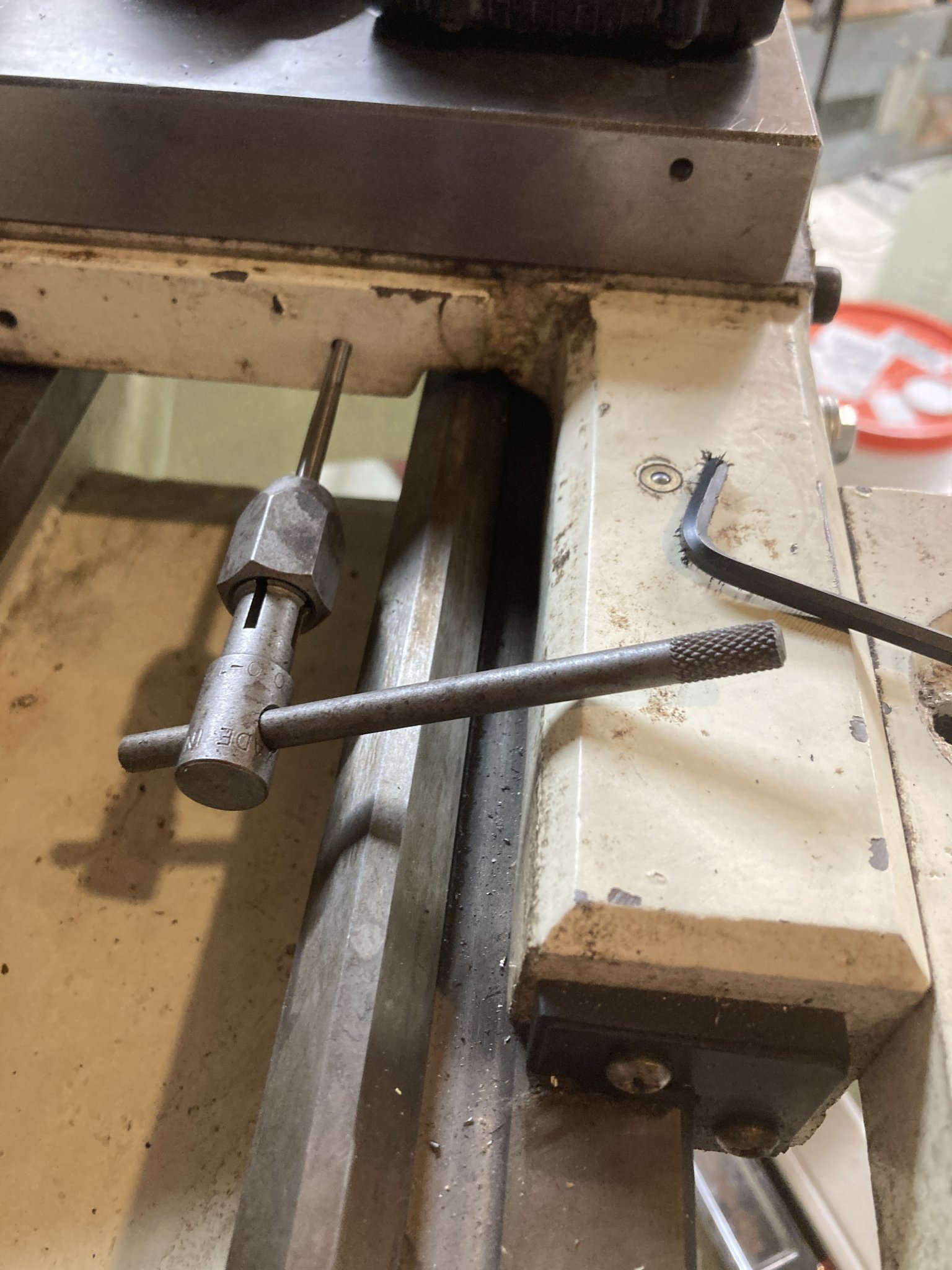

Now my problem is that I don’t have a “tap wrench” that will fit.
So I cobble this thing together.
and it works…to a certain point anyway.
It will start the tap, but after about 2 1/2 turns, the resistance is enough to “un-twist” the nut and the tap loosens.
so then I have to use an allen wrench to twist the tap when the hole is not aligned.
I forgot to take pics of the cross slide “done pictures” , but I was able to get’er done.

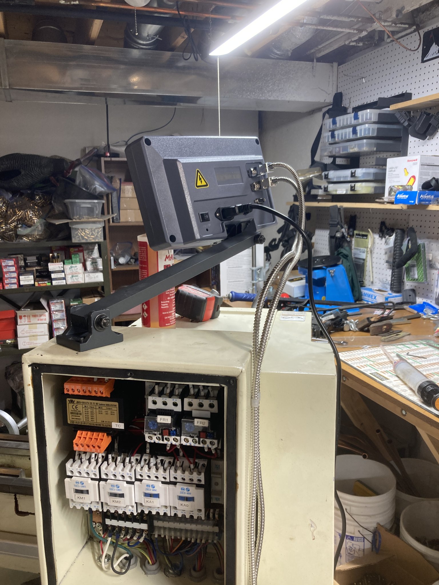

Now to mount the DRO head.
Without instructions, it took me a few minutes to figure it out.
So I decide to mount it to the “electric panel” that houses a ridiculous amount of wiring for the motor.
And here we are…the moment of truth…
She works like a champ!!!

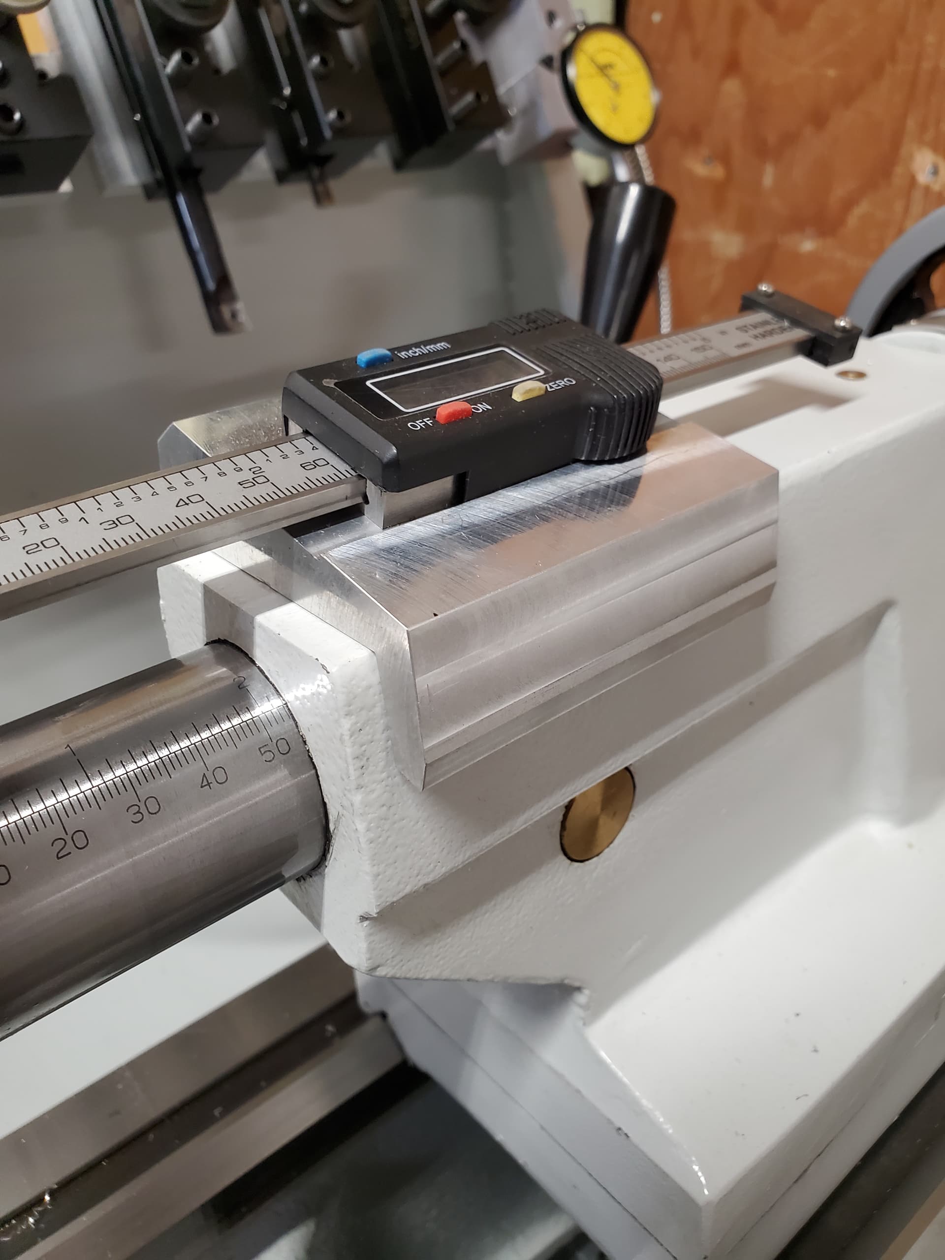

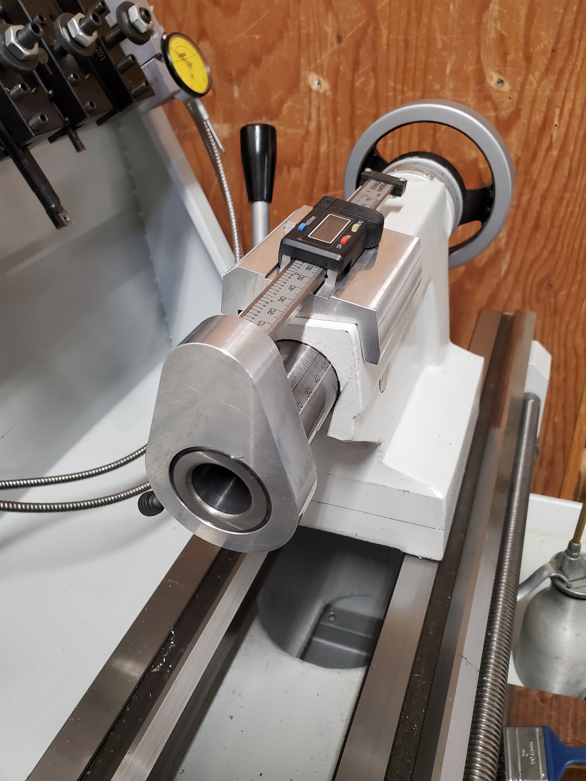

I was wondering if you used the third axis on the compound slide. Not a lot of room but seems like it would be good to have. Cutting threads is done with returns of the cross slide to zero and advancements inward of the compound slide inward until you finally cut to the root diameter of the thread. Only other way is to set up a depth mic on the compound every time you cut threads. Not to mention other operations. On my tailstock I rigged up one of these under $30 units. Works well. I’ll send another picture later of how I installed it.
I have seen that mod for the tailstock, and I have thought about it.
I need to brush up on my “Ching’lish” and read the manual to see if there is some sort of way to possibly use the SIN/COS/TAN functions (or some other functions) to my advantage.
I am certainly NOT a machinist, so this DRO stuff is pretty new to me.

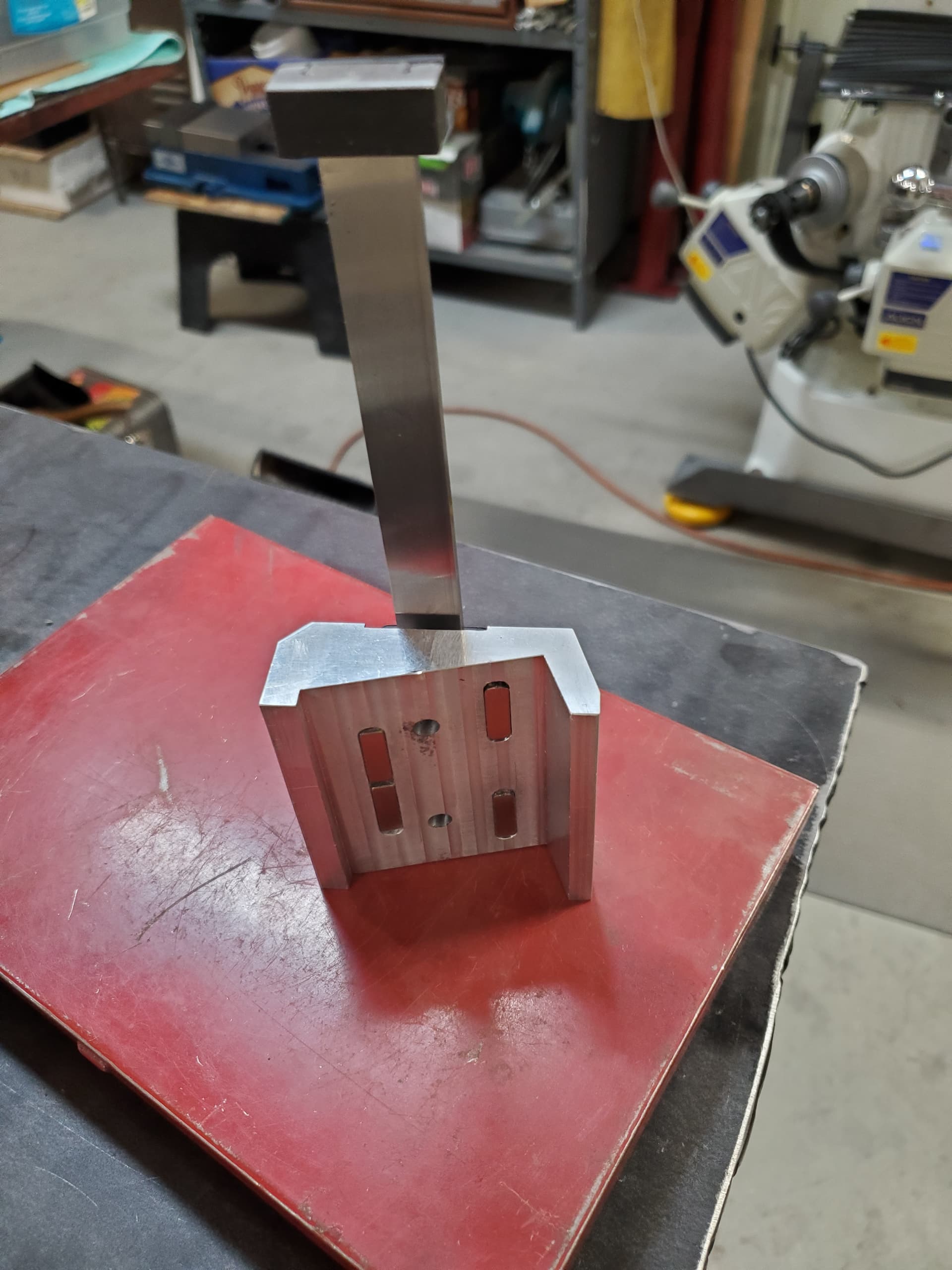

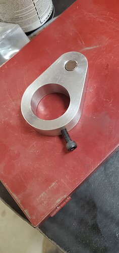

Here is how I did my tail stock DRO. I made the mount to attach with magnets so I can take it off if needed. The quill mounts with a set screw, the cap screw was just for a test fit.
Oooooo…magnets…that’s a good idea.
Nice job on that “mount” too!!! :+1: :beers:
