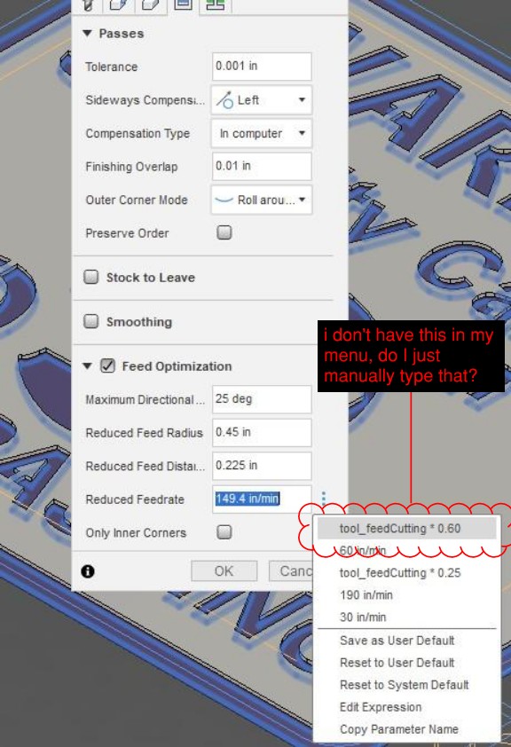

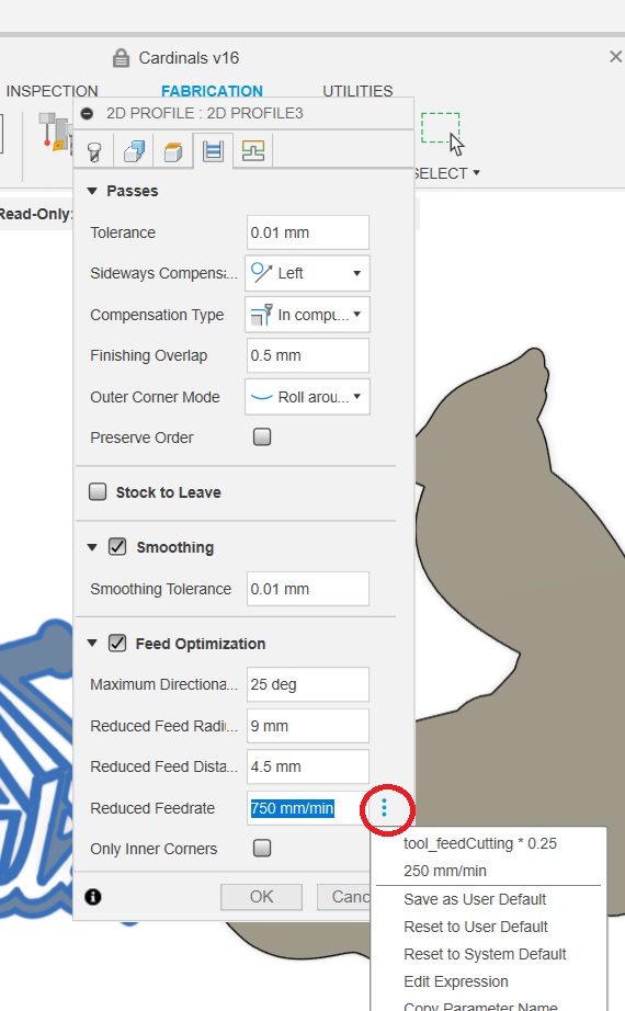

You might also increase your speed with optimization. The default in Fusion 360 is too low. If you click on the three dots next to the speed setting, you can set it to be 60% of your feedrate by default. Fusion is set up for 25%. Notice your corners are doing the same thing.
Here is the actual menu you change:

Should I alter any of the other feed optimization settings or just the feed rate?

I have not so I would just make one or two changes initially, just so you can see what is happening.
Higher up in the menu, you might change the tolerance to thousands place 0.004 vs 0.0004 but that won’t change the the divot but may make the contour selections easier.

If you are picking “Feed Optimization” the default speed, unless you have changed it, will be 25% of the cut speed: Way too slow! Change that to 60% of your cut speed. If to hover to the right of the entry box you will see 3 vertical dots then the drop down menu appears. In this drop down menu you can set your own default. Once you set your own default, open this up again and pick “Save as User Default” and you will never have to think of it again.

Im trying to adjust this to 60%, I don’t have this in my menu,
You can type it exactly and enter it yourself but what I did was grab the “tool_feedCutting * 0.25” and just modify it to whatever percentage you want.
Once you have it they way you want, open that menu up again and click on “Save as User Default” and it will remain there.
I think you have to select “Edit Expression” first.
There’s some little dots to the right that you must select, then the drop down will appear.
thank you! I didnt realize I had to click “edit expression” never heard that term before Haha

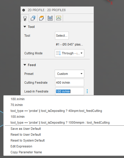

Another fun fact, no matter what I do, I cannot get a formula to stick in the value for Lead-in/Lead-out feedrate:
I can add the similar formula as we are using in the Feed Optimization and it will work within the given tool path to change based on changing the “Cutting Feedrate” but once you move to a new tool path, the formula is lost in the new tool path. Even when saving the “User Default”
