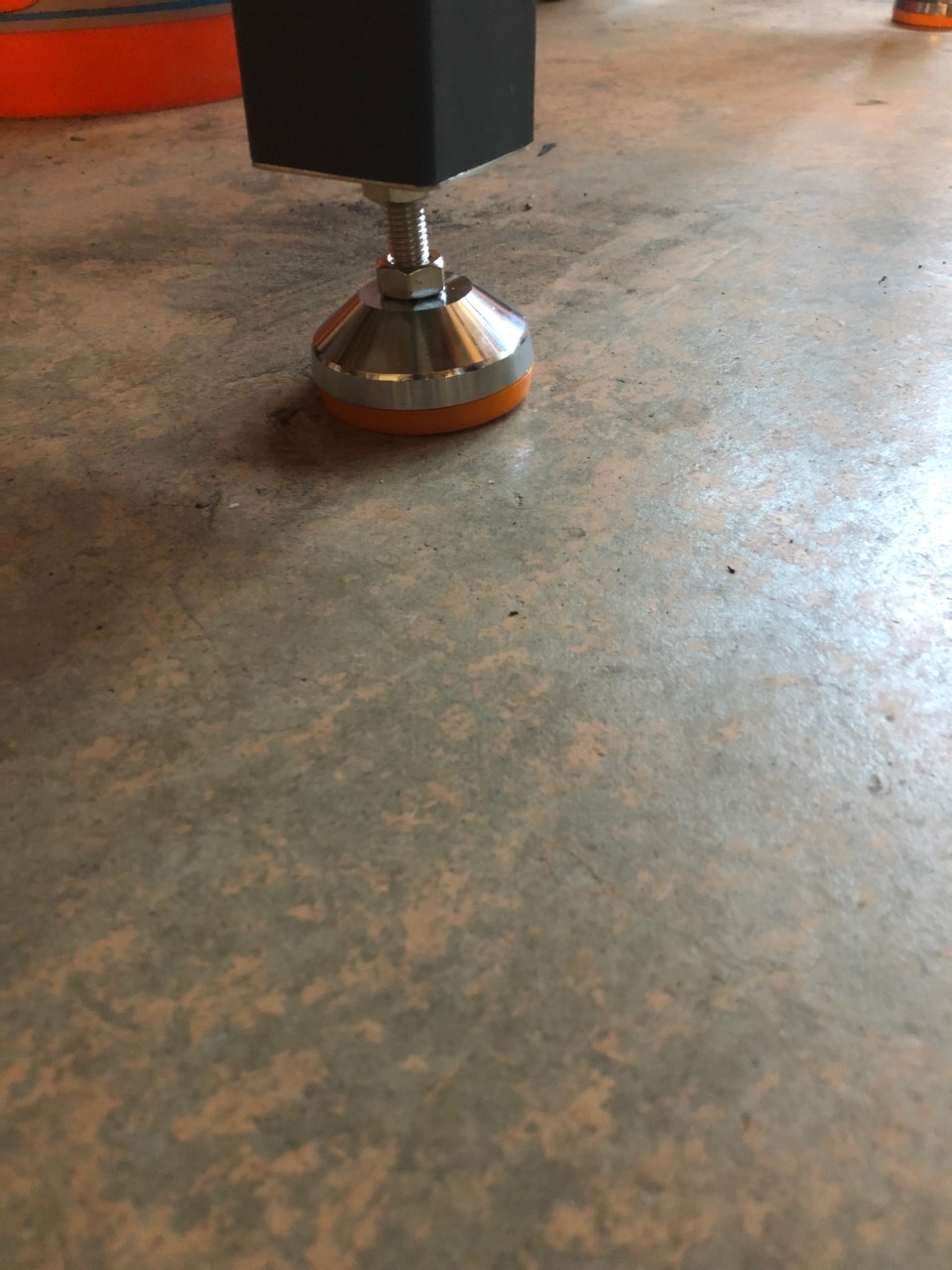

So the casters are M10 screws while the “leveling casters” are M12. I guess I could re-thread the M12 to fit the M10 or mount the plate casters via welding, but I don’t want to put any ugly welds on the table. There are other routes I could go here, but in the end I decided to go with my original plan and try out some heavy duty leveling fixed feet.
I don’t move the machine that much, and when I need to I will using my handy hydraulic table cart.

I went with these, they are actually on right now and make a HUGE difference in stability. Before when I would wiggle the machine torch the whole table would wiggle, now it’s much more solid even without water. I can still get some movement, but I suspect that’ll be almost gone when i fill the table up with 5-7 gallons of weight.
Here it is installed, it’s pretty beefy! The shorter the thread, the more stable the table becomes. As I have it now it lowered everything by 2".

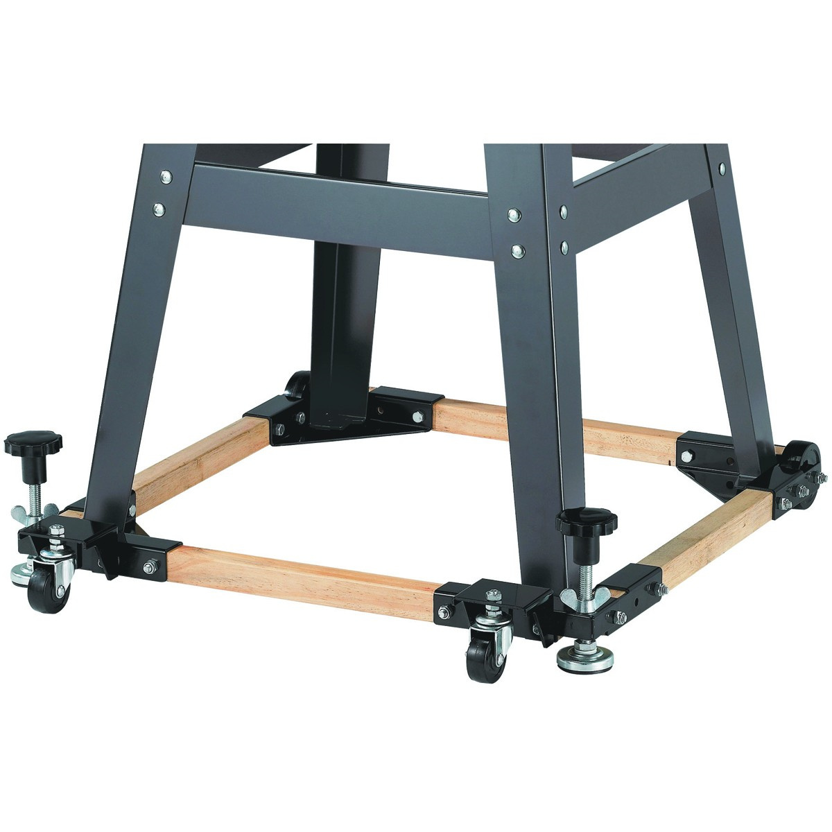

Even something like this, but replace the wood with metal tubing.
That looks like the rolling base unit I got from Harbor Freight for my blast cabinet.
I have this kit under my table saw. Every level is fastened to the next so it acts as one piece when moved. My experience is this is very awkward to move in any direction but straight forward and back in the direction of the fixed wheels. For something as heavy as the plasma table, especially if you have the water table and any custom water storage for easy fill/drain operations it would end up being a huge pain. It also only adjusts two legs for leveling. My preference is for rotating 360 degree castors with leveling feet on all four corners for overall ease of use. Great discussion thanks for all the great ideas.
