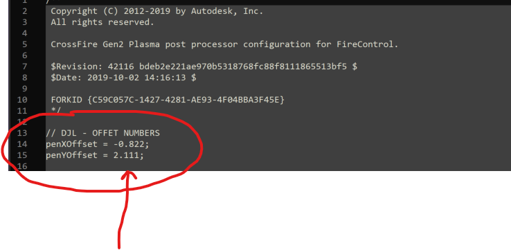

Lastly was dealing with offset of the pen (offset from the location of the torch X0, Y0) . I chose to tackle that in a custom postprocess.
The post processor takes into account the offset AND (remember making it idiot proofer) it makes sure the torch doesn’t fire, nor engages the THC. I force both of them to off.
I started the post process with a copy of the langmuir one and renamed it and went from there.
Here is a copy of that…
FireControl-Sharpie Post Processor.cps.f3d (19.0 KB)
I added a stupid file ext f3d to it so I could upload it here. Obviously delete it as post processors end in “.cps”
If you build this you will need to calculate your own offsets for the post processor. Just play with them and plug them in the top of the post processor here:

Lastly in fusion, when you want to “draw something” you select the custom sharpie pen post processor. Again that shuts off the touch, the THC, and - temporarily - creates the offsets to position it properly. After use the offsets go back to normal zeros for cutting.

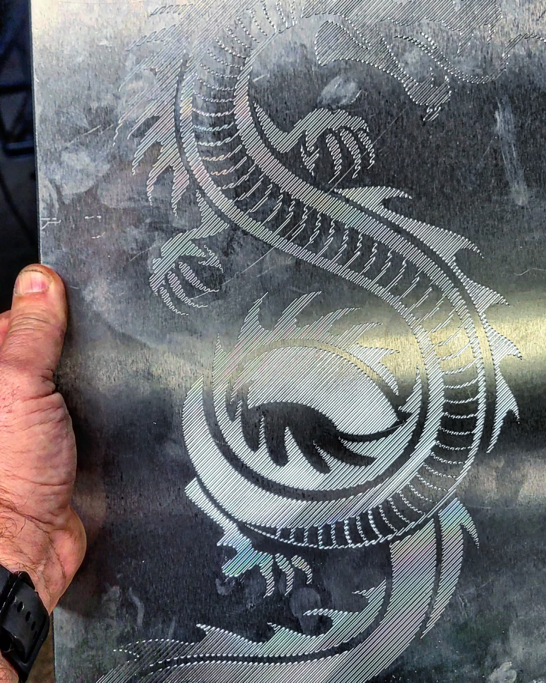

Here is one I did a couple of weeks ago works great.I used the axidraw extension for inkscape. Used the plate marker setup in sheetcam. I posted it on fireshare if anyone what’s to down load it. It took about 45 mins to draw it.
Easyscriber? Single pass?
Some of it was I did the hatch fill. It would do some sections single pass others it would do a lighter pass then make a second I wasn’t sure what was going on. I watched a few videos on it
I’ll have to check out the gcode later. I played around with my easyscriber about 6 months ago on painted steel, but it was chipping so I lost interest in messing with it. I mainly used it for bend lines but now I just use my marker setup.
I set mine up with sheetcam using the plate marker.
The outcome is very cool. I would be interested to know more about how the varying passes work.

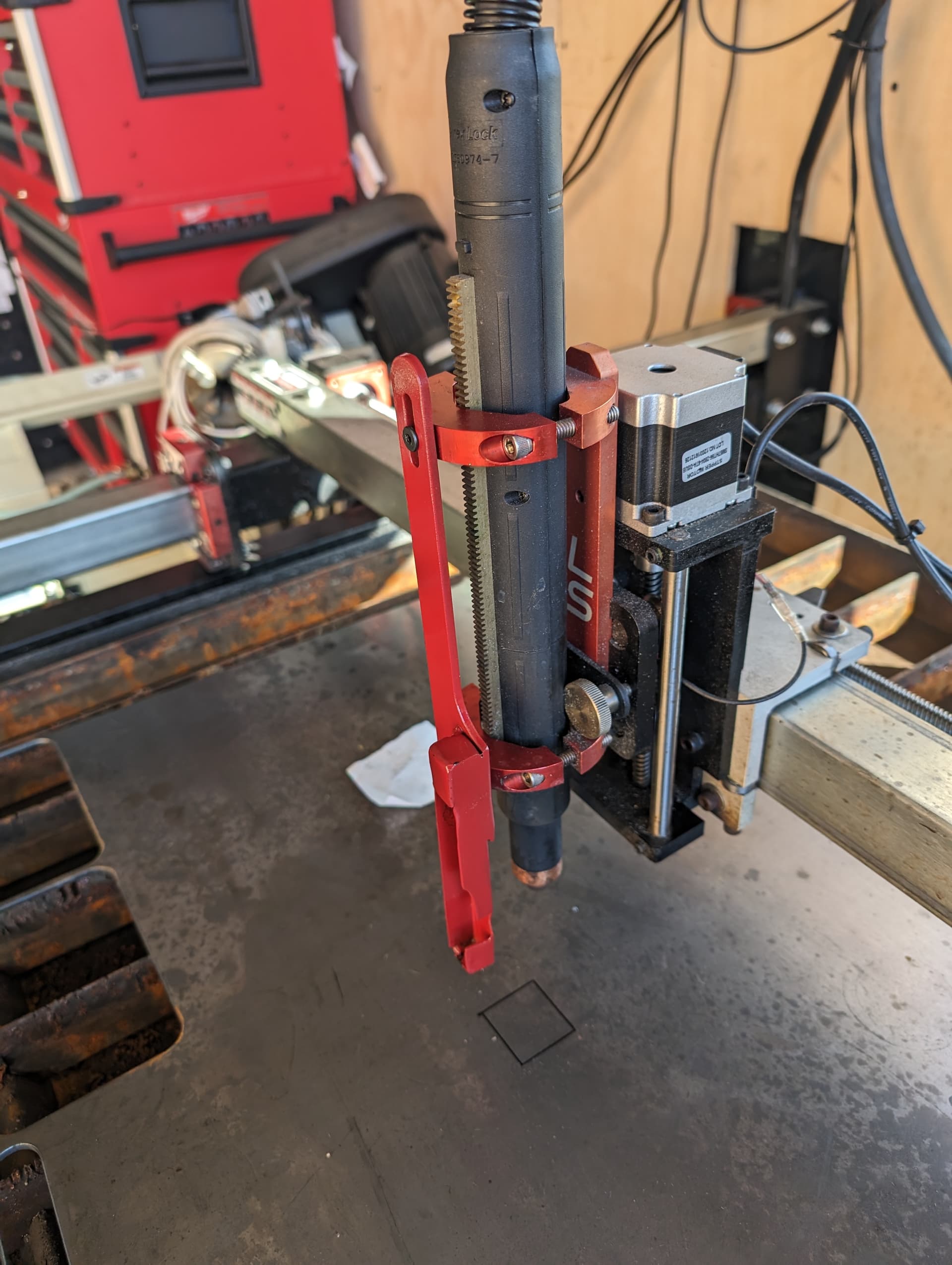

Here is a pen that fits most plasma cutter if anyone is interested.
Recently we had a discussion on this forum and similar holder. He created the offset in the gcode which is the real issue with this type of pen holder. very cool to build that into the gcode. I like the one i have but you do have to remove the torch but no offset to deal with it. not sure if you care about the offset but if you plan on using for bend lines and things that also use your torch in combination you’ll want to figure it out. Once you know the offset you could zero torch in firecontrol and just move the pen to your offset and hit start. that would be the easiest way to accomplish it.
