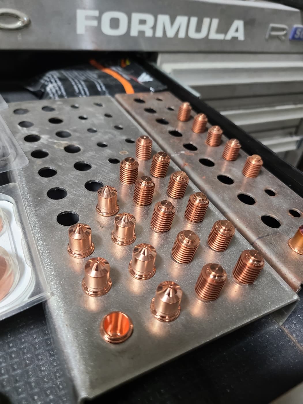

Its not plastic but im sure you could design something to 3D print that would be better, but i made a simple tray for our consumables out of stainless sheet metal.
