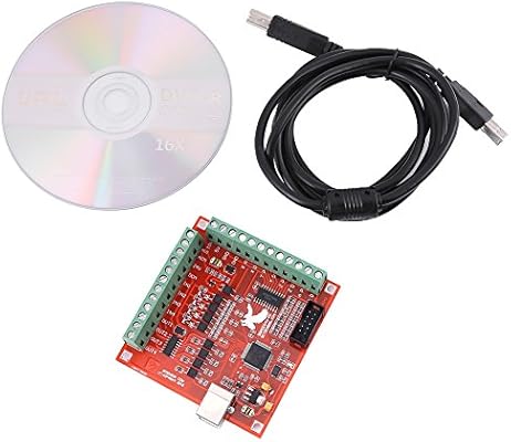

The good news is that the Mach3 controller board inside the Crossfire has 4 unused input pins. These pins can be used for any four things you, as a user, desire. For me, they are;

To utilize these inputs, the controller board requires 24VDC input. Other posters have noted that have succeeded with lower voltages, potentially even swapping a resistor on the controller to allow use of the USB provided 5VDC. I chose a different route and added a Buck Converter to step down the 36VDC provided by the Motor Power Supply to 24VDC. I used a programmable converter:

The positive output of the converter is sent to the 24V pin on the controller board and the negative output to the DCM pin. I removed the existing plug and connected directly to the board pins using crimped JST female connectors with heat shrink around them. JST connectors are technically too small, but with the heat shrink they’ll hold tight and they’re what I had in stock.

The even number pins were connected with the same crimped connectors to the IN1, IN2, IN3 and IN4 pins on the controller board (see pic above.)

I already soldered the resistors on top of my inputs to support 5V. I agree to is probably a good idea to keep the inputs isolated from the usb 5v. I have some buck converters on hand and I might use one to supply the 5v for the inputs and output relay.

As near as I can measure, it’s 0.050" (1.2mm) pins on 0.2 (5.08mm) spacing.
I couldn’t find the connector and ended up connecting directly to the pins. I used female connectors (from pretty much any kind of connector system; JST, Molex, etc.) crimped to the wires with some heatshrink as a shield.
just buy an extra MCB with the screw type connections.
This one will work… straight swap.
I don’t know the PN for the exact connector LG used, but an equivalent is:
Molex 10-01-3046, Mouser 538-10-01-3046
The matching crimp pin is 08-70-1031, Mouser 538-08-70-1031.
Bear in mind that the IN1-IN4 pins are rated for 24V input, 5V input won’t trigger them with changing resistors on the board. Further, LG has wired the IO supply to the 5V USB from your computer so that creates an additional load and less isolation on the Limit switches.
12V is sufficient to trigger the signals, but, again you’ll need to rewire the supply to the IO section.
