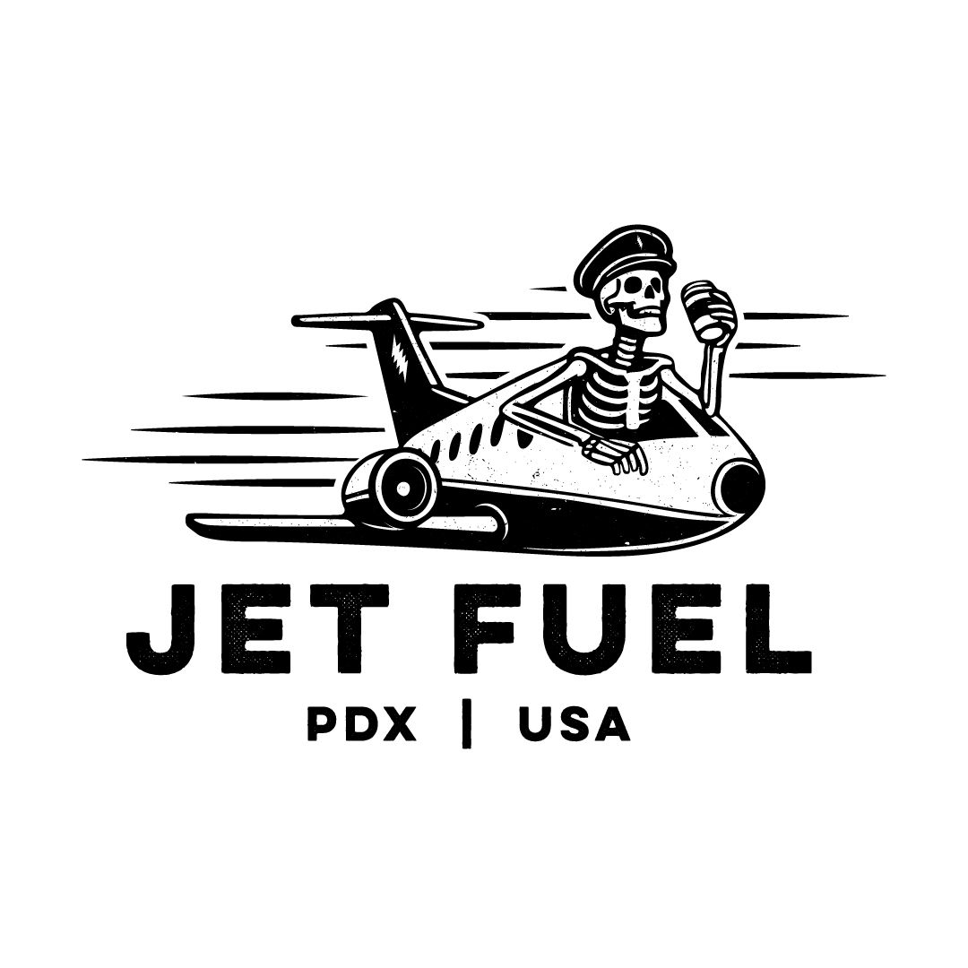

Hello,

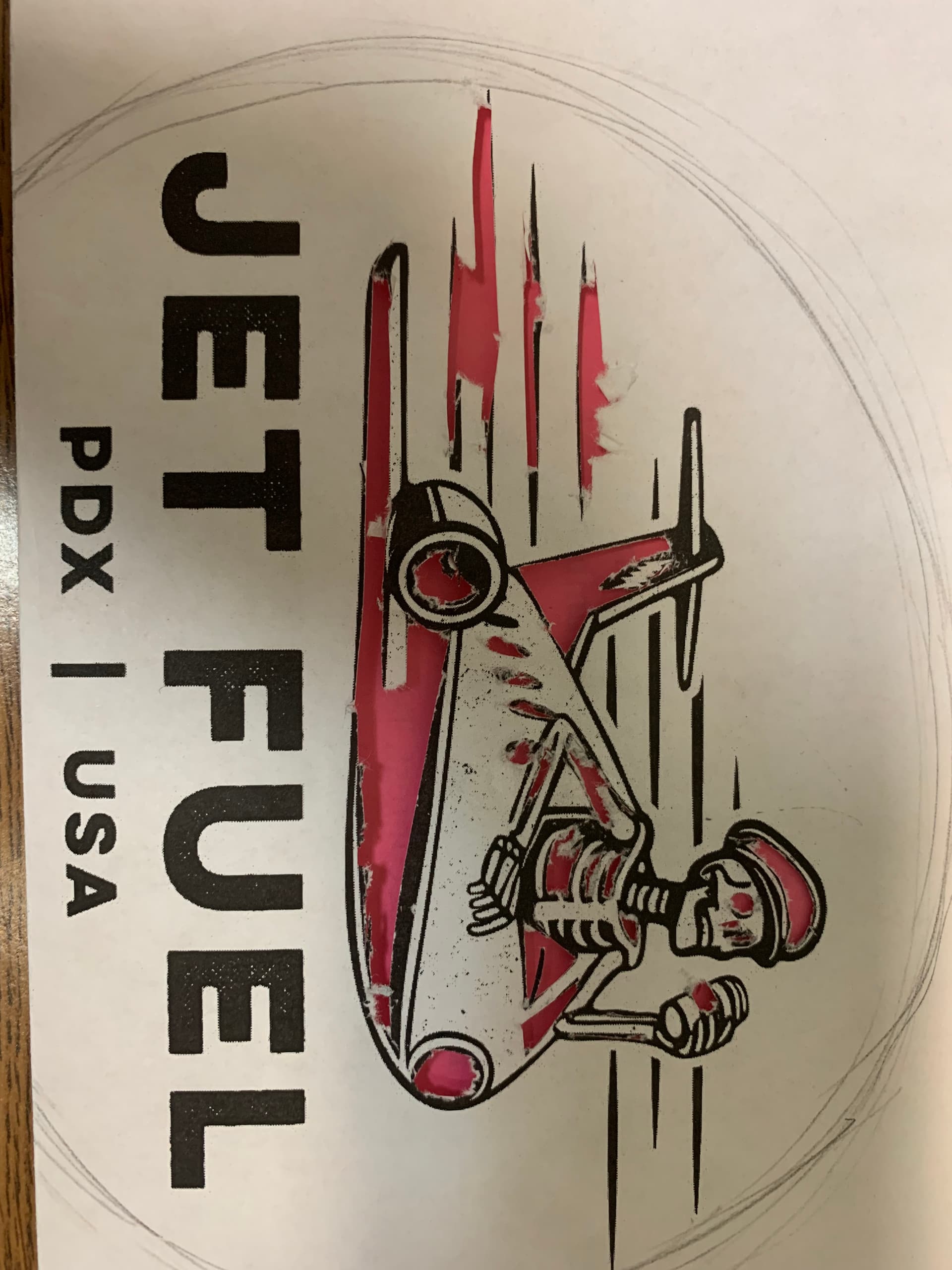

My neighbor asked if I could cut this design out for him. I converted it to an SVG and cleaned it up a little.
I am having a hard time understanding or visualizing what needs to get cut out and what needs to stay. Looking at the skeleton and airplane I think it would make sense to cut everything that is in black and leave everything that is in white.
I have extruded the image, and I get the opposite of what I am looking for. All of the white wants to cut out and it leaves the black.
I am just not sure how to keep the pieces I want. I am thinking I have to close lines and connect pieces to the outline of the plane, so they don’t fall out? i.e. the lightning
I hope I am on the right track. This seems to be one of the more complicated pieces I have tried so far.
I uploaded an example of what I was thinking. The picture with the pink piece of paper shows what I want to be cut out. Did a rough cut-out so I could try and visualize it.
Thank you
Chad
JETFUEL
JETFUELSIGN.f3d (372.5 KB)

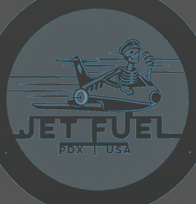

No need to extrude.
On the right side of an open sketch, ensure you have Profile enabled.
This will “shade” in the area inside of a closed loop.
That’ll give you the visual you need as you continue to bridge items together.

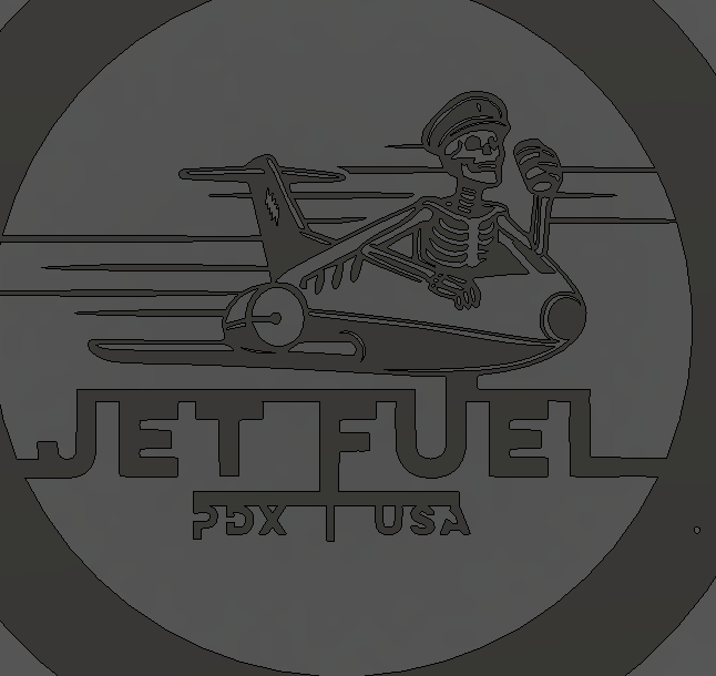

OK, I’ve worked on the sketch for a few hours and here is what I came up with. I saved my design as a DXF and attached it.
JETFUELSIGN.dxf (415.4 KB)
I was wondering if I could get some input on what looks good and what is questionable. My concern is the small lines that are close together may interfere with each other.

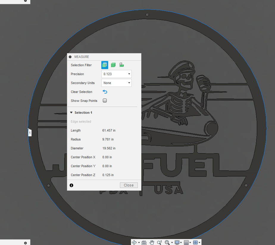

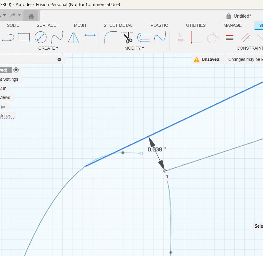

Need a bit more information as I am not sure of your intended size. What cutter and consumables are you using?
To insert the dxf, it comes into Fusion at just under 20 inch diameter.

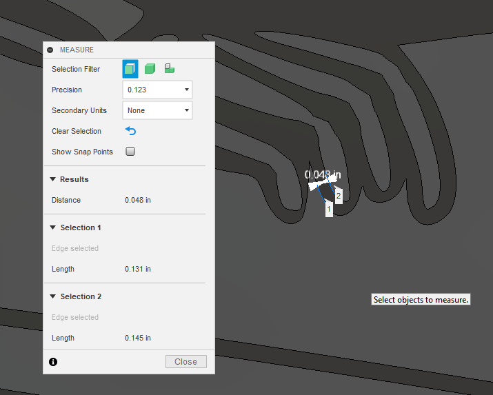

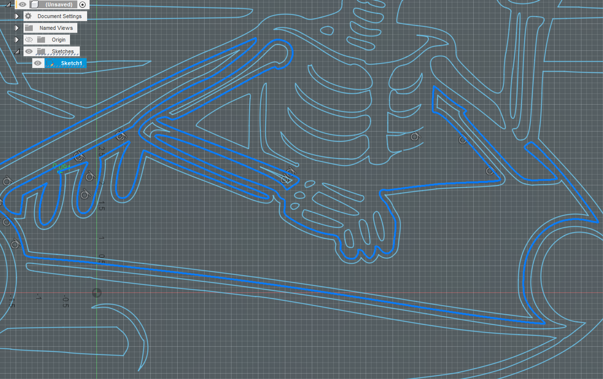

I took a quick look and there are areas like the fingers were the metal is not going to survive. You need at least 0.11 inches of metal to reliably survive being cut from both sides. Occasionally, you might get lucky with 0.07 inches but don’t count on it. The little finger will not survive:
The other fingers probably won’t survive either:
Of course my comments relate to standard consumables with Hypertherm. Others can weigh in on their setups and requirements.
(I am out driving truck the rest of today. Have a good one everyone!)

I am using a Razorweld cut 45 with the standard consumables that came with the plasma cutter.
Yes, that is the correct size diameter should be 19".

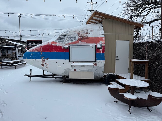

So, after talking with my neighbor again today he is ok with the sign being made larger. So, my thinking is taking the smallest area and scale it to 0.11 inches and everything should survive the cuts. Not sure what size the entire sign will be yet, but I guess I’ll find out.

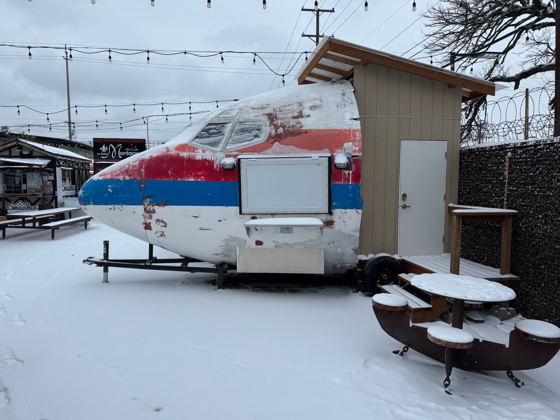

The sign is going to hang on the side of this DC8 nose. It is in a food cart area and will be serving coffee. The original plan was to have it small enough to sit on the counter. I found that to be a no go. So, now he going to attach the sign to the side of the plane under the windows.
Thanks again it is great to learn!

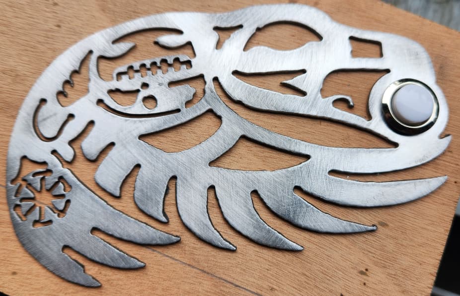

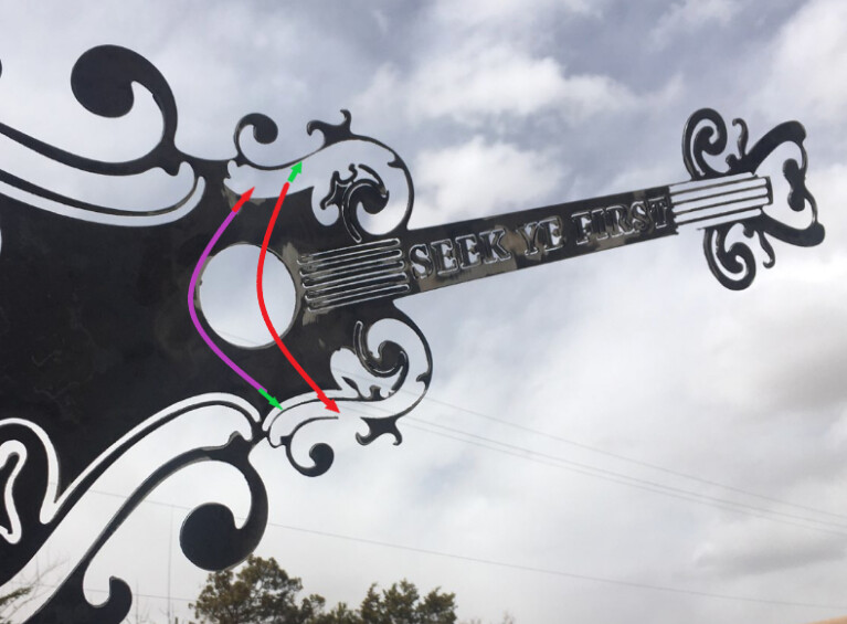

Just to give you more of an idea with the size, my guideline of 0.11 inches WILL survive the cutting process in most instances. As Tin and Bret are saying, you might get by with less of a margin of size. I have even had pieces that were 0.07 inches survive but you have to be careful with it and it all depends how your piece is going to be displayed.
This picture shows some very small areas that did not survive on one side of the guitar but did on the opposite side. The green arrow heads are showing “survivors” and the red arrow heads show where the metal was burned or fell away. (It can also “fall” away during the cleaning process to remove dross and finish the sign.)
Note: In no way am I trying to pick on this person’s work. I have done things that are much worse. This is only for illustration purposes.
Here is another example of something I did. I could not get all the detail I wanted so I had to simplify the details: still leave the same impression without all the pieces.
This is what a friend wanted for a door bell plate cut out of metal:
This is how I had to reduce features. It lost lots of the art but they were still delighted and I would do a better job today since this was when my cut height was wrong and the lead-ins show. (Perhaps not a great example!!!)
For your skeleton, the right hand is a bit of a problem and you might resolve it by making it three fingers instead of four. Some of the other areas just need a little redrawing to make the piece thicker.
Use all the tools at your disposal: Make it as big as your custormer wants or tolerates and then modify those areas you still find.

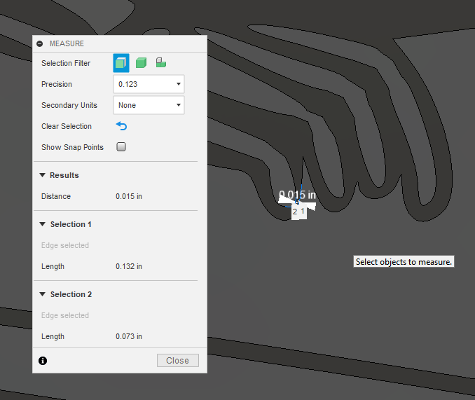

I deleted parts of fingers and tried to go through and triple check that I had at least 0.11 clearance between all lines.
So, when I create a model and view the model all areas of the sign in brown should be the parts that stay everything in white should get cut out. Is this correct?
I have attached a dxf file.
jetfuelsign2ndattempt.dxf (419.9 KB)

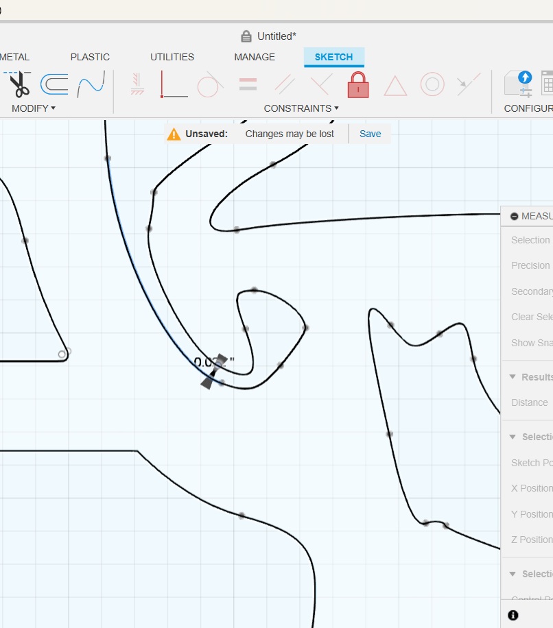

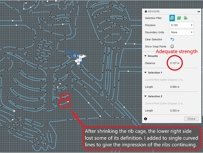

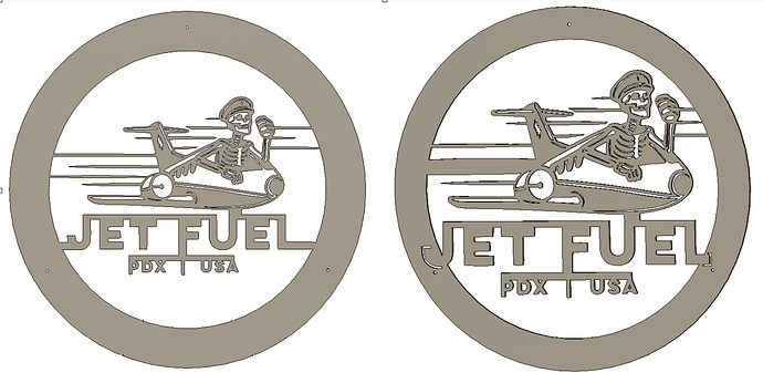

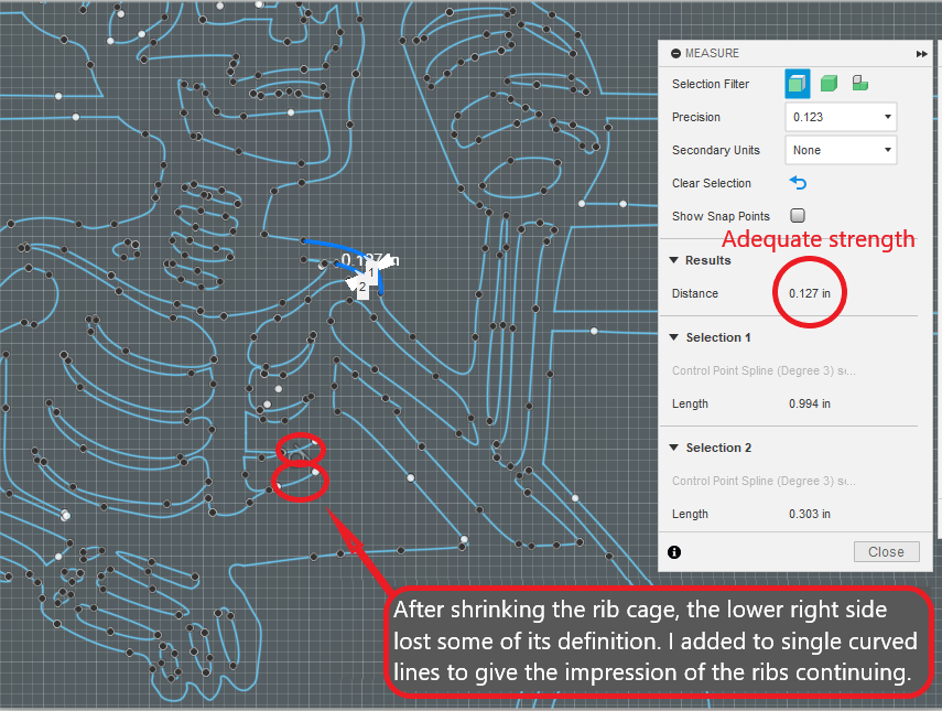

That looks good but there is still some tremendous amount of metal of the head that is supported by this small area:

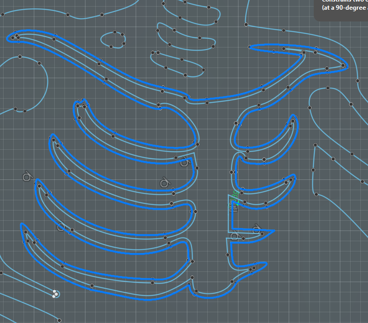

So I clicked on the entire rib cage (required some fixing of the sketch) and then did an offset inward of the rib cage, then delete the original rib cage line:
After deleting the original rib cage, the lower ribs on the right needed some added definition so you could add some single curved lines. You can also see that we now have added metal to support the head:
I strengthened the fuselage the same way:

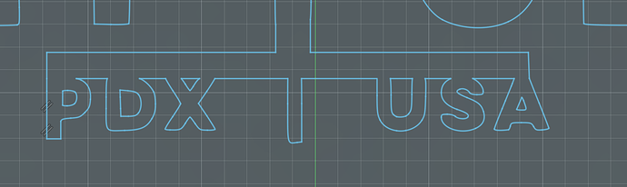

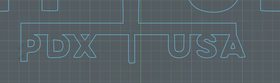

You don’t need to stencil your letters since the main structure of the letter is embedded in the metal:
The outer rim could probably be reduced, but that is up to you.
JetFuelChelan v1.f3d (1.6 MB)
JetFuelChelan v1.dxf (6.9 MB)

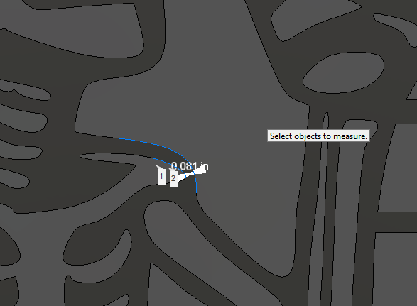

OK, so I see at the acromion bone when you measured it was only 0.81. So, not enough metal to really hold it together. So, for the future measure all suspicious areas to make sure there is enough metal in order to hold it together. ( 0.12 will give adequate strength )
Rib cage: I never thought about offsetting the rib cage like you did in order to shrink it and then give more room for the acromion. Then added to the lower ribs in order to make them look complete. I also see you circled in red 0.127 will give adequate strength. Knowing that number is very helpful.
