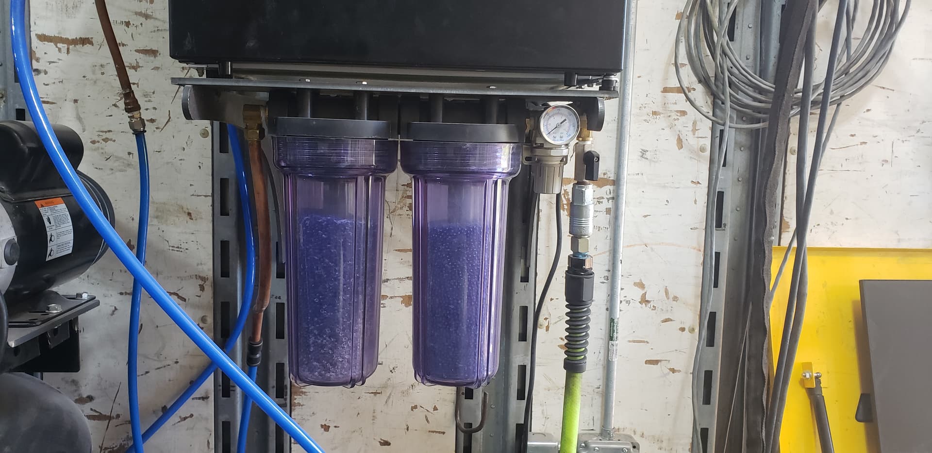

Yea, might have to return these for a higher pressure unit, or find something else that needs filtering.
What is the cost of these filters? Is it better to buy something then Ricky rig it to do something it isn’t designed for? How much will you save and how effective is it?
DIYing it will save several hundred dollars.
10" 125psi water filter $30ish (Amazon.com) (spec sheet confirming 125psi https://www.pentair.com/content/dam/extranet/web/nam/pentek/spec-sheets/310120-3g-slimline-spec-sheet.pdf)
$35 in desiccant (amazon.com/gp/product/B013L2Z2MY)
$5 in PVC (youtube.com/watch?v=k9v9M4o_A0w)
Airline plumbing ($10? for a couple 3/8 fittings?)
I do enjoy making things for myself as well…
With the cost difference and knowing the effectiveness.
For the average joe this is plenty.
Over 3 hours torch time and running a impact to tighten over 200 1/2 nuts. This is all that changed

Certainly, but apples to apples, does that housing hold 4 lbs of silica?
Well it is a quart size container. Buying a dryer to handle your cfms the only difference is how often you change beads as far as quantity goes. That is the size difference.
My view is they have confirmed effectiveness. Someone builds one and it doesn’t work correctly who foots the warranty?
The way the dryer I showed works in a reverse from the picture that was shared. The air comes in the top and exits the bottom. The question is that a better way to design one?
As far as apples to apples it is cfm to effectiveness not how often you change out the beads correct?
Oh and if it was to fail those beads yeah shrapnel! Who holds liability? It isn’t the manufacturer of the water filter.
If the concept is sound and well within operational bounds, what does a warranty matter? $20 filter is less than shipping would cost to repair / replace. If it doesn’t work as intended, make it back into a water filter and clean your table water.
As for efficacy, it would be both CFM throughput and longevity between refills.
125psi is 125psi., and you should be running your table/plasma under 80 psi anyways. If it catastrophically fails under that, it’s the mfg’s fault. Units are units, and they are stated as a guarantee. If you’re a business and it matters for personnel safety, sure, get the one made for purpose.
If a failure occurs and it shreds a buddy or child’s face . The manufacturer of a water filter is not liable if you run compressed air in it . That will be on you!
Like I said earlier I am not trying to change your mind just putting a different view point there.
I wouldn’t recommend plastic water filter housing for compressed air.
Compressed air is 1000x more dangerous the compressed water. If they were suitable for compressed air housing a manufacturer would have produced one for compressed air and cornered the market on price.
I believe using a water filter as a large desiccant cell introduces unnecessary risk at a marginal cost saving and I would recommend new users to buy products made for this task instead.

Yes I use it in reverse direction.
I used a 1/2”x12” cut off riser, coupler and a1/2” aquatics filter strainer. I cut the riser to size.
I then packed the “output” hole with a piece of Brillo pad.

I use 2 whole house filters and buy bulk desiccant that I can renew.
I use a dedicated food dehydrator for about an hour to 90 mins. I dry the beads from my air line and also the beads in my Bambu Lab AMS units. With a 1 gallon paint net filter, I can let the beads flow out flatter and not go everywhere while drying them. Easy peasy as they say.
