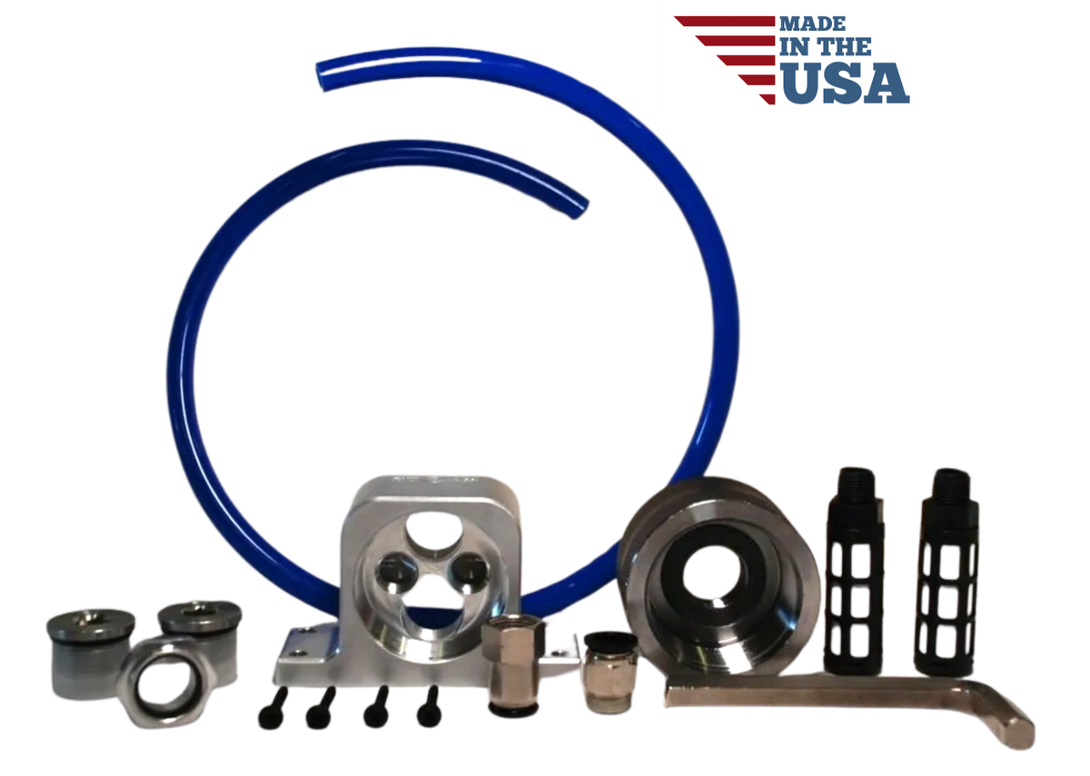

@curmudgeon - This guy has an interesting product line. Compressed Air Piping Systems - Ez Air USA I bought the starter kit and a 2” x 3’ piece of black pipe. I’ve only used it for a week or so, but it has taken all the moisture that used to collect in my moisture traps out of my lines. I was previously getting water spitting through my needle scaler (high volume air) and that has completely stopped. As for how long it lasts - depends on your use . You can remove the beads and bake them to recharge and start over.
Phil
Hi Phil, looks pretty interesting. I’m not quite sure where the 2" pipe fits into the setup. Can you send a pic of your assembled package?
Thanks.
I’m not home right now to take a pic, but they send you the nicely machined top and bottom fittings, internal tubing and filter/strainer ends, and a bag of desiccant big enough to fill a 2” x 3’ pipe. You screw the end caps on the pipe and fill the whole assembly with aluminum something-or-other beads. You also get a small bag of color changing beads to put at the top. The top cap has a clear port so you can see if they need baked. Expensive, but well made and seems to work. You know what they say - the sweetness of a cheap price soon fades while the bitterness of poor quality lingers long after.

So that 36 inch pipe minus the half inch tubing that runs to the bottom means that it probably has an interior volume of 0.486 gallon or less.
It looks like a total cost for the basic kit w (3 lbs Activated Alumina + 4.5 oz Indicating Silica Gel.) minus whatever discount is Order Total$233.97
this includes the shipping in Idaho because the basic kit is below the free shipping threshold.
Plus I have to source and buy the 36 inches of 2 inch pipe and end cap.
Off the basic kit someone could adapt from the 3/8 NPT to half inch NPT which would be a decent minimum for a shop air supply
I’m not sure how much the coupon code’s worth off?
Well hopefully I don’t come off as a bit of a dick but it seems comparable ( yours is slightly more costly when you consider the extra materials you need to obtain) in cost to the desiccant dryer linked above
https://www.zoro.com/arrow-pneumatics-desiccant-dryer-1-gal-d12-04xxl/i/G2789479/
Which the arrow 1 gallon is shipped free with a gallon of desiccant, requires no sourcing of extra materials and has half inch NPT fittings so capable of considerably higher CFM. The other advantage would be that it has a sight glass so you can see whether it’s wet or not without opening the container.
What advantages does your system have over this example I’ve given?
