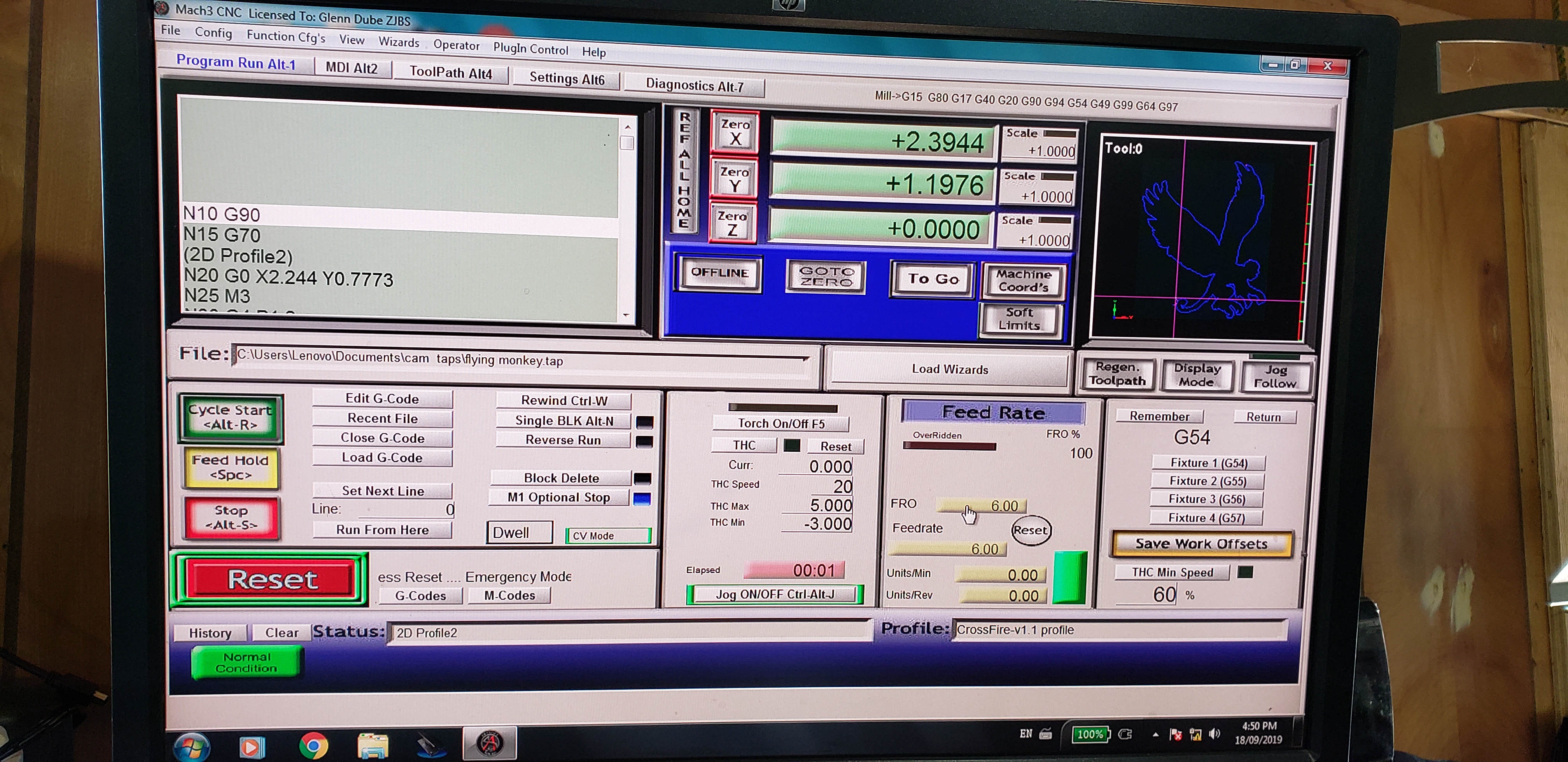

https://www.youtube.com/watch?v=rgL0YqIu5Fk&list=PLu8TULQV3Q0aiQinGTiC4utP46KEH3IjX&index=15 Fusion 360 Tutorial: CAM 5 - Post Processing helped me figure out my problem but I had the mach 3 fusion post in the wrong folder
flying monkey.dxf (354.7 KB)
all my other things work just fine. This file I tried to auto convert an image from Gimp. everything went smooth as butter…until it didn’t.

I ran that flying money file on my machine and it ran fine (didnt cut it though) and looked ok on the screen. Not sure what else to try
Weird…I don’t know…I mean you see the toolpath mine does
Whe you set up your tool did you miss a decimal? That circle looks like a tool. If your tool is somehow 25.4" (25.4 is the millimeters in 1 inch) in diameter it could look.like that
I’ll check when I get home
Where would I check that? Lol in the 2d profile?
I don’t think so…it actually travels in that circle. And if you look close it does a few laps. But at this point I’ll check anything. Must be a setting in my Mach3 don’t you think? Since it works on your end. I don’t even know where to begin
