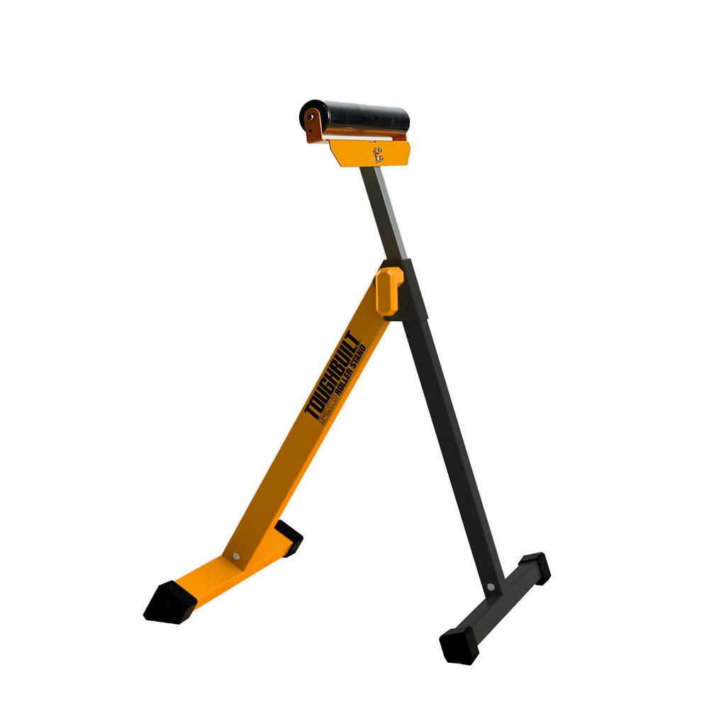

how would i go about doing this i have 12 4 x 8 sheets im cutting 24 parts out of each sheet i have positioned in cad how i want them on a sheet but i will have to move the sheet forward and around at some point so how to i have alignment marks im new to this but i have some experience with Mach 3 on a cnc 3040 but its not like i set a x0 y0 z0 on this machine how do most people touch off per say or set their corner to x0 y0 z0
im figuring i will have to have some saw horses at the same height as the table so i cut level any help is greatly appreciated i have looked on youtube to see if anyone else has tried doing such a thing
You’ll need a couple of the roller guides supports used for table saws & such. Like this:
Those will support the sheet where it extends past the table.
