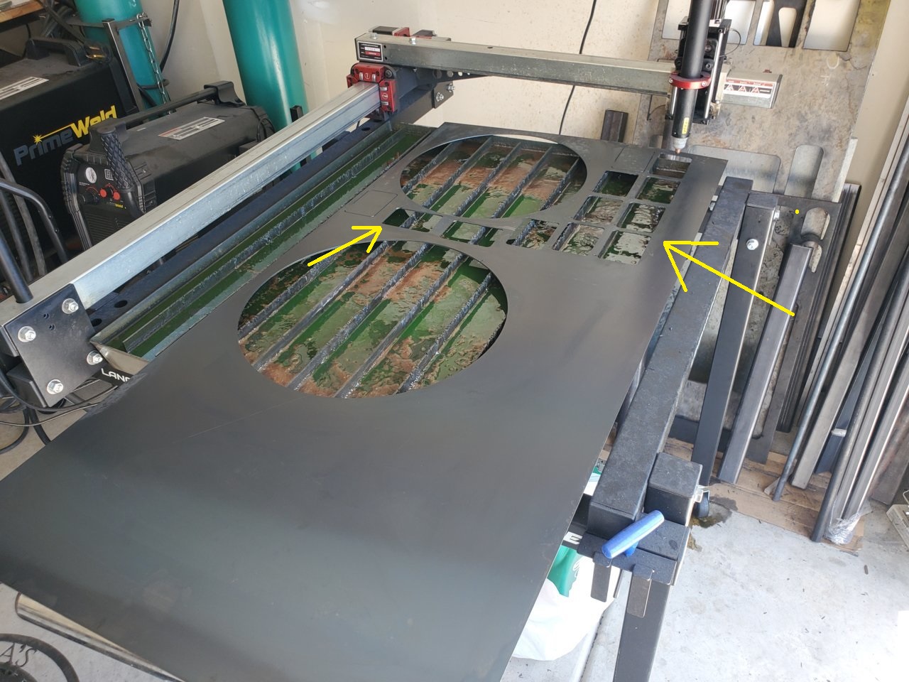

Crossfire XL with PrimeWeld CUT60 and PTM-60
Whenever I start a paid project, I use a new electrode and tip. I use previously successfully used settings. I also fully jog my machine at the start of the day and do my zero.
16 gauge cold rolled, 0.8mm tip, 100ipm, 55psi, 30 amp, 0.8 second pierce delay. Work clamp always on the work piece being cut. Arbor plates always used to ensure steel remains flat.
Jagged edges occurred immediately when I started cutting. Since it started right away, this would indicate that there is no issue with new consumables nor air as the tank is full. Also would remove the thought of moisture being an issue.
Unscrewed the shield cup, and everything was tight, proceed with cutting.
Jaggedness occurred throughout but was not consistent in any one particular area either.
Red arrows point at the jagged edges, and green to the smooth edges.
Here is how I’m set up in case anyone is questioning the layout.
Did my own trouble shooting which included -
  1. Checking tolerance on my Z axis (does not move a single bit, tight)
  2. Checked couplers on X and Y axis; there was never any binding nor slipping before cutting and after cutting. Tightened two total but still same issues as you read below
  3. Cut 12 test pieces each with one variable changed to narrow down my possible issue (as pointed out by the yellow arrow showing each piece cut).
Keep in mind, this test cut piece is from a previously successful cut meaning the drawing of the sign is not the issue.
  1. New 0.8mm tip, same jagged edge
  2. New electrode, same jagged edge
  3. Move regulator on machine up and down to ensure proper psi, same jagged edge
  4. Flipped swirl ring, slightly worse jagged edge meaning it was right to begin with
  5. Switched to a new 1.1mm tip, slightly less jagged edge but possibly because of a larger kerf it just burns it off?
  6. Drastically increased cut speed with the 0.8mm new tip, jagged edge but slightly elongated
  7. Drastically decreased cut speed with the 0.8mm new tip, jagged edge but same as before
  8. Replaced the cup shield and swirl ring with new parts and back to a 1.1mm tip, so now everything is brand new, produced best results but had that elongated jagged edge now
  9. Beads in my dessicant filter still blue as they were replaced yesterday, and electrode removed earlier had no swirl marks indicating no moisture; remember, the jagged cut started at the beginning of my first cut

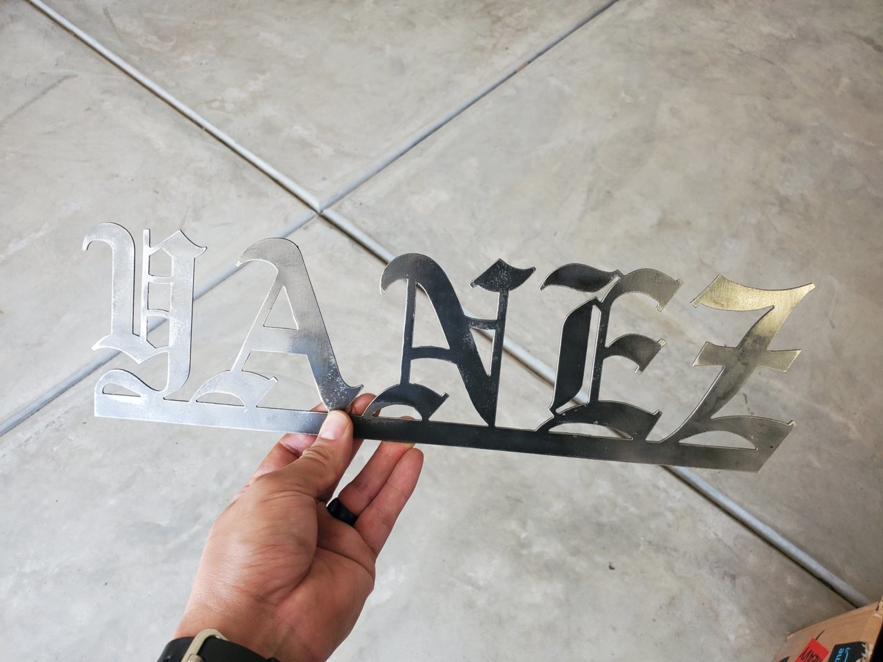

So, I was able to get the sign cut with new cup shield and larger tip but still had the tiniest bit of jaggedness on a letter or two.
Proceed to cut some 1/4" some 15 minutes later.
My thoughts confirmed that due to the lack of beveling, everything is straight as it needs to be. Not to mention square due to proper and circular holes.

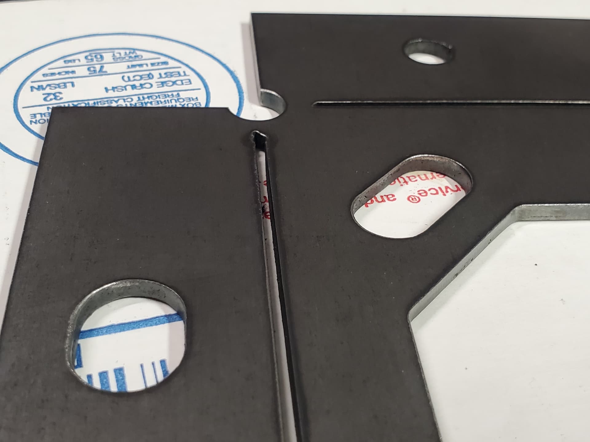

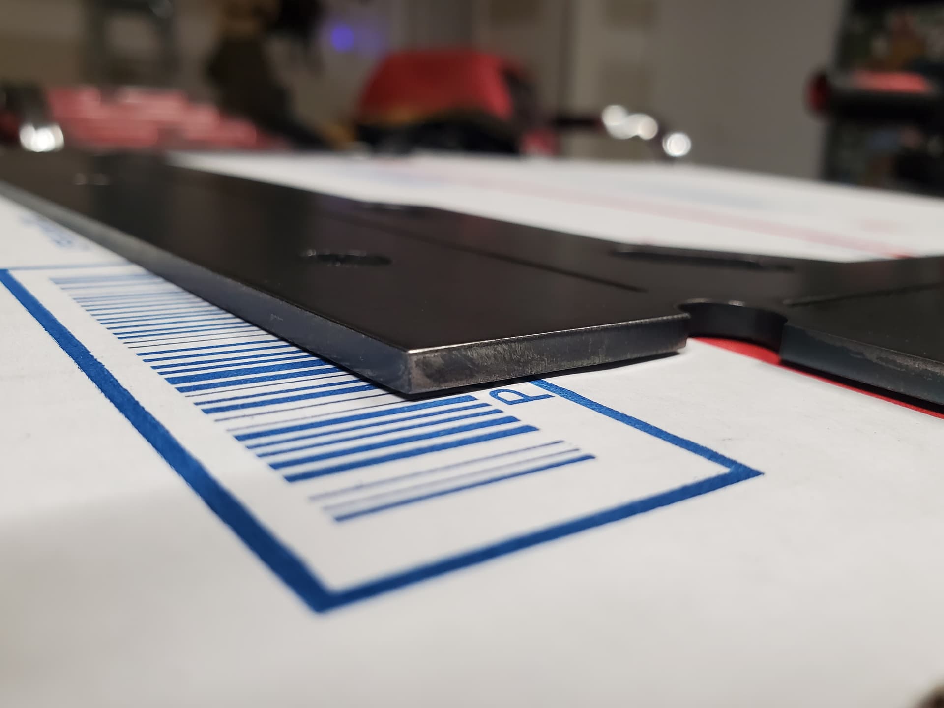

Out of these 8 brackets, my 7th bracket hole cut slightly jagged (circled in red again) and the 8th larger bracket as well but slightly less of a jagged edge.

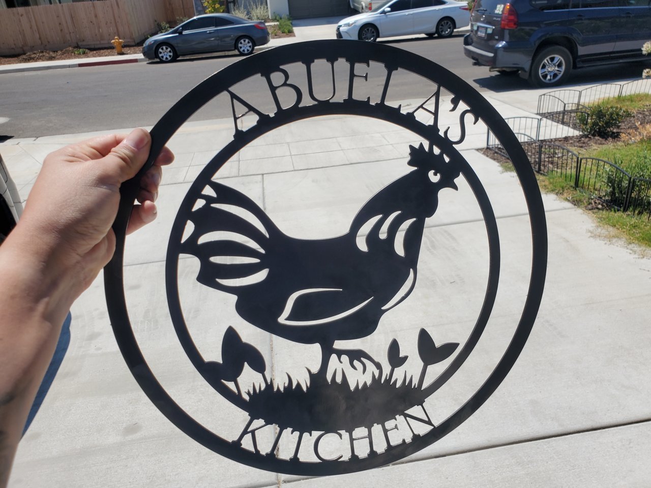

Now here’s the kicker; I cut a sign yesterday out of the same steel, with a slightly used tip and electrode, using the same exact settings as above and had successful results as shown below which proves my combination posted already works.

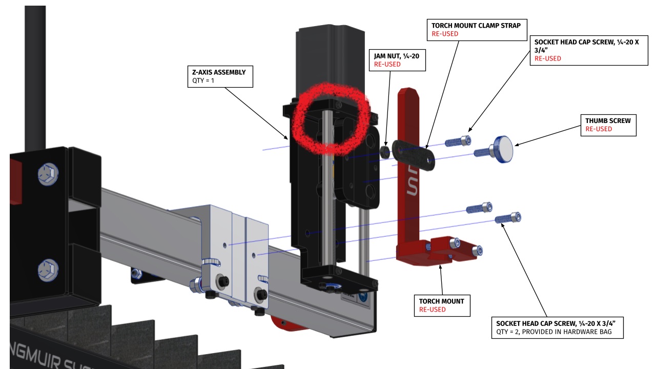

How about the coupler on the Z axis? Up in behind the torch, at the top.
That’s on the list to check this Sunday as well!
As part of my jog dialing I also run my Z and noticed nothing but I’ll see if I can mark it and check for any slipping.
Messing with the Z axis coupler is a sore subject for me considering the screw heads stripped when I first assembled and tightened everything cause oddly Langmuir doesn’t tighten them from the factory.

But really I need to focus on the one thing I noticed; the cutting sounded as if it were fluttering when it created the jagged cuts.
That tells me something is going on within the torch as far as air flowing; I’m hoping it’s as someone said and maybe debris got stuck inside there or something (before the consumable side) and I can blow it out later with everything removed.

Jagged cuts are from:
  • loose couplers
  • dry / improper lubricated drive screws and nuts
  • dirty rails
  • worn or upside down swirl ring
  • debris or compressor line issues

check your torch height control settings in the fire control and reset to defaults if you are unsure. if it is set too high it can saw. the z movement is a percentage of the cut speed so if that’s off speeding it up will make it worse.
also make sure thc is turned off on small details. if it’s on with. details it can cause issues as well.
21.1.5 has been out for quite some time and there are many issues with it, but none of them are related to jagged cuts. My laptop shows that I installed 21.1.5 in March of 2022, although I still use 20.6.2 to run my table. The air fluttering indicates an issue with the internals of the torch.
The only other thing I can think of, would be the rollers that ride on the Z axis rods being loose. If those are not properly adjusted, there is play in the Z carriage that can allow the torch to wobble. You can easily check for that by trying to wiggle the torch around.

As for the Z axis, someone had mentioned checking the bearings as well as the coupler and those were done so as part of the process. Thanks for mentioning it though!

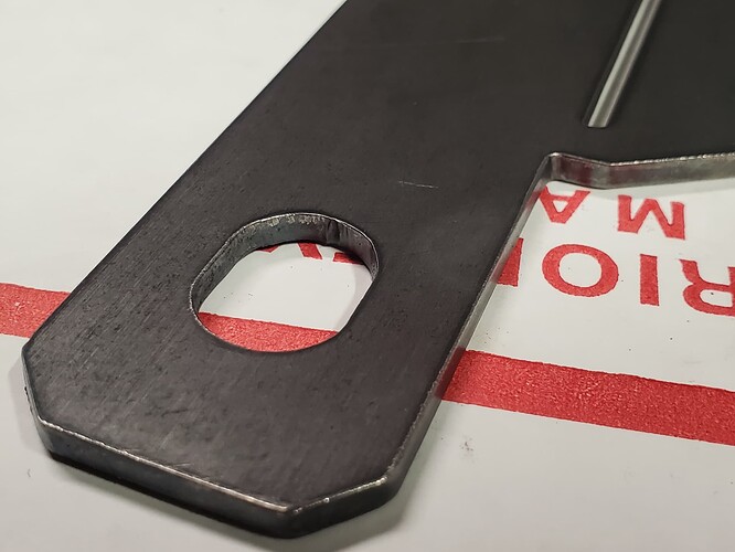

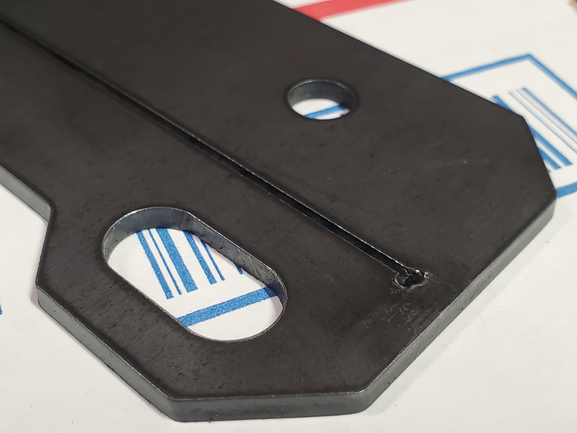

Here are those parts - 3 sets of bed stiffeners for a total of 6 brackets, consisting of a total of 36 holes, 30 oval shaped slots, and 12 relief cuts.
I must emphasize thatno changes were made prior to these cuts in any way with the exception of my heat setting due to the material thickness
All the parts
You can see the many holes cut
And now many close up pictures
And finally, the one that experienced a jagged cut
The jagged cut did not occur on the first piece, or the last piece, not to mention it did not start as the first cut or last cut.
Also because I have a small table (Crossfire XL), I have to lift up and move my 4’ x 4’ plate as my cutting area is limited. When I noticed the jagged cut, I cut another 2 bed stiffeners in the same area of the table and experienced no jaggedness at all meaning I cannot replicate it on demand.
