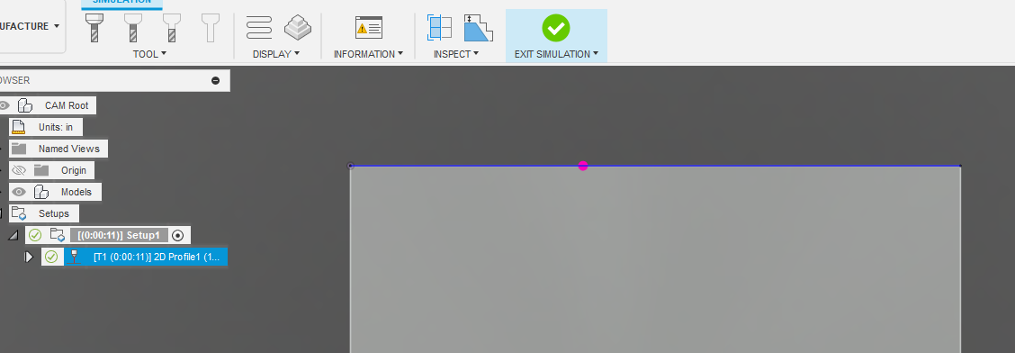

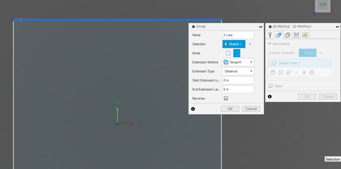

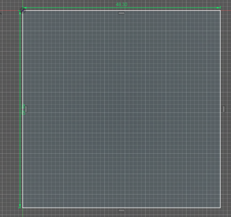

I am not familiar with Mach 3 but you could make a G-code file that is for a full cut and run the file. Here I made a square that is 48.3 inches x 48.3 inches (you should measure your available travel and have it within your table specs, otherwise you will collide with the limits of the table).
I then went to “Manufacturing” and picked the contour but selected only the one side:

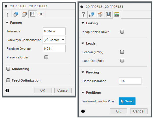

I set the parameters to No lead in/No lead out and centerline offset so it will cut on the line.

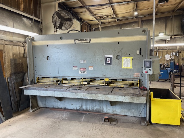

I cheat! We have a shear at work that can handle up to 1/2” plate x 10’ wide.
Are they hiring?
We are always looking to hire good people😀
