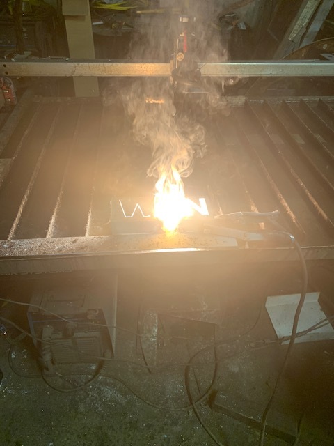

Magnesium Real danger. I was somewhat aware of the danger of cutting aluminum and more so cutting magnesium. But today I had a first hand look at the serious safety concerns. I acquired some 3 1/2" x 2" x 10’ long old concrete strike offs. Well I wanted to cut a name in it for my shop and put a light inside of the tube to highlight my name. It started nice and then got quickly out of hand. I videoed what started happening then had to stop to try and get this under control. It could have been really bad if I let it go much longer. DO NOT TRY SPRAYING WATER ON IT. I threw a large heavy tarp over it then soaked the tarp while covered. This all being said it there a safe way to cut this tube?
WOW. That is intense. :astonished:
Magnesium ignites at 883 degrees fahrenheit and a carbon dioxide extinguisher will feed the fire. There is no safe way to cut magnesium with fire.
I must be missing something. Who would try to cut magnesium with a plasma cutter? It’s essential to identify the material you are cutting. That picture could have been a lot worse. Quick thinking saved that table and probably the shop. Putting water on it makes hydrogen gas. Plus it burns at 4000 + degrees.
Bigdaddy you are not missing anything except me being a Dumb Ass, I first thought it was aluminum. Lesson learned I thought I was getting some free material to work with. Yes I was lucky. I agree I should have made sure what the material was before I cut. That is one of the reasons I shared my experience with this close call. Being a hobbyist like a lot of us are on this site I figured sharing my misfortune could save someone else from a worse fate. Free is NOT always good.
I have a buddy, believe it or not, who’s a fireman. He told me that car fires with magnesium wheels are so hot that they can’t even get close. They just watch.
I was a firefighter, we had a foam cartridge nozzle and class D cartridges for metal. Not too many magnesium wheels now days, but some of the transfer case shells are.
