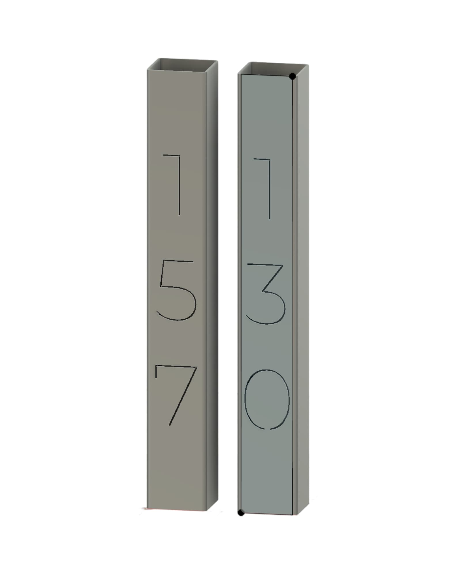

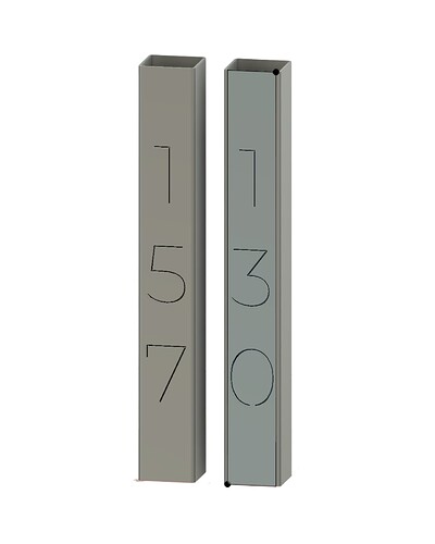

You need to tell us how you are going to cut it. Are you cutting slots in it, cutting holes in it, cutting ovals, cutting it in half long ways, or may be in 6" pieces.

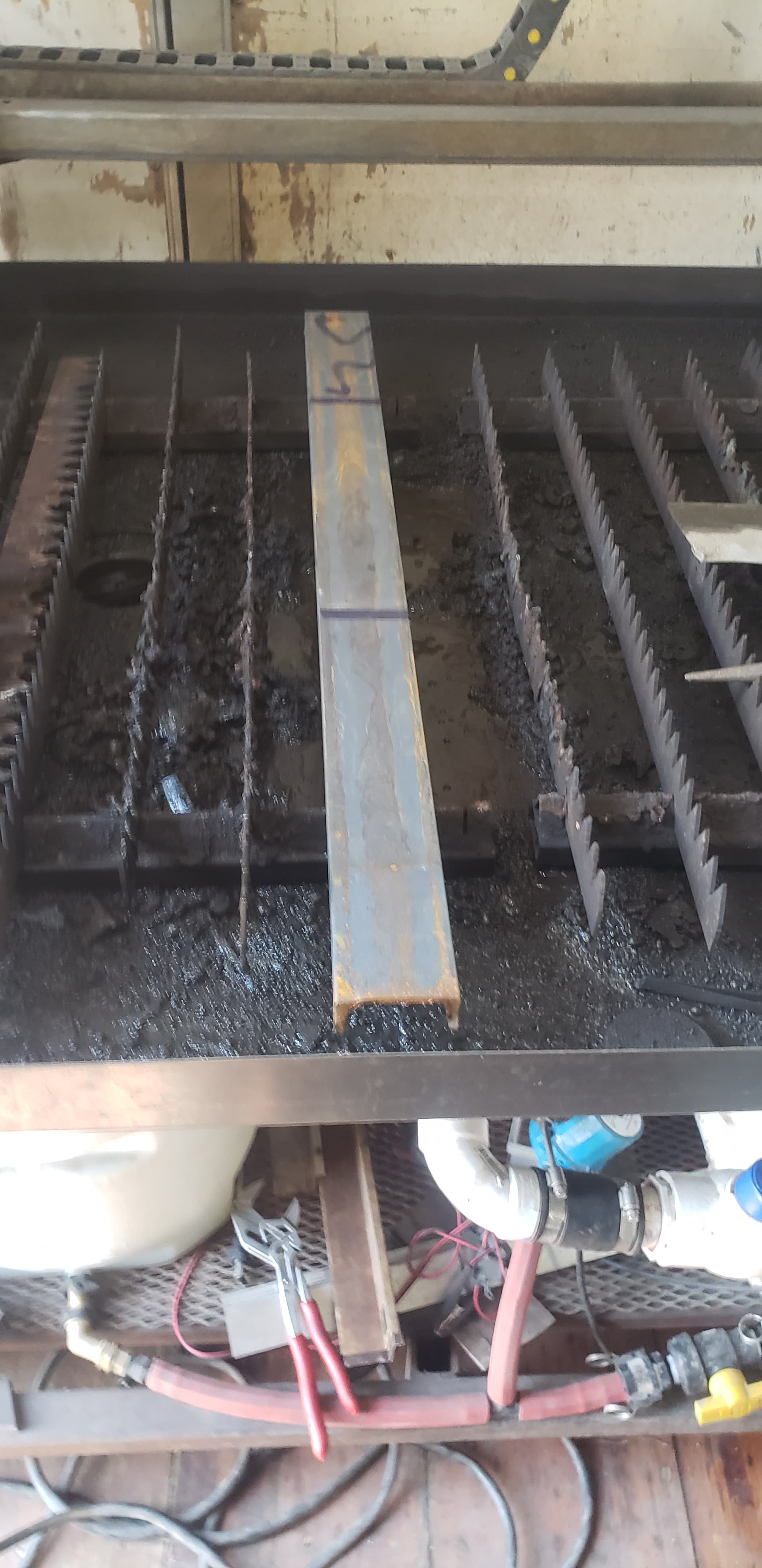

they’re 29 in long that’ll be numbered as shown in the photo I just added

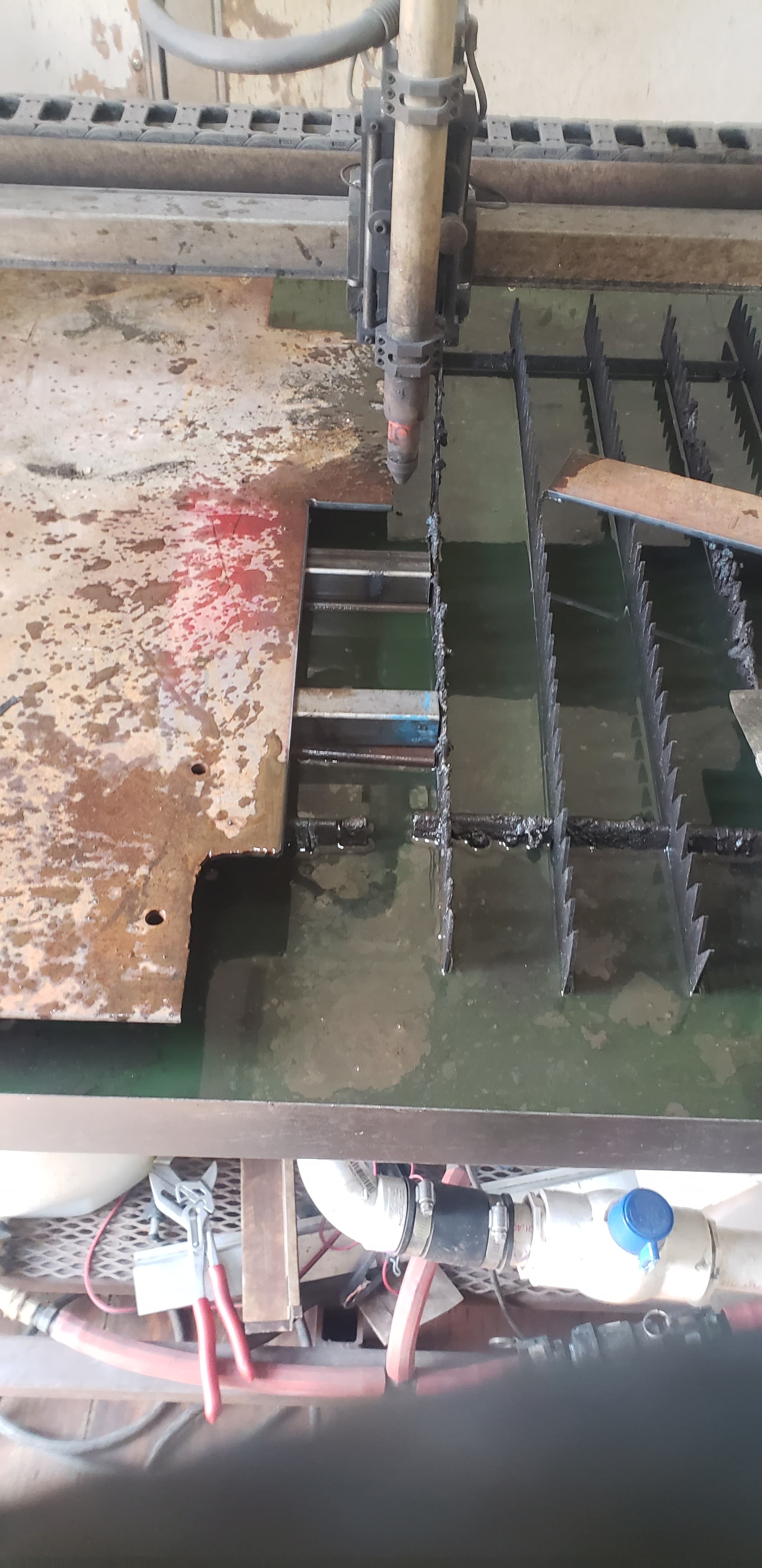

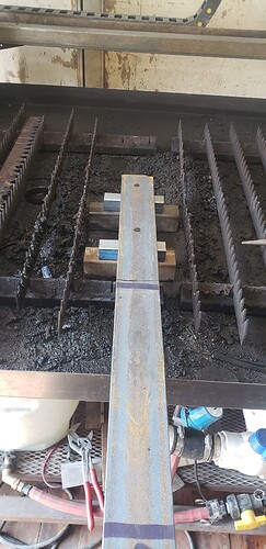

I would arrange the slats to fit the box tubing, then lay a piece of plate over the top. Cut out a 90* that the box tubing can locate in, then using the same origin point, cut your tubing.
Worked for me in the past,gonna work again in the near future cutting C-channel for steak pockets.

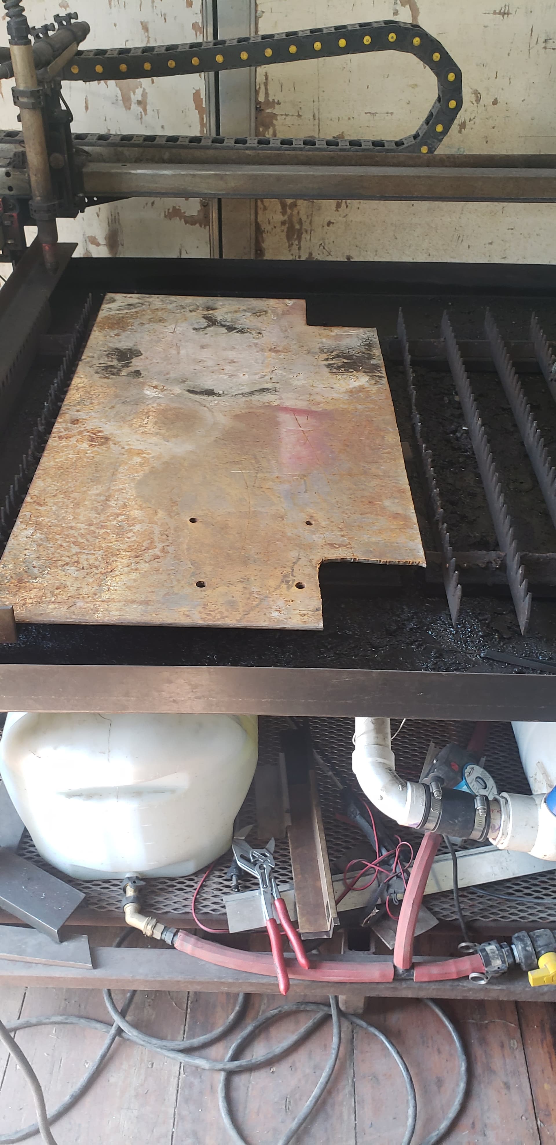

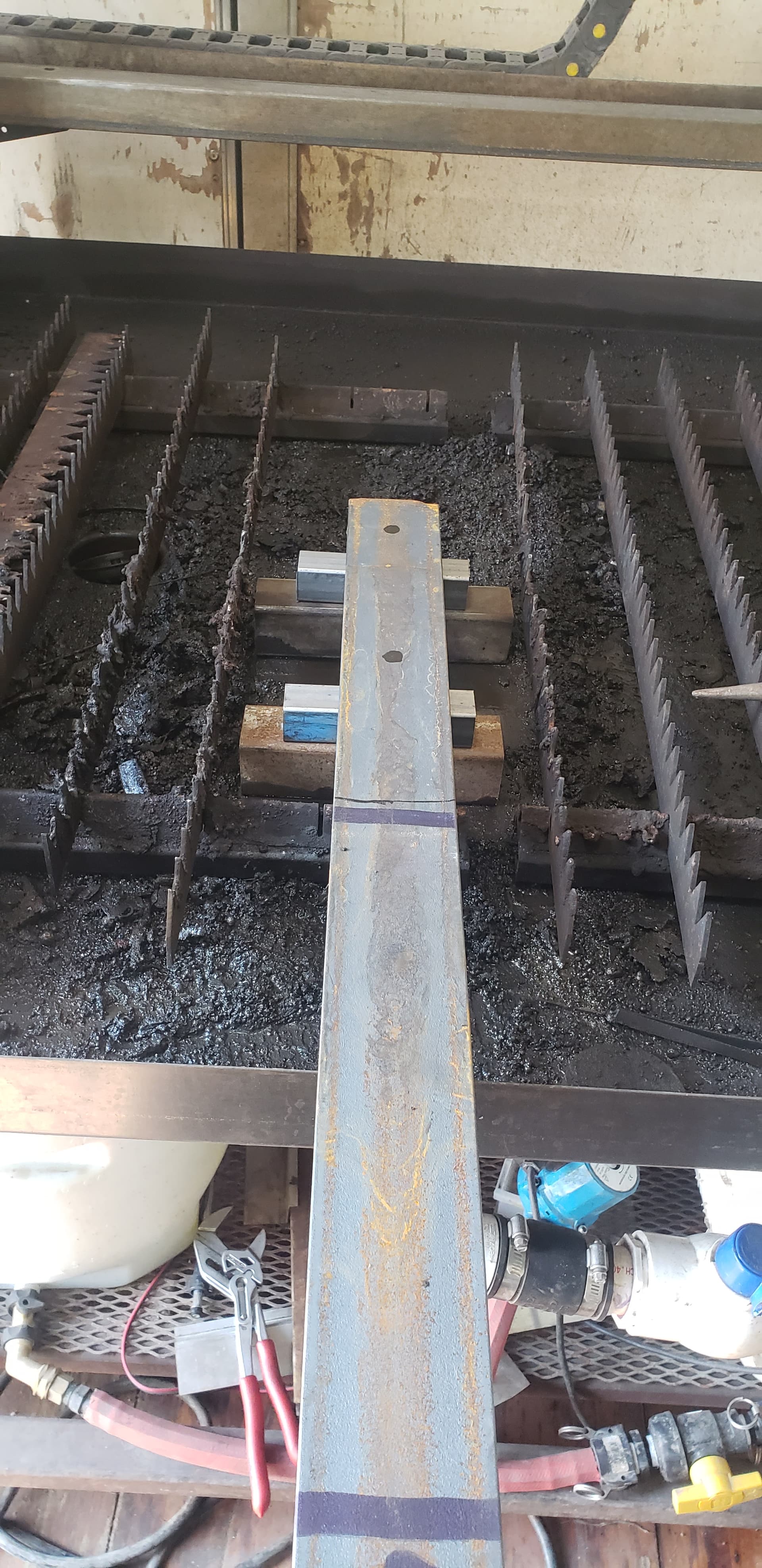

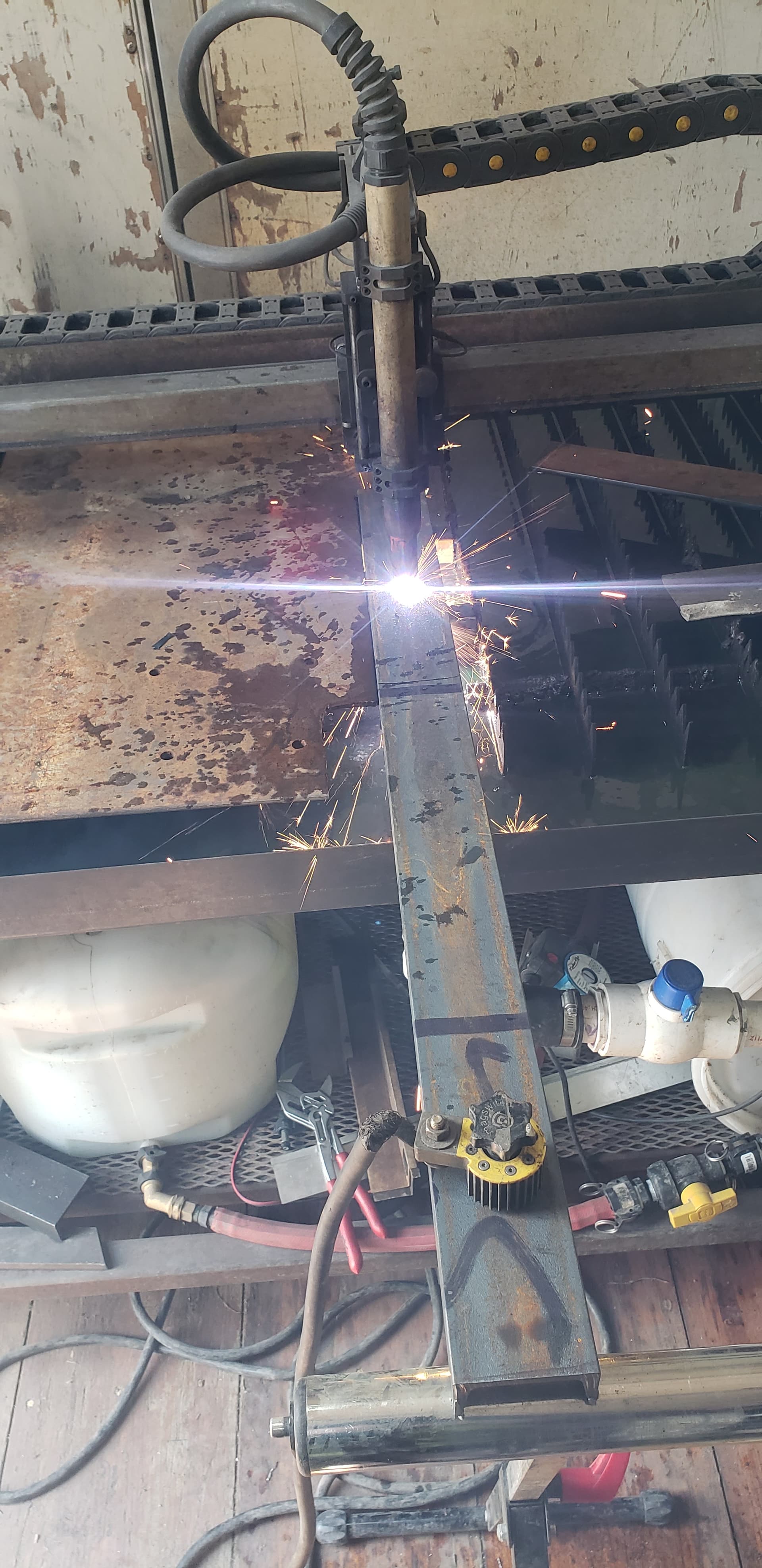

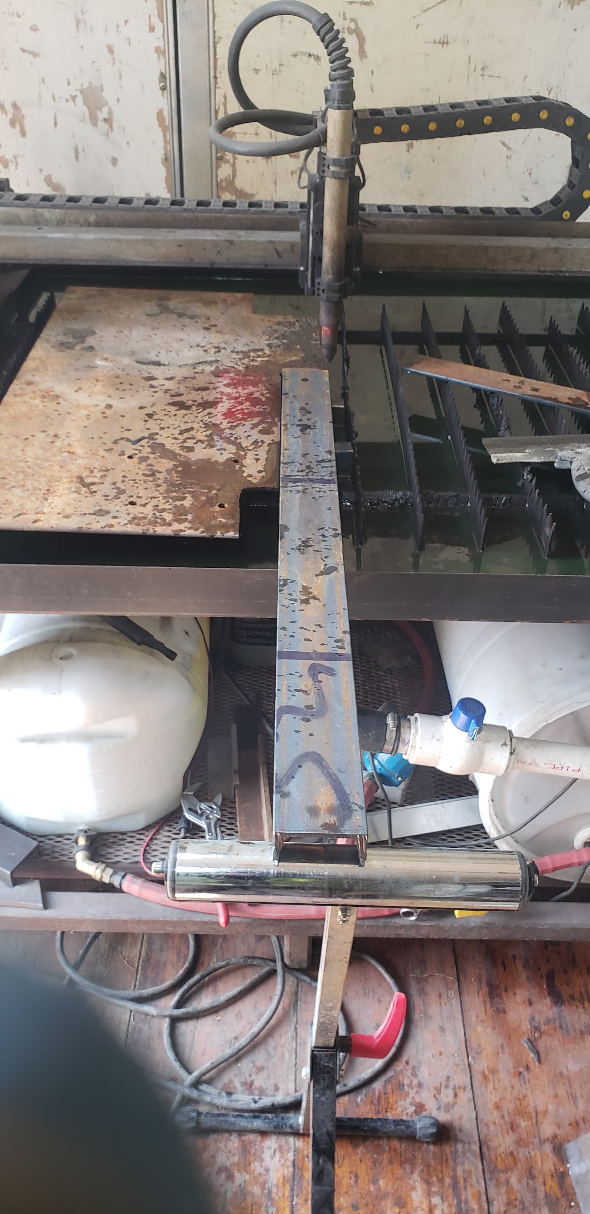

I realize that you have probably finished this project, but I wanted to show what I was talking about.
Select space for item to cut.
Arrange spacers
Donor plate for locating reference.
Test Fit

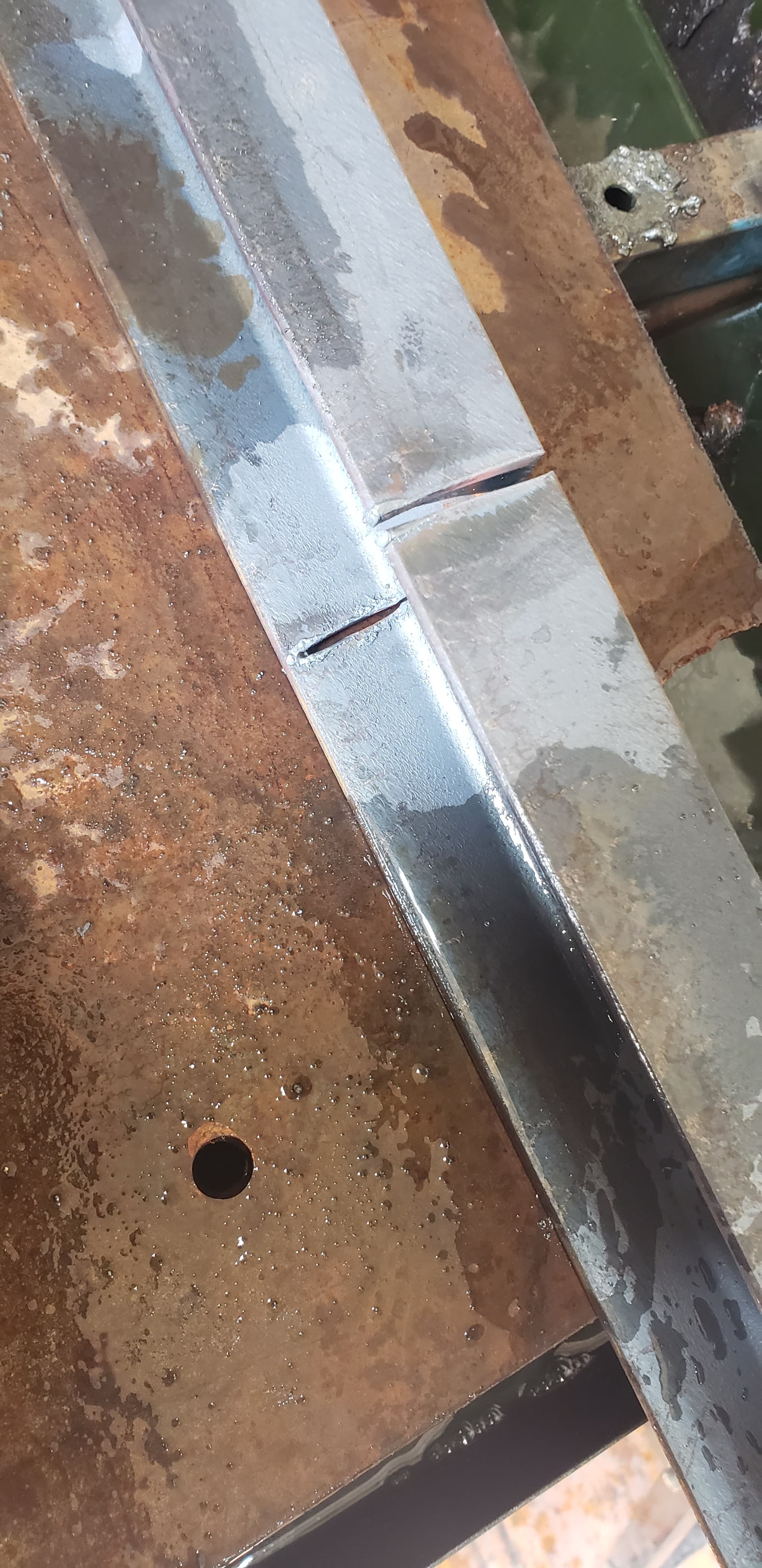

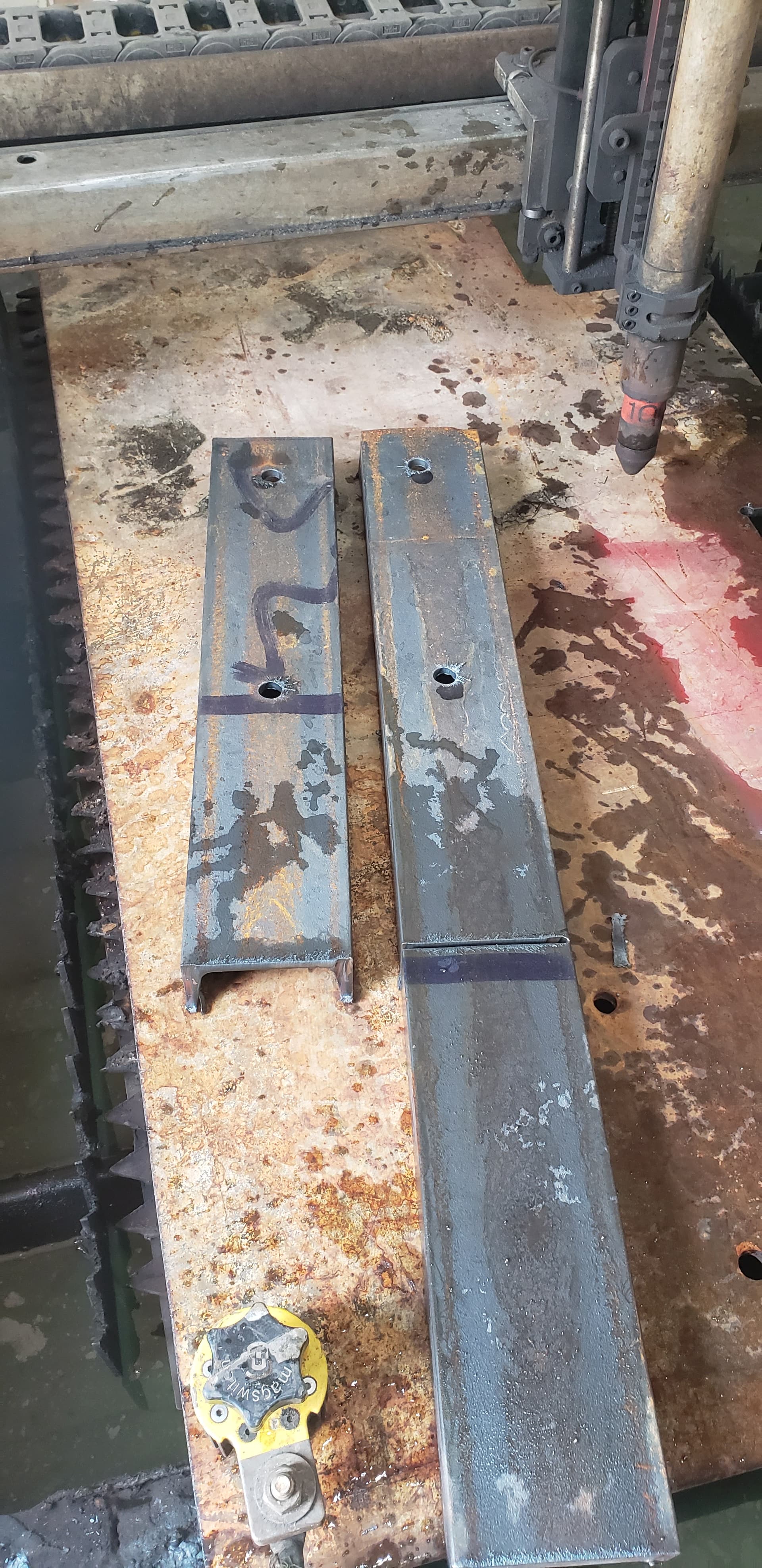

Cut
Rinse and repeat.
For my application, I am cutting steak pocket uprights, that will bolt 2x12 to the steak, I set a cut for 2.5" of the 3" channel, center line, 0 offset, 0* lead in and out, with a .29" 7 ipm lead in/out feed rate to burn through the 1.25 web, and a 78 ipm cross cut.
I need 42 of them.
