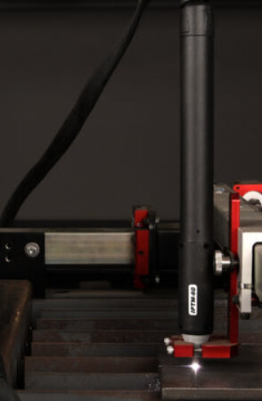

Where is the torch holder clamped onto your torch? Could you torch be mounted in such a way that it’s interfering with the internal moving components of the torch.

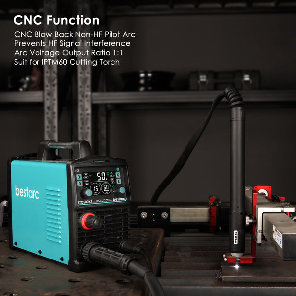

Interesting in the promo material for the plasma cutter you bought shows it being used with one of the crossfire clones.

I noticed that it is not on the compatibility list for langmuir systems. I know that it’s a non-high frequency start but it also hasn’t had a blessing from Langmuir.

I know it is off the current problem/subject, but what a terrible example of mounting a machine torch (in their ad):
I have the same setup minus the machine torch and had a same? problem (1st cut perfect, 2nd cut seemed to start but then the arc stopped while piercing the next hole) Make sure the trigger on your bestarc is set on 2T (vs 4T). That solved it for me. Hope this helps.

That was the first thing that I noticed as well.
